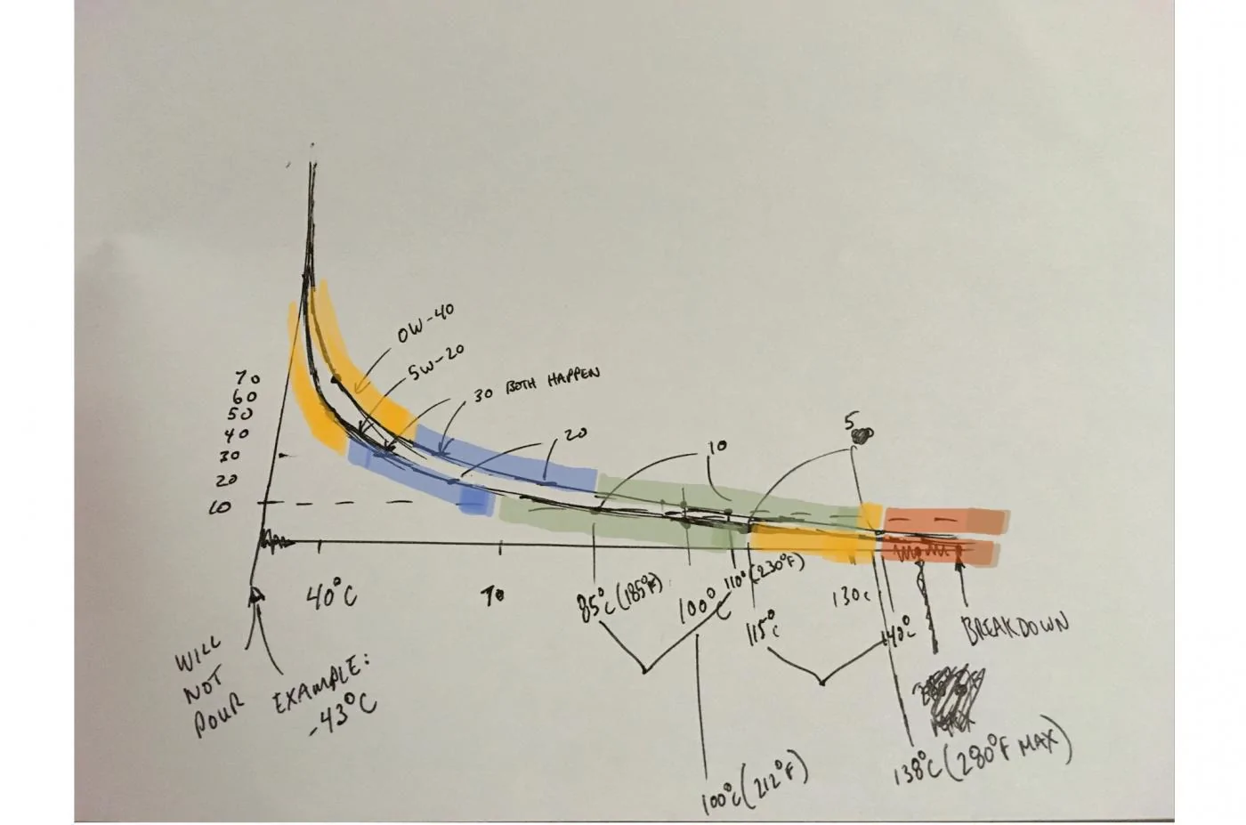

Not sure where the curves come from, but it's interesting that 0w40 is more viscous than 5w20 for the whole range.
Yes.
Data points provided by manufacture.
0w-40 @40*c = 70.8; 100*c = 12.9
5w-20 @40*c = 49.8; 100*c = 8.9
Curve is a basic kinematic viscosity parabolic of multi-grade oils measured in "cSt" or centistokes. As with anything on the internet, take it with a grain of salt.
