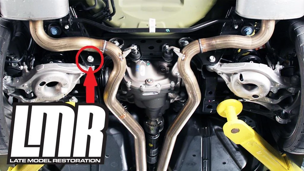

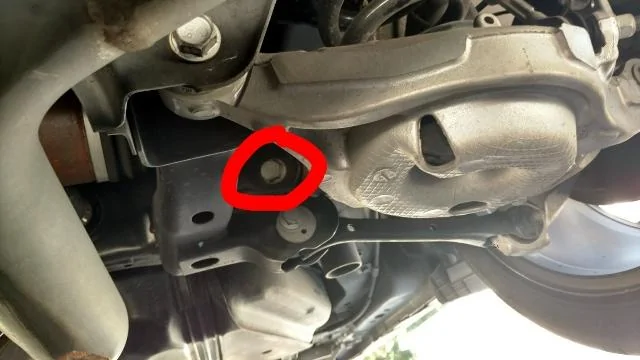

My rear end passenger side suspension has developed a creak when moving forward from a stop.
I've dealt with a similar issue to a greater degree on the driver side rear at one point however i was able to fix it.
When it was my driver side the issue was taht this bolt circled appeared to be loose and tightening it solved the problem
My assumption is that the passenger side is having a similar issue since the noise is similar, however i was unable to tighten the bolt.
Any ideas would be greatly appreciated.
Thanks,
Brant

Thanks for the suggestions guys! So the passenger side bolt that I thought was initially the issue, could not be tightened. So I looked around and thought I'd check it's sister bolt. Turns out it was fairly loose and could be tightened quite a bit. I won't know for sure if it fixed it as my car is still up on on jackstands but as soon as it's down I'm gonna check it out. Fingers crossed lol

Whelp that did the trick guys! now my car is much more enjoyable to drive. The binding noise i was hearing was unbearable and am happy to say it no longer exists!

Just depends which side the noise is coming from, a year ago it was my driver side and tightening the one bolt circled in the lmr picture fixed it. This time when the nose was coming from the passenger side, I first attempted to tighten the same bolt as the first time (but the one in the passenger side) and it was already fully tightened. That's when I decided to try tighten the other bolt, which as turns out was loose. It fixed the problem though. You'll need either a 24mm socket (what I used) or an SAE socket in a similar size. A short extension might help as well when reaching the bolt I tightened on the passenger side as well as either a breaker bar or longer torque wrench so it's easier to apply torque to the turn the bolt.

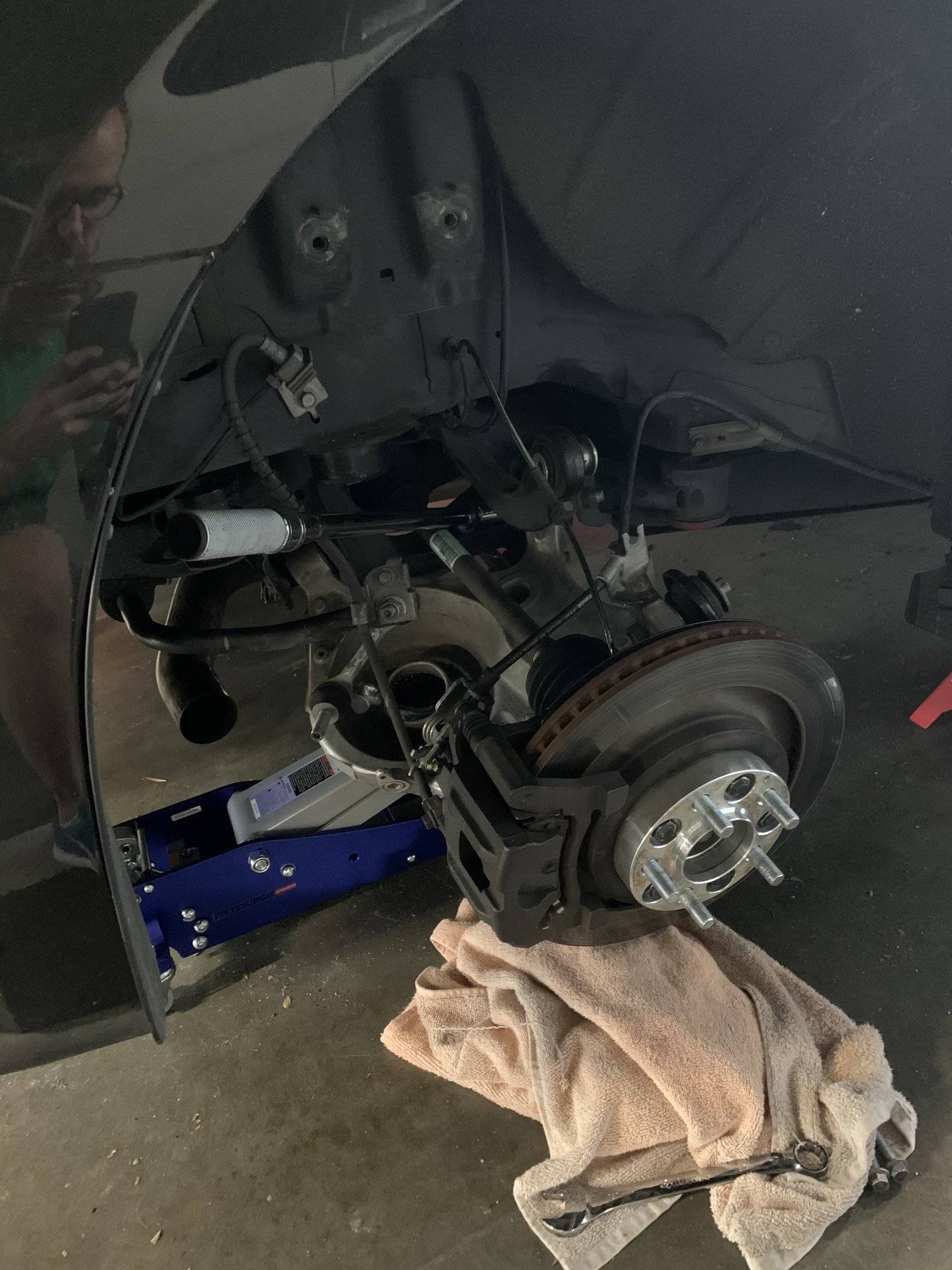

Bumping this because I had the same problem as Brant and the process for accessing the forward 24mm bolt for the sole purpose of checking the torque is not terribly well documented and I believe it is frequently omitted when checking the torque of the rear suspension parts. When people say “I’ve checked all of the bolts and they are all tight but I still am getting a clunk”, I doubt it.
I recommend doing this one side at a time to make reassembly easier, as you will need to drop the subframe. Removing the muffler and twisting the mid pipe section out of the way helps with access to the rear 24 mm bolt, but it’s not required if you have the right tools. Anyway, jack the car up and support the weight on the pinch welds or the frame rail. Remove the rear wheel and unbolt the camber arm where it meets the spindle. Remove the shock and unbolt the sway bar link where it meets the spindle. Support the underside of the RLCA with a jack, then unbolt the front and rear subframe bolts. Slowly lower the jack and pull the spring out. This will give you just enough room to get a long breaker bar or ratchet (or torque wrench) with a shallow 24mm socket in there. I strongly recommend something that ratchets because you don’t have much room to work with. Once you confirm it’s tight, reassemble in reverse order, taking extra care with lining up the upper shock bolts. If you drop both sides at the same time, you will need to futz around with the subframe bolt alignment. Take your time and don’t cross thread anything!
