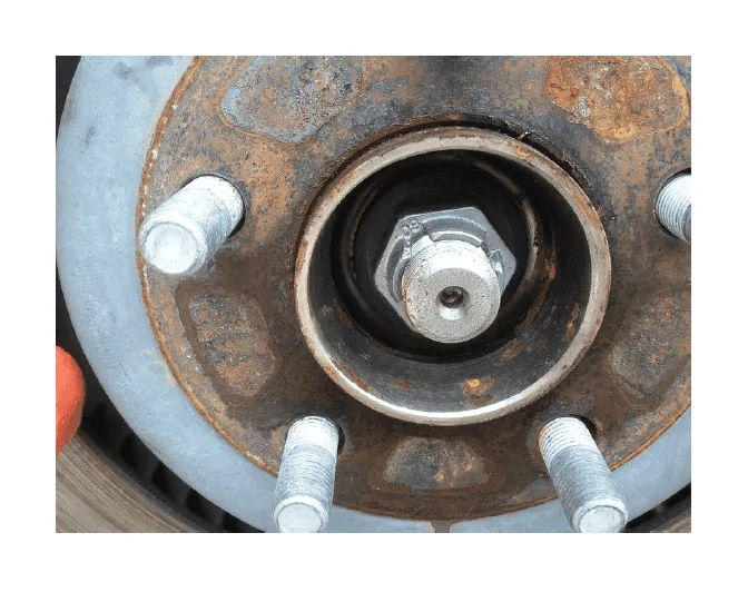

I over torqued it. Just by hand, 150 lb/ft + ~1/8 turn more .. It gets loose by itself over time. People also put a little blue loctite just incase.
For anyone who'd like to know what to tighten
32mm socket
