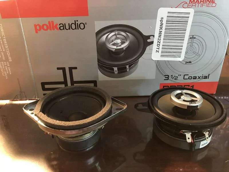

So I replaced my center speaker with a Polk db351. Had to modify the grill a bit but I am very happy with the speaker. Thanks to @Chef_jpd for the referral.
Odd thing is that my bass coming from the doors seems better. Is that just because the noise is cleaned up, or is it because somehow that speaker isn't using the low signal(used the bass blocker) and there is more for the doors?
Sorry if its a noob question! lol

Could have been an impedance change.

This won’t really address the lack of bass, but it will certainly clean up your front sound stage and allow the bass you do have to shine through. They come with a bass blocker and it’s wired in line.
Yes they come in pairs, but as you can see there is a market for them. ^^^^^
Ultimately to address my bass needs I replaced my sub in the trunk with Polk unit. It’s an improvement, but at some point I am going to run a dedicated amp to it as well.

Just found this thread, is the center speaker easy to remove? I did not know about a "Center" front speaker, this is news. I want a speaker too. $
Yes you remove the long metal piece with your vents in it and then the grill pops right off.
*On non PP cars the Polk unit will require the grill to be ground a little because of clearance on the tweeter.

I stuffed my stock sub with a whole bag of poly fill. Made a difference and was worth it.

Did you buy a speaker harness or was it plug and play?

The model number is DB351.
The factory speaker has a connector that is soldered on, remove it and solder to new speaker.
