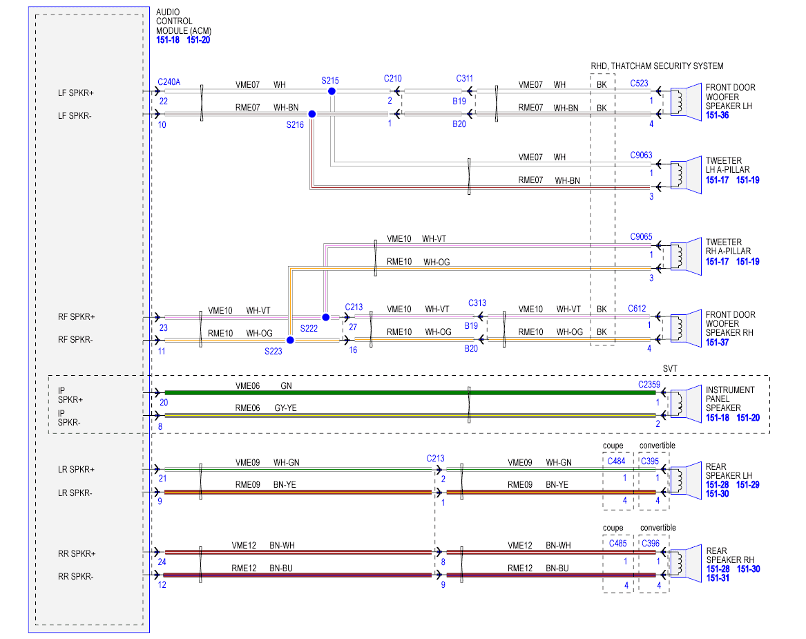

So I have the 6 speaker system, do they not count the center speaker? That would make 7

It may not actually have a speaker there.
pretty sure there’s 6 speakers, 3 on left and right. Put head over the speaker see if it plays?.

Ok thanks it just sounds like there is sound coming out of the area.

Above advice is good,
I haven't checked on my base system yet but the way I read this is that the speaker is not there on the base Mustang unless its a SVT. I really didn't see anything in Forscan about turning this speaker output on or off in the ACM but since many premium owners have removed the center channel and saw an improvement, I wouldn't see a need to add it in unless you could direct all chimes and mobile calls to it once moving the other speakers to an aftermarket amp.

Forscan doesn’t even remove the center channel, it’s simply disconnecting it either at the speaker or snipping wire or popping pin out of the connector @ the amp.
I snipped mine with a finger nail clipper lol. It was green

Lol, I wasn't suggesting you had to use Forscan to remove the center channel, OP didn't ask how to remove, even though Forscan has a setting to set the rear amp as "not used". I was merely conveying what was in Forscan or more to the point wasn't since the IP speaker shows up in the drawing for the base model, it must show up for reason but why isn't exactly clear since I didn't see anything in Forscan of value, turning it off, rerouting the chimes, etc.
