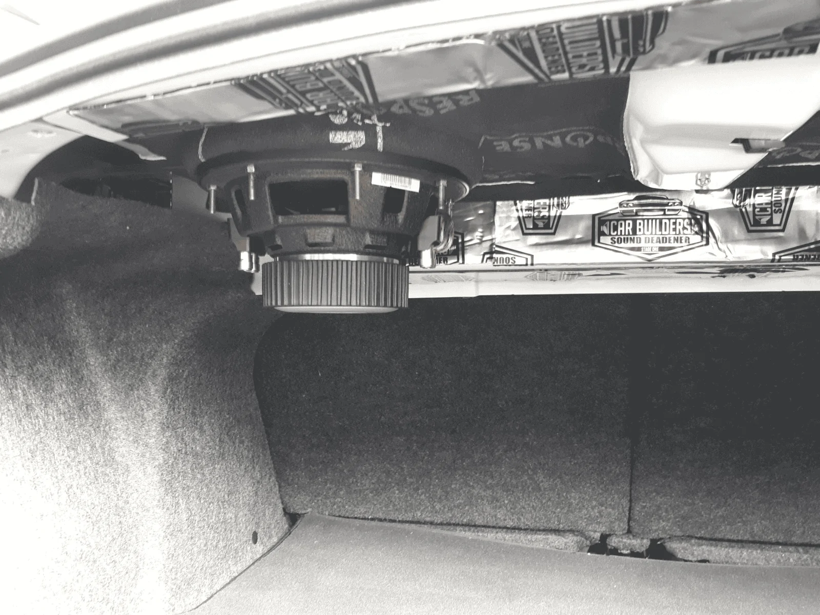

See post #3 for the subwoofer I used it might be too big for your requirement but I'm just throwing it out there as an idea. I can remove mine from the car in 2 minutes. It's tight and punchy despite it being ported enclosure. I have it EQ'd and time aligned using a DSP. The group delay of a ported enclosure can be compensated for by equally delaying all other speakers in the car. I removed the rear speakers altogether. They ruin the front sound stage otherwise. I utilized the rear deck holes to allow the bass to come through.

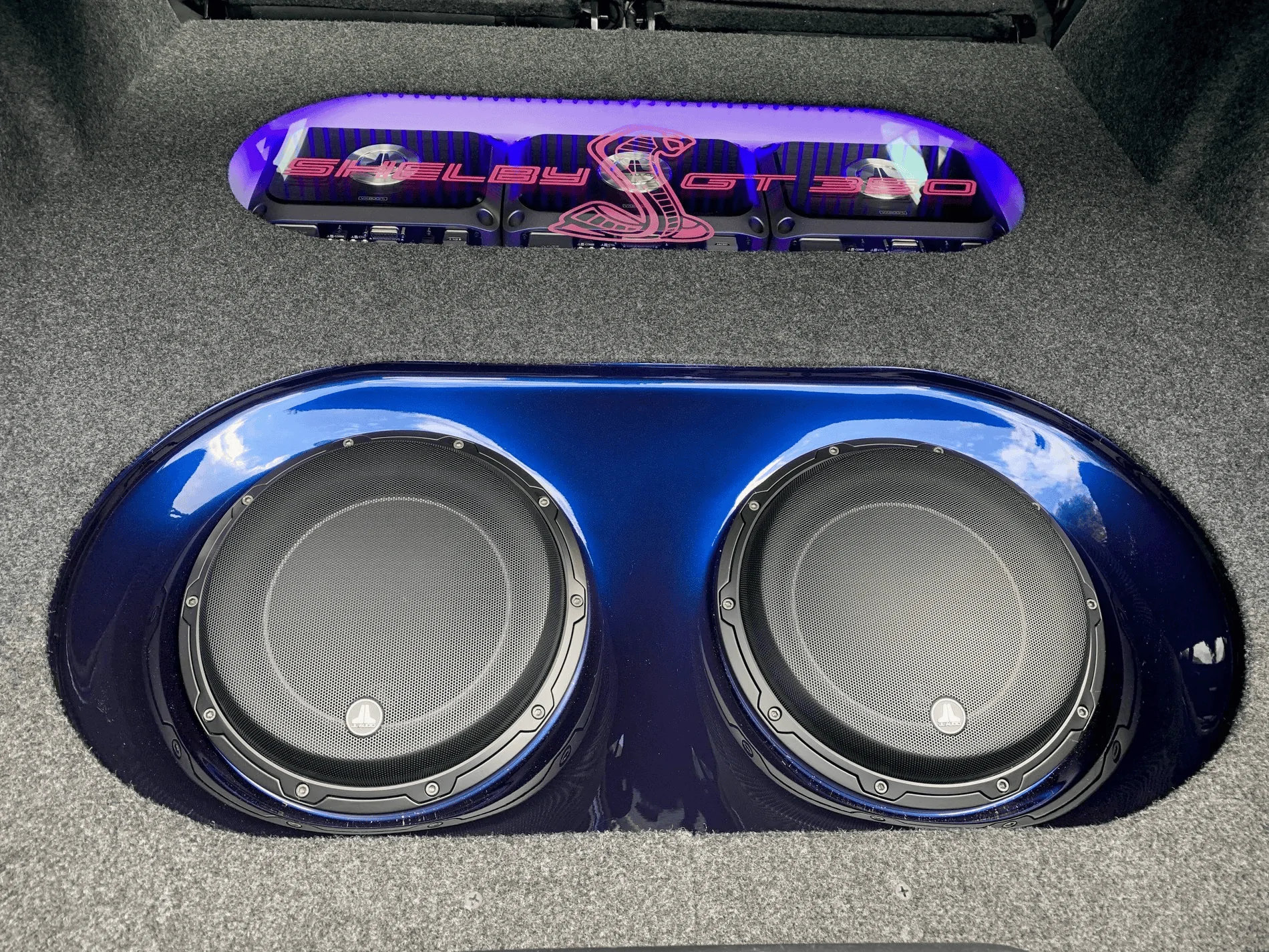

Here’s my setup and it plays rock very well. If you’re concerned about trunk space I’d recommend a set of JL 12TW3. They are thin line and require little air space but they hit hard and are very accurate. You could even go with 10s and have enough for rock music.

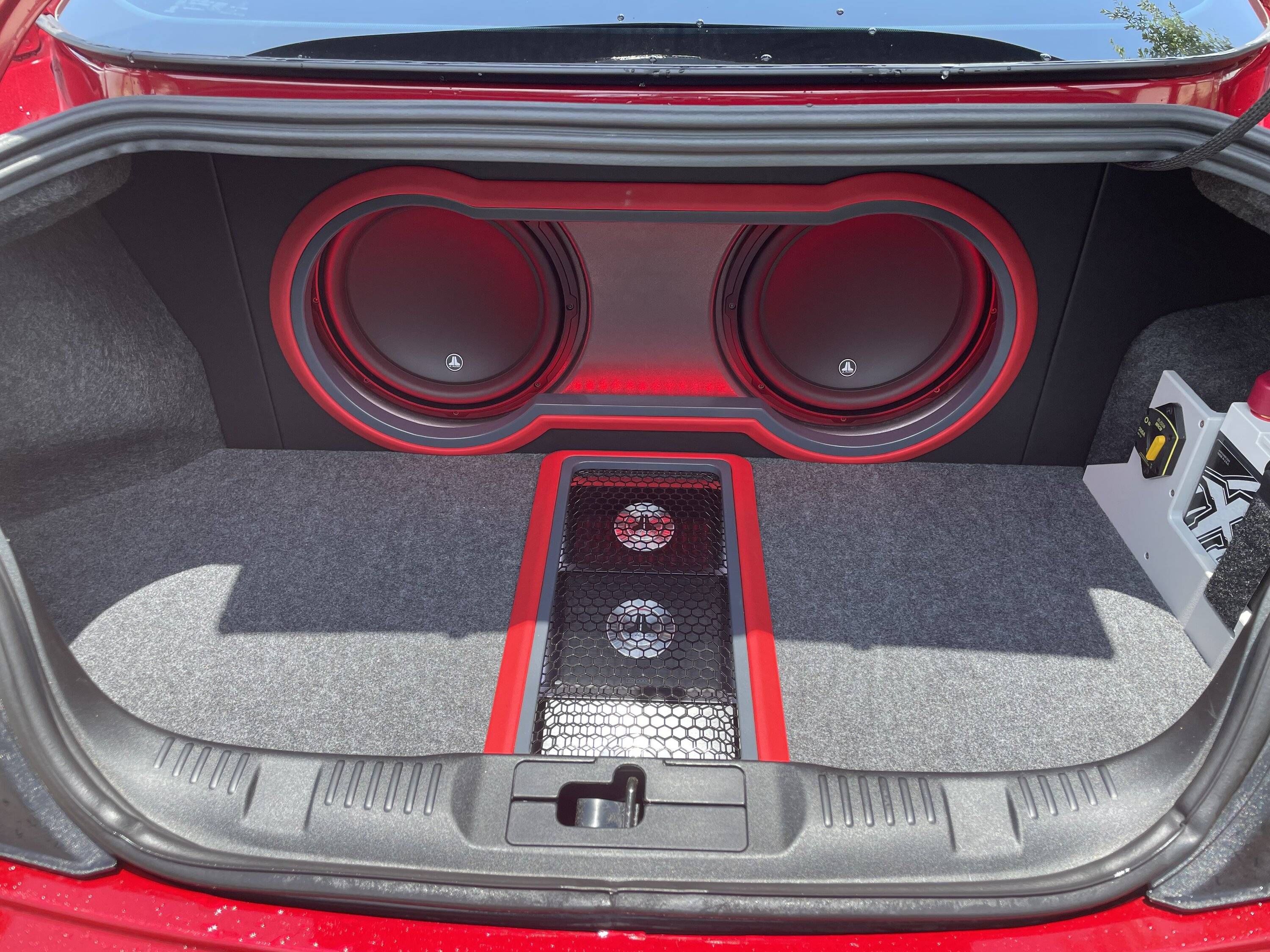

I read all 24 pages of the Zenclosure thread and it’s got me wondering if I should just go that way and be done with it. I also like the JL stealth box setup, but that’s on the pricey side. The custom fabricator in me is tempted to do something custom.
