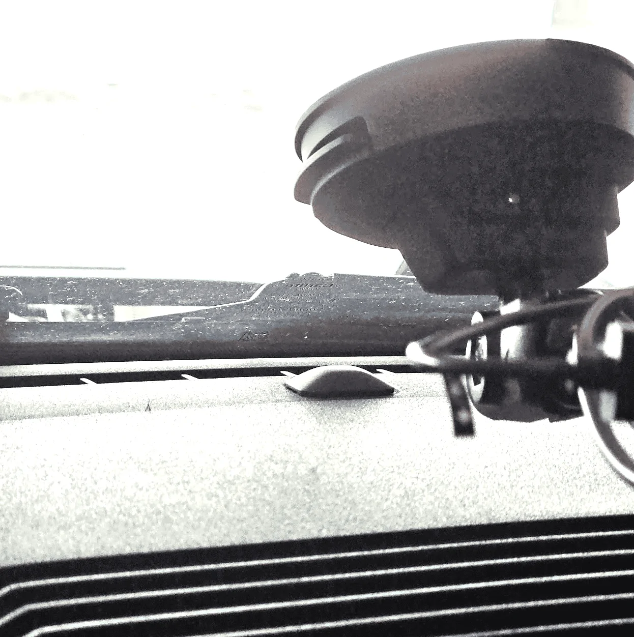

A friend of mine had this exact problem with her SUV. I offered to check it out and, there was her hat sitting smack in the middle of the dashboard tucked forward against the windshield. I moved her hat off the sunlight sensor and all was well. So, take a good look at the little square sunlight sensor on top of the dashboard. Here's mine (hint - it's not the Garmin baseplate stuck to the glass):

LOL…thanks JJ for helping me think of everyring, but the sensor is not obstructed. It looks fine.

Is it possible the vibration from the cutting tool knocked something loose with that sensor? There’s no nicks or scuffs on it from being hit or bumped by anything.
If that sensor is damaged or unplugged, that would default the lights to on instead of off?
Does that center dash piece pop off to access it to check for something?

Interesting question - do the headlights go off if you turn the headlight switch to "off"? They should because the "autolamp" function is disabled then. If they stay on, then something more fundamental may be happening.
If that works correctly, and you have Forscan, use it to check for BCM trouble codes.
As for which problem the sensor might have, from my quick read of the "autolamp" test procedure in the service manual, regardless of what's wrong with the sensor, the headlights will be on continuously. Presumably that's a safety measure so a failure while driving in the dark doesn't turn off your headlights.
In any case, replacing the sensor is pretty straightforward. Use a "non-marring" pry tool to pry the sensor out of its hole, pull it up, release the connector, plug in a new sensor and snap it back into place. I know this works because I've done it, although that was part of installing a Tech Pack Sync3 setup in my Track Pack car. As for non-marring, I just put some masking tape along the sides of the sensor to protect the dashboard finish and used a plastic upholstery tool.

Well, then, you can replace the sensor and see if that helps. IIRC, 2017's came with dual automatic temperature (climate) control. If so, the sensor PN is DG9Z-13A018-E. This gizmo is a dual-function sensor that sends signals to the BCM to manage the headlights as well as sending voltages to the FCIM showing the sun-load on the car as part of the dual auto climate control. If your climate control is behaving strangely, it might be a clue about the sensor. By strange, what I experienced before I replaced my sensor was that I had to manually adjust the A/C settings if I went from a cloudy are to a sunny area. With the new sensor, one setting works for both.
