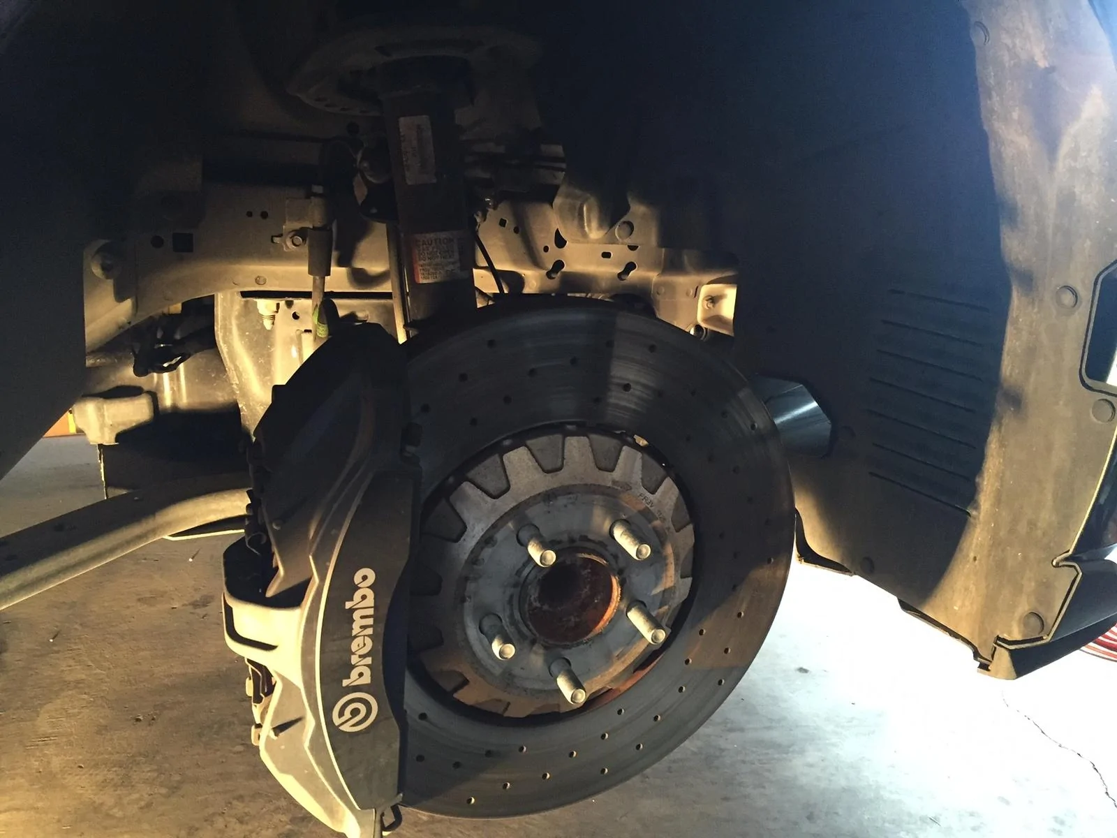

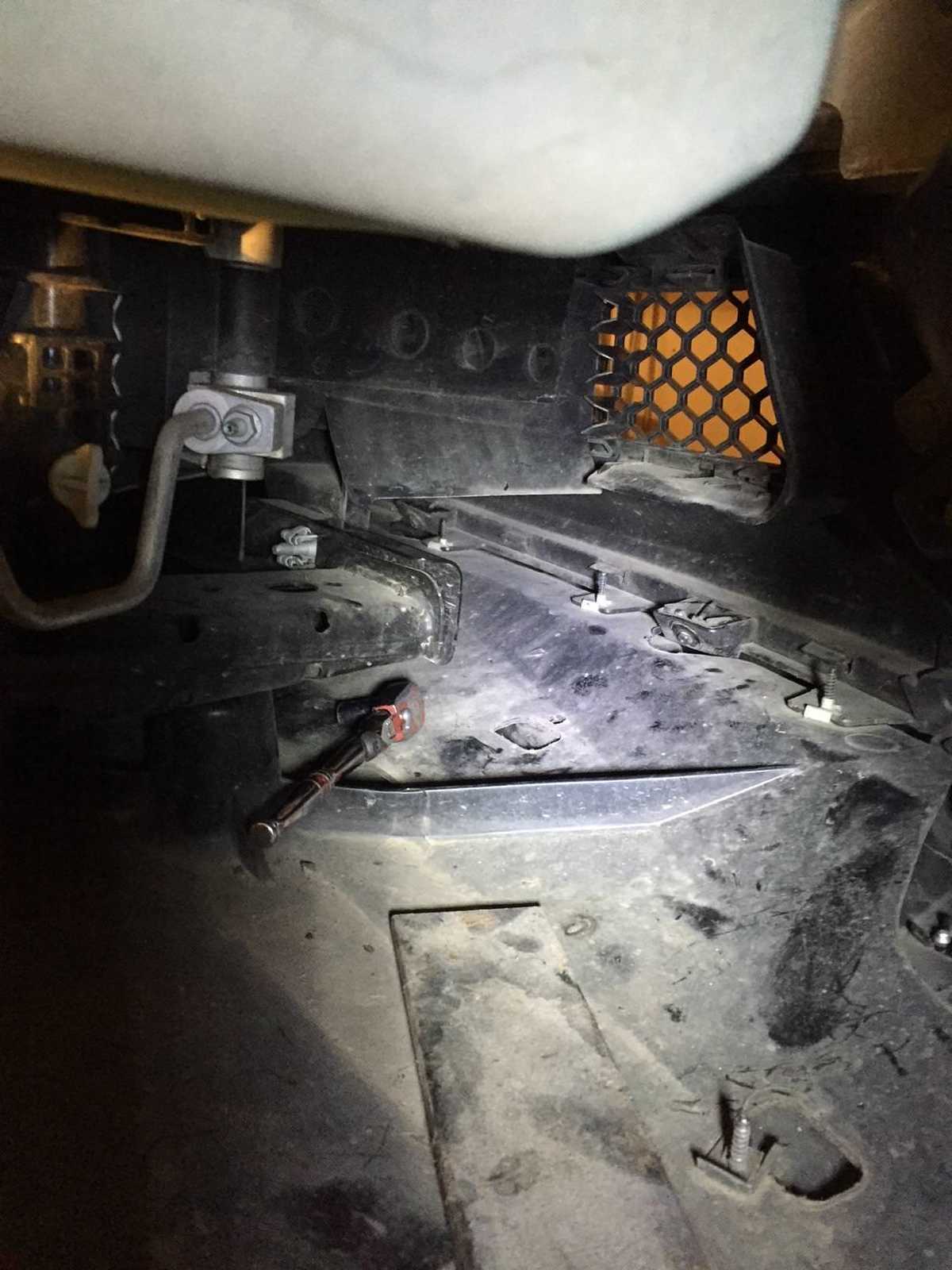

^I assume all here can get their car safely jacked up and get the wheel off. I have the streeda jacking rails on my car which for those planning to do their own work without a lift is definitely a must have mod. BMR also make a jacking rail which i hear is also a very nice piece. So with the car jacked and the wheel off this is what you are presented with. With panel puller (fork shaped tool) or carefully with a screwdriver or vice grips pull all the pull pins out of the inner fenderwell. (Note that 2017+ cars and tech pack cars may have their shocks look different as those cars have magride.)
image2 (002) by bmalkins2, on Flickr

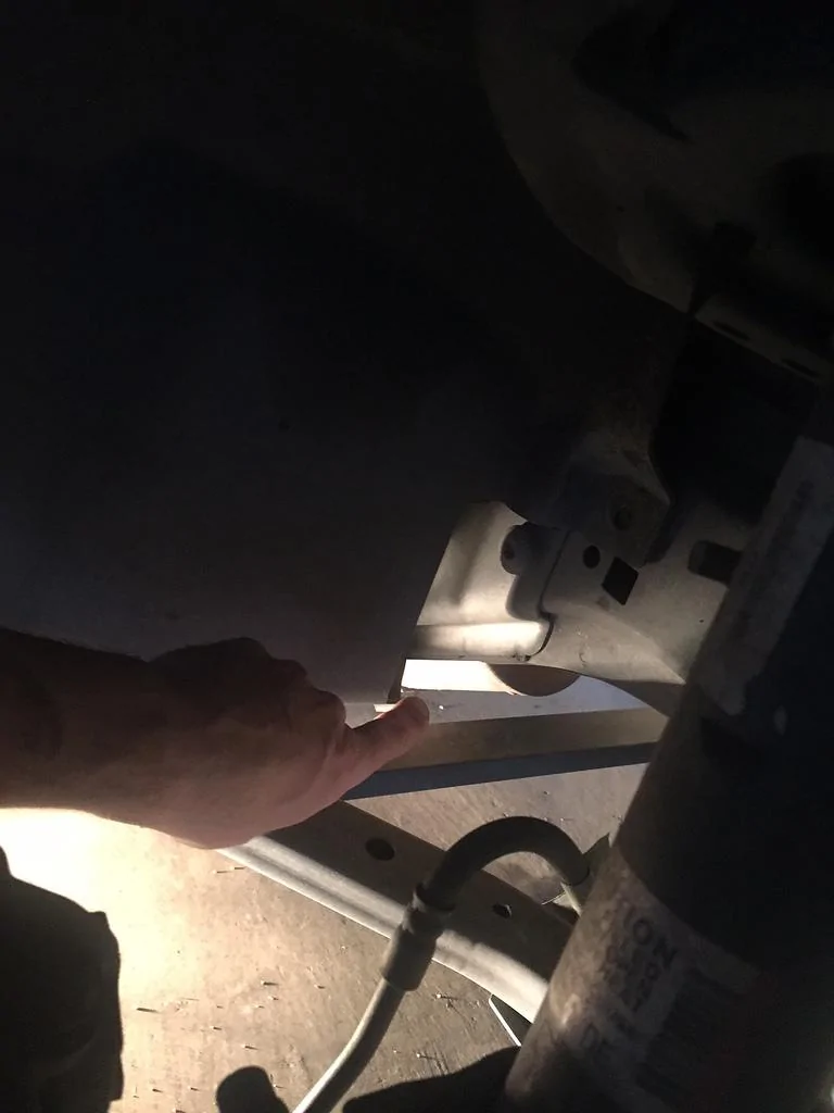

^When pulling out the push pins for the inner fenderwell there is one last push pin that is accessed from the transmission tunnel just behind where I am pointing.

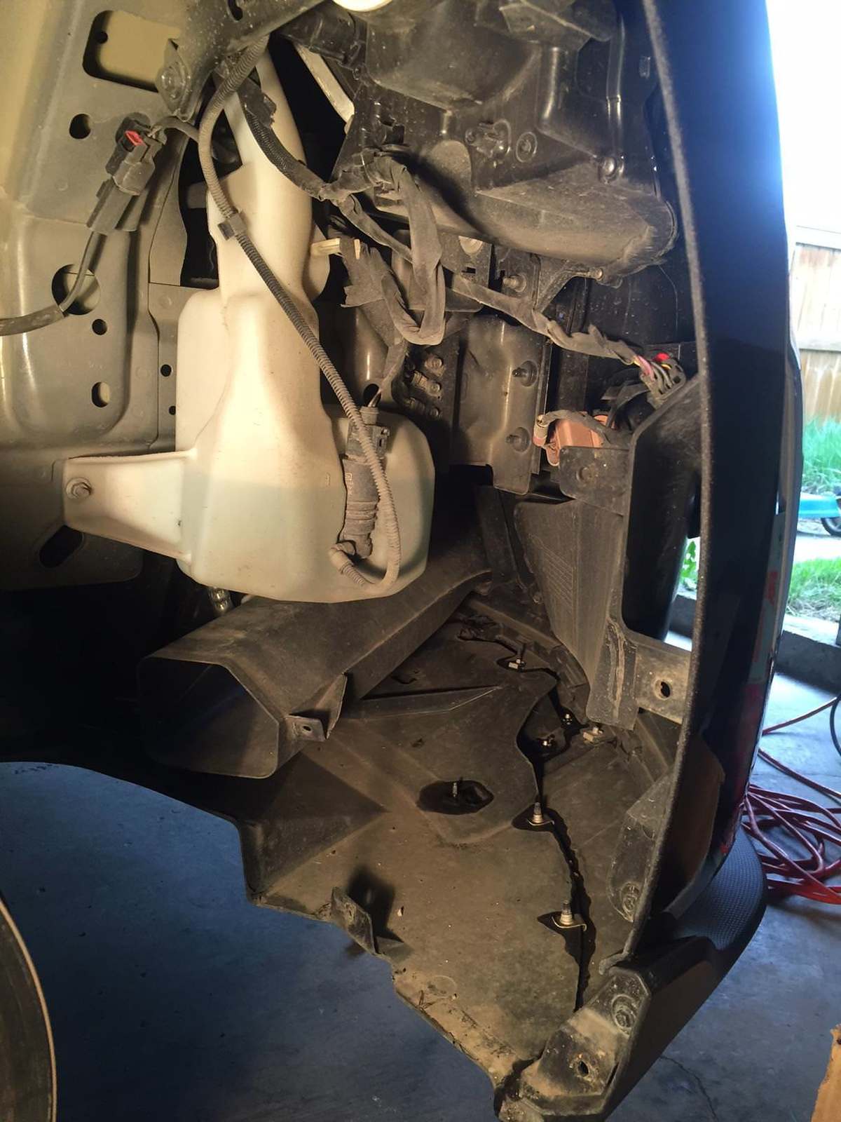

^Once the plastic inner fenderwell is out this is what you will be presented with. Note that the brake cooling tube has a push pin attaching it to the bumper. Once that pin is out, it just pulls out easy.

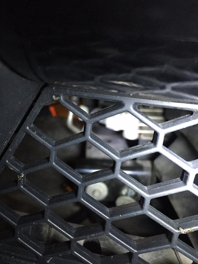

^With a trusty 7mm socket remove the factory vent block off plate. Save the screws you take out!

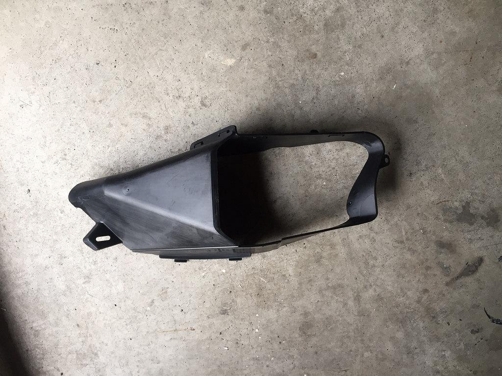

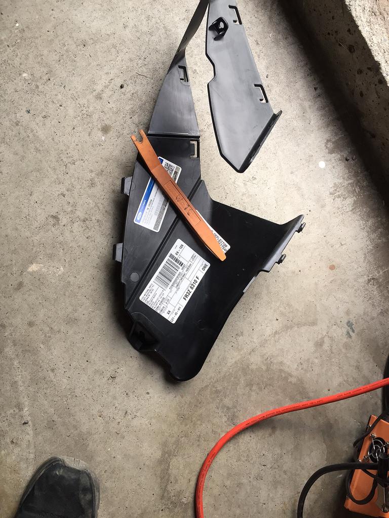

^ now when you get the air duct from ford it will look like this. Which doesn't look like a duct UNTIL YOU FOLD IT. Me and the parts guys both felt super dumb when we got the part and thought it was wrong as it didn't look like the picture. But if you fold the tabs together......
image2 (003) by bmalkins2, on Flickr
^... it looks exactly like one would expect. Pie on our faces. So a small thing to be aware of.

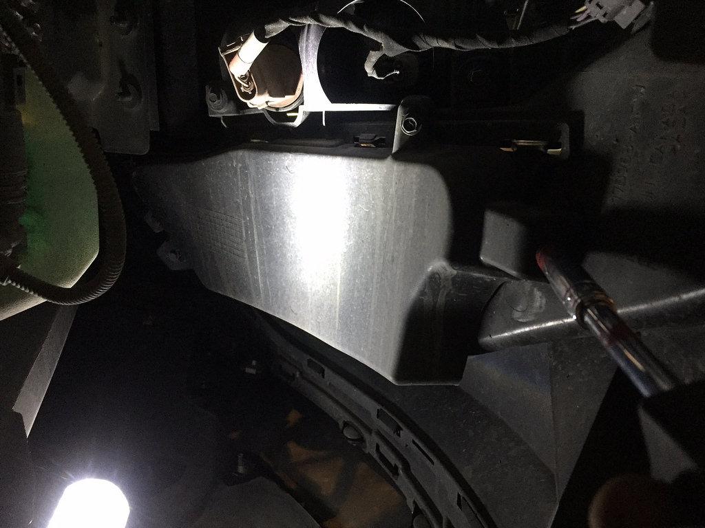

^ Next I took out the two small bolts at the front of the rad mount (were the wrench is pointing) with a 8mm socket. This bolts will form one of the 2 mounting points for my bracket (other being above the washer fluid see later steps)

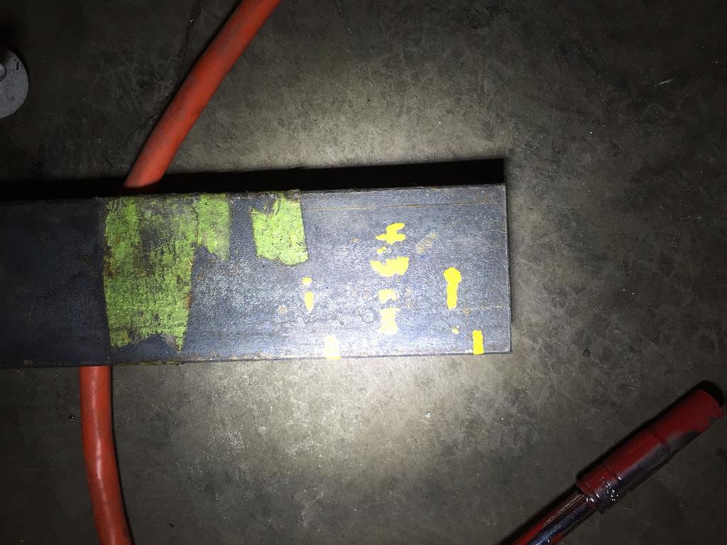

^Next start fabbing the lower mount starting with the two rad mount holes. Note that I measured their center to center distance as 4.3cm. Once those holes are drilled see below step

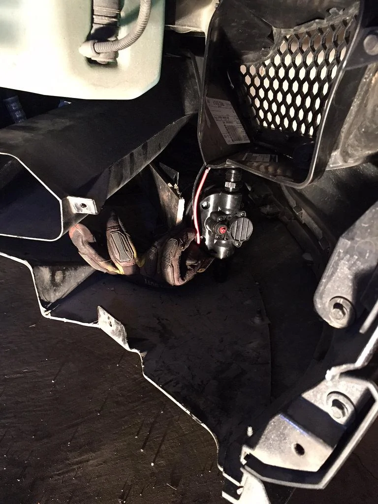

^Now install the air duct and test install the bracket. You will need to add a bend into the bracket so that it lines up with the angle of the air duct. Note that since I used thick steel you may need to cut a small notch in the steel to make bending it easier. Heating it would also work. Also in the above pictures shows my first draft of the pump mounting location.
