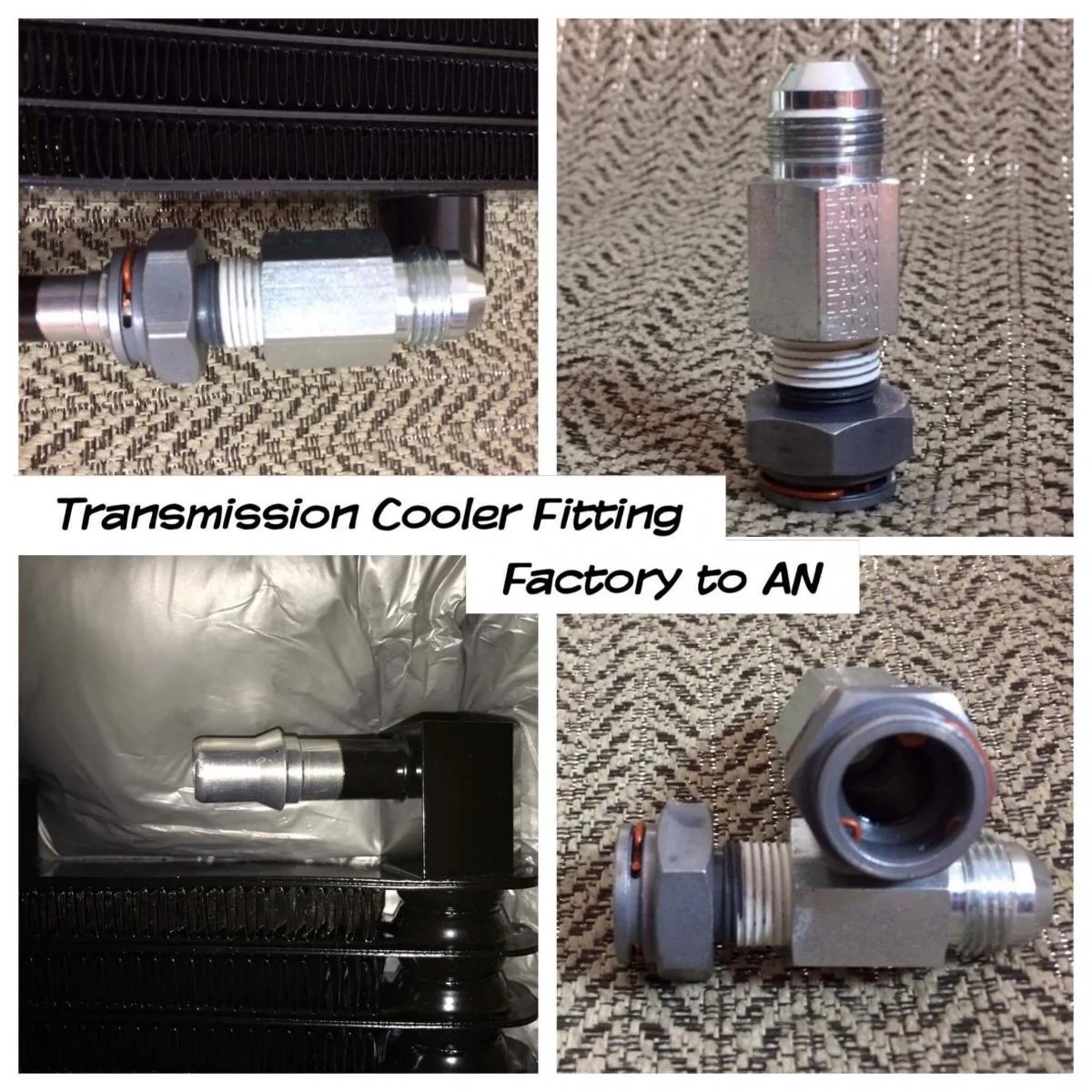

Too late. Cars on lift everything installed but this last line. I need that bung or the TK adapter

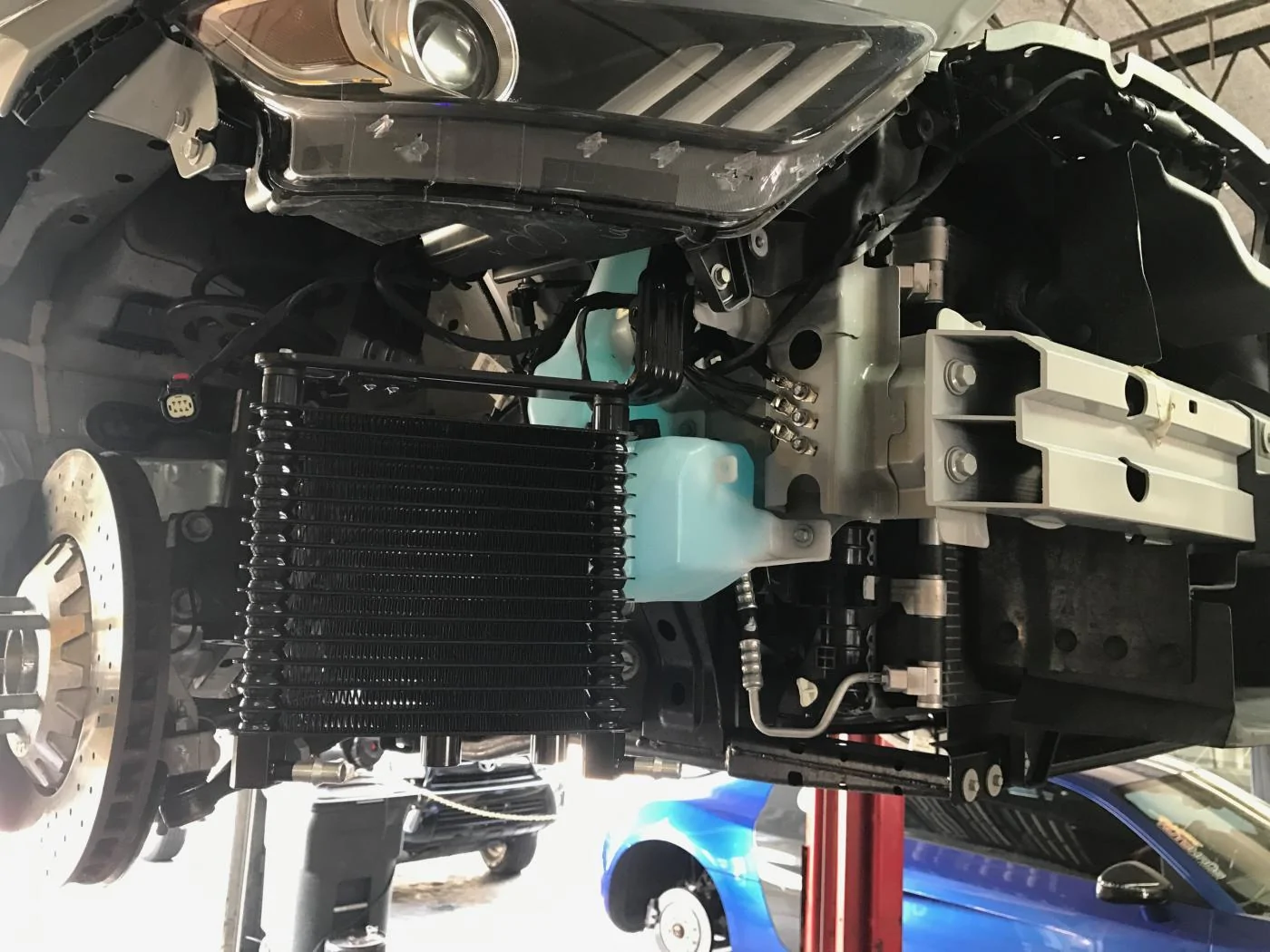

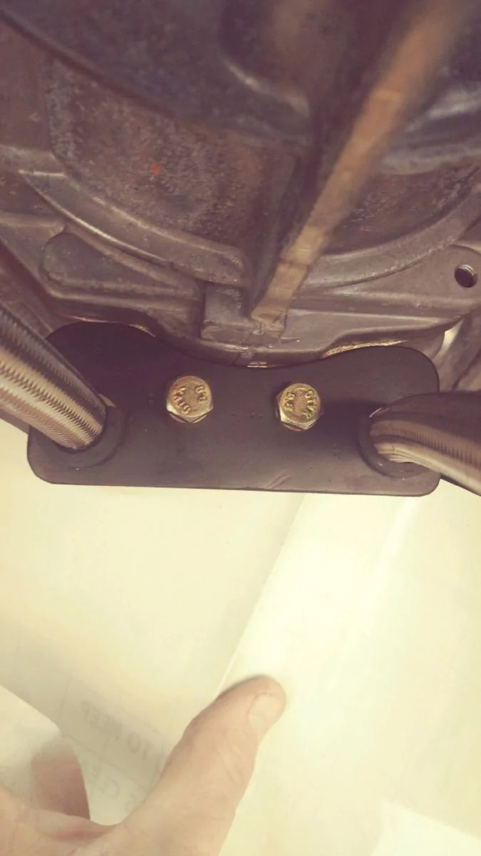

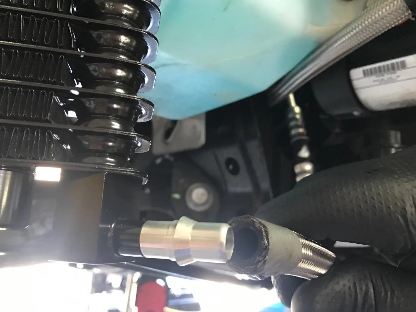

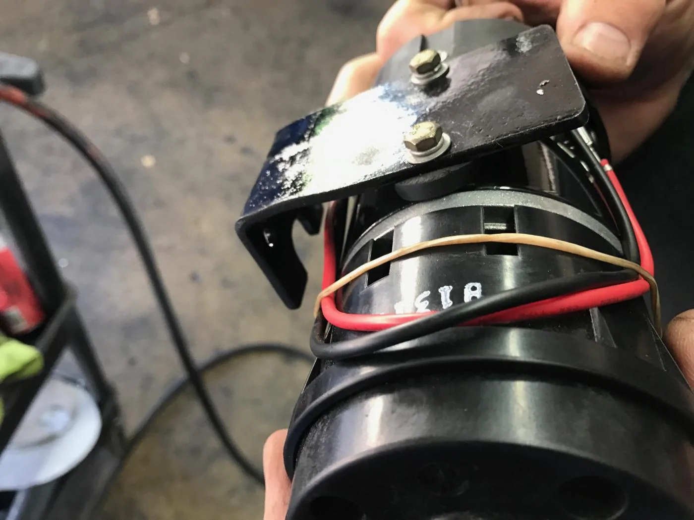

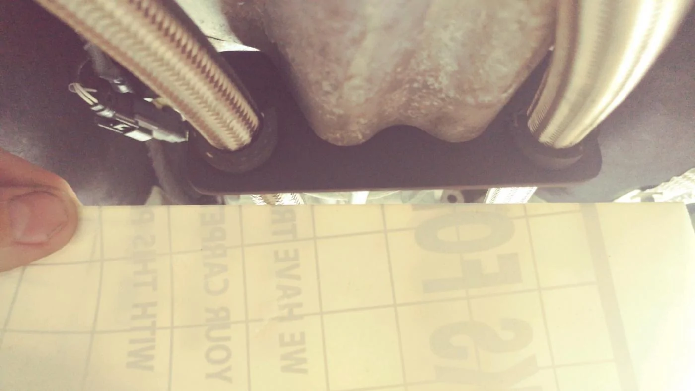

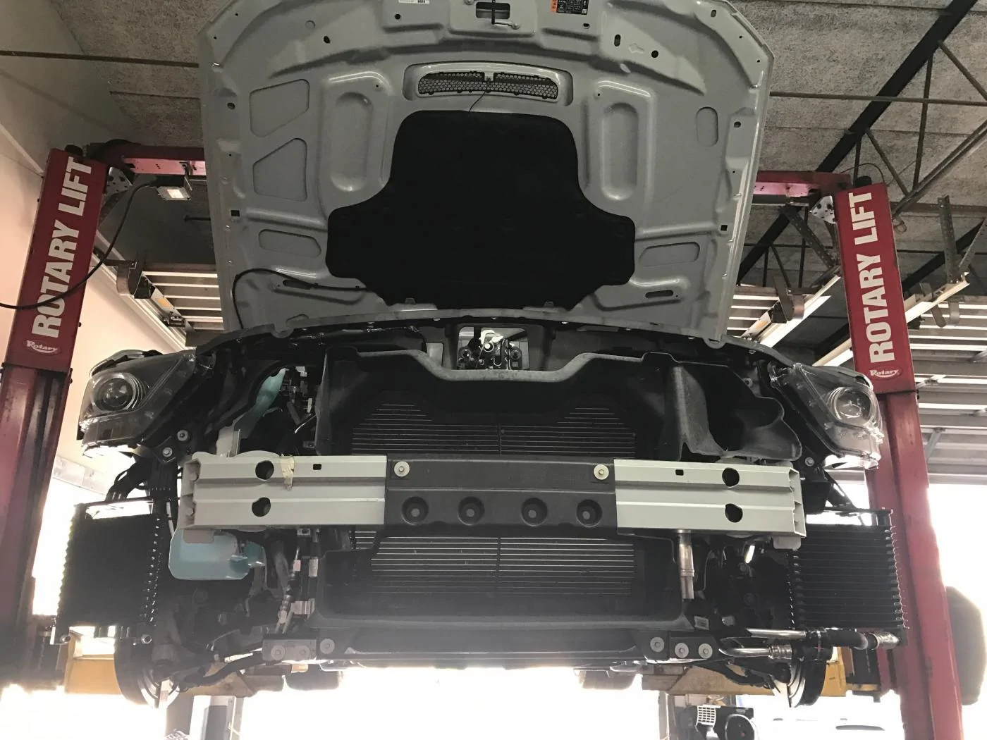

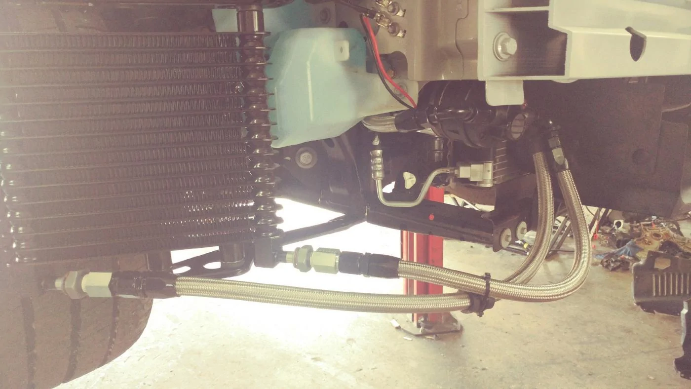

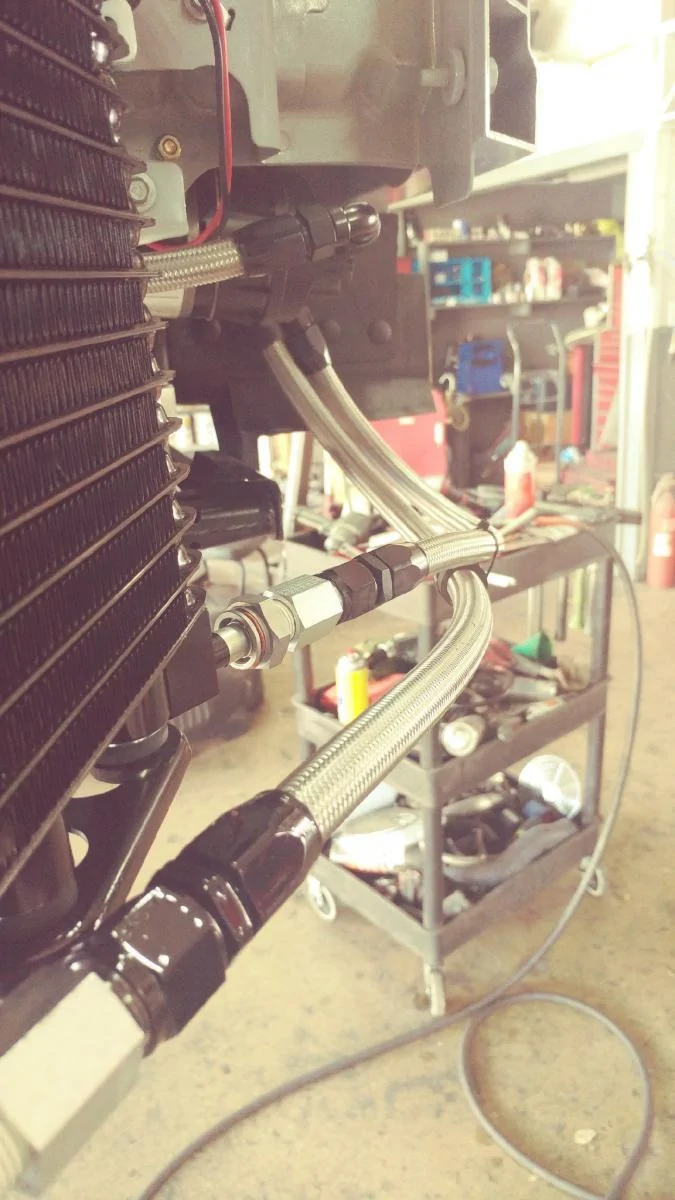

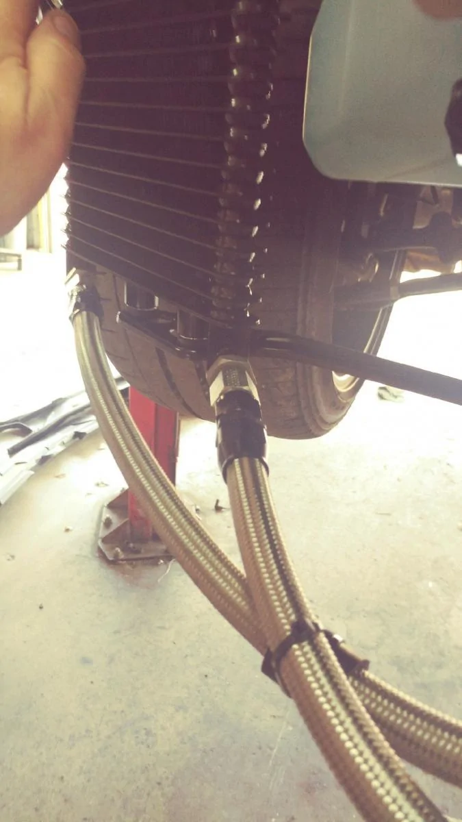

Ok...heres the deal. Ford OEM cooler and bracket installed. i used Fragola 8AN braided line and fragiola fittings. Tilton pump and TK Autosports adapter fitting to convert the AN to the ford fitting...It works AWESOME. drove it today in 87degree ambient temp till it got up to 198degrees. flipped the pump on and in 1 min it was down 20degrees. in 7-8min it was down 50degrees. When the car is running under any type of load in sport mode, you do not hear the pump. At idle you do hear pump.:headband

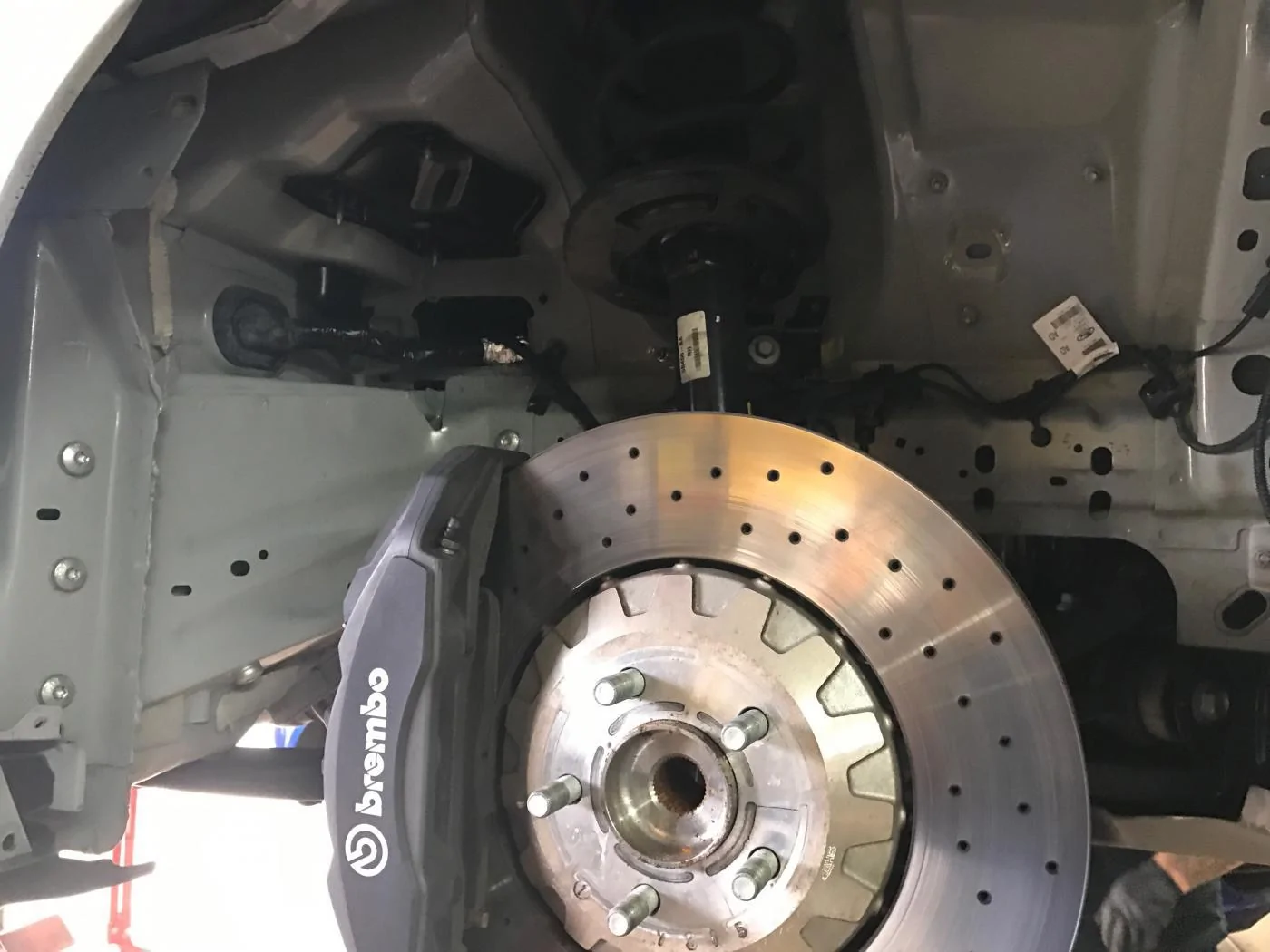

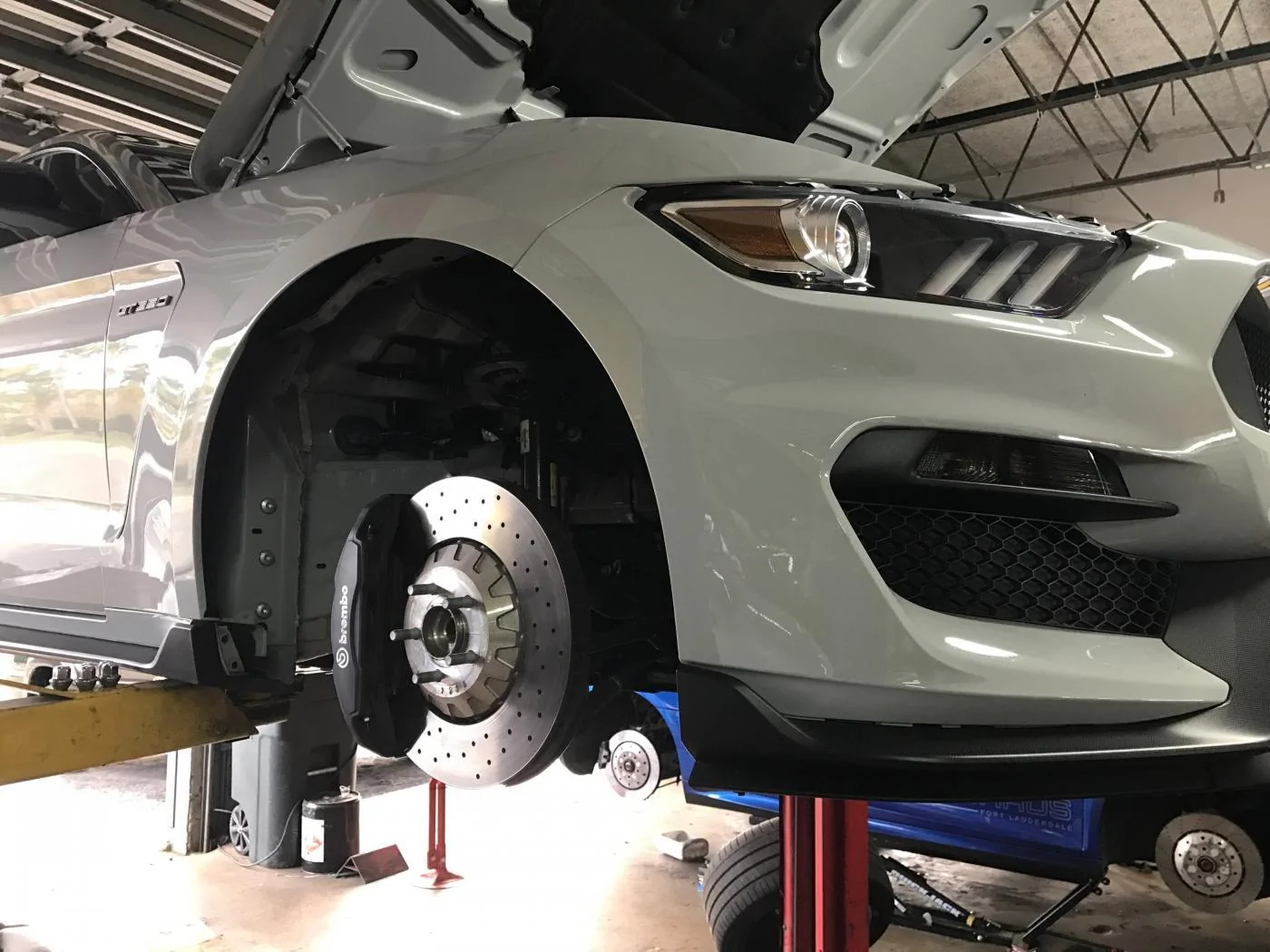

Great pics thanks. What is being shown in the wheelwell pics??
