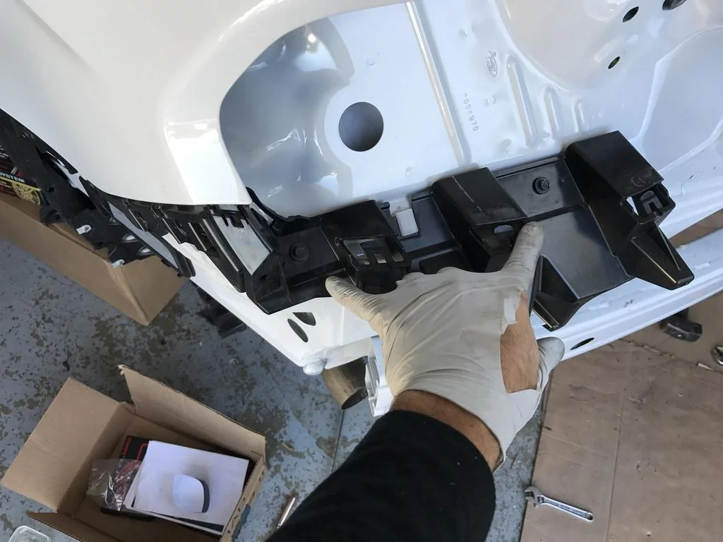

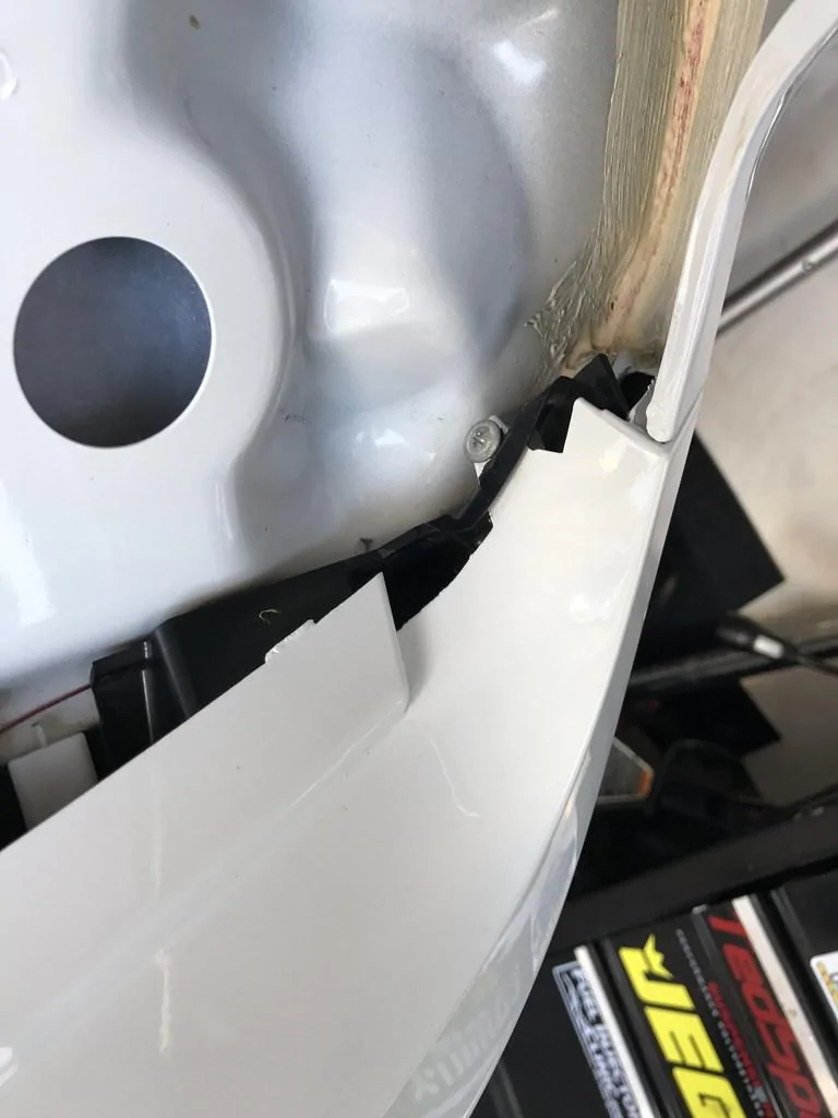

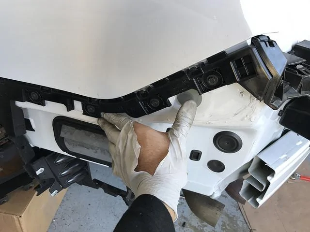

Loosen all of the screws in this area and push up. Now tighten.
Next reinstall bumper, the lines were tight but I added these screws to prevent any future sagging. These are just simply 1/2 long self tapping screws. To be clear the screw is going into the plastic tab, no sheet metal. If you used a long one however it may hit the sheet metal.

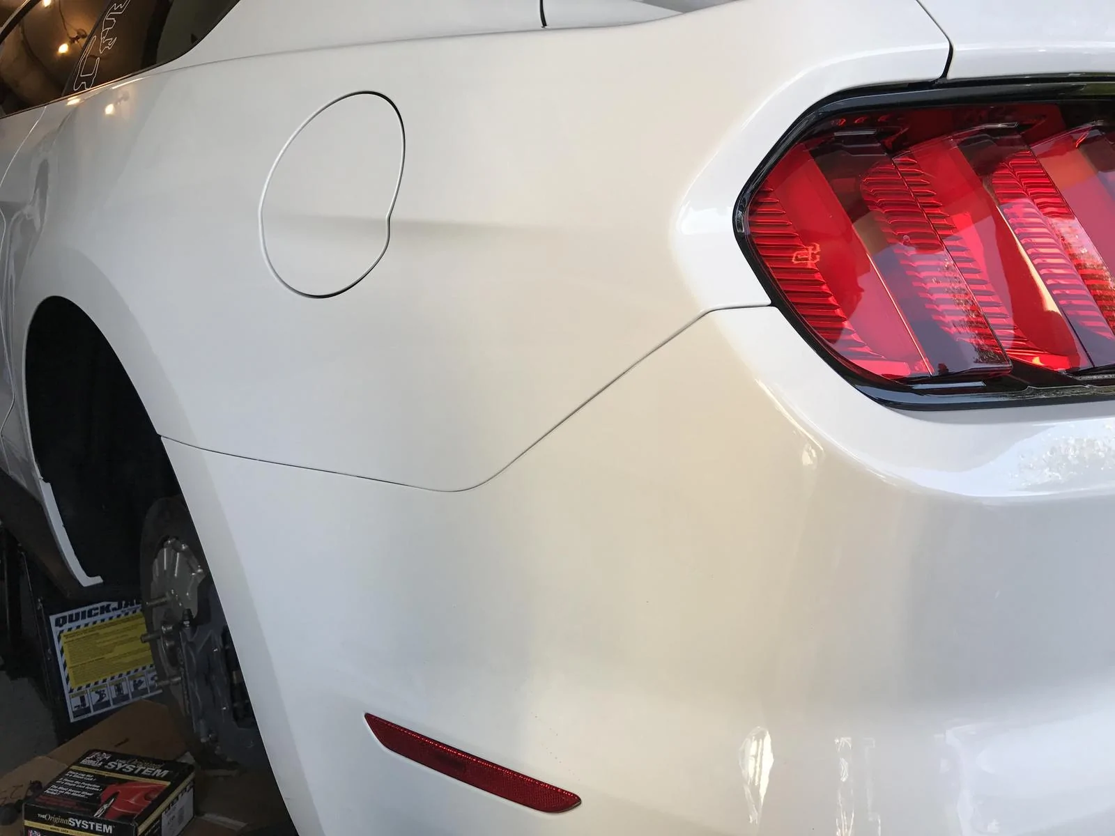

Finished product
Close up

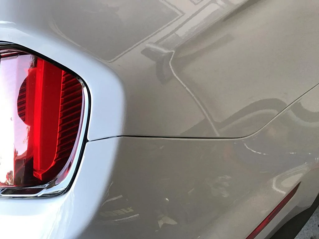

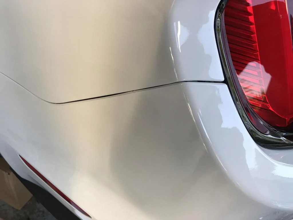

Before hand I had a 1/8 gap which was more at the tail light area.
Overall easy to do.

That's the beauty of it, the screw only goes into the plastic tab. It goes no where near metal.
You'd probably be ok with the screw but the bumper is heavy. A lot heavier than it looks
