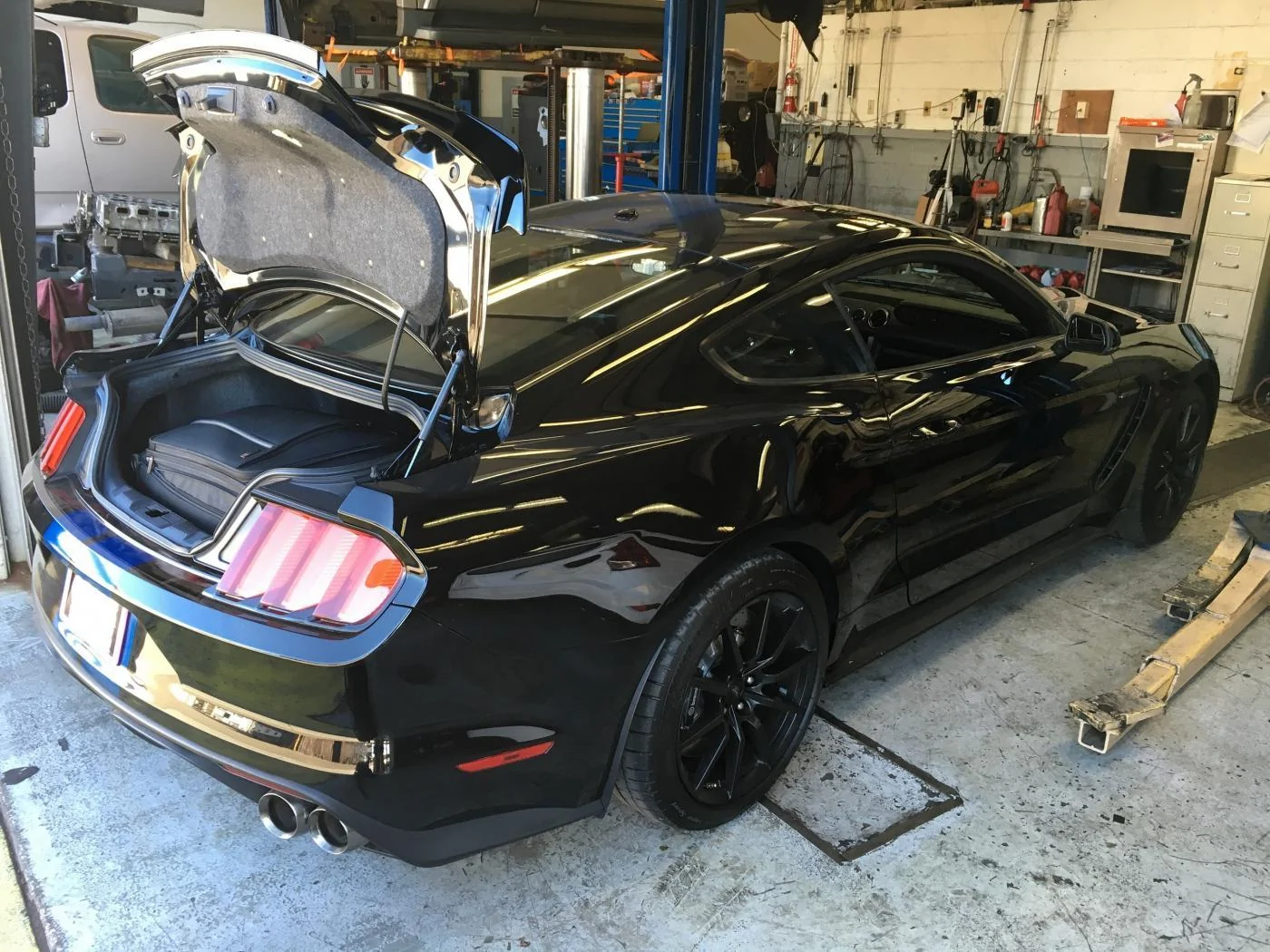

I bought a new 2017 Mustang GT 350 while on a business trip in Arizona. Call me crazy I know but it was a killer deal on one and it was exactly what I wanted. I figured I would just drive it home. Cross Country trip in a GT 350 sounded awesome and what could go wrong. Should not have said that...
I get on the road and after 210 miles total on the car I pull into a small store just outside of Tucson for a drink and some snacks. Gong to be a long trip.
Get back in the car fire it up and immediately the car is running really rough. The front end is shaking and it is barely running. I shut it off and started it again. Same thing.
Long story short I get it to a Ford dealer. They tell me they think its the computer and it will take 5 days to fix. So I decided to fly home.
Today I get a call and they tell me they got past the computer problem but the bad news is there is broken valve spring on Cyl #5. They are going to have to replace and make sure nothing else is wrong.
So this is a 210 mile 2017 GT-350 with a broken valve spring. Mind you its never been over 80 and has not been revved passed 5000 rpm's. I called Ford and they have been very helpful so far but I am wondering what I should do. Should I keep the car and get Ford to help me get it to Charleston and cover my travel and maybe ask for an extended warranty or should I try and return the car.
They are telling me a valve spring is a easy fix and not much of a concern. I called Ford Racing and they said the same. The only thing they added was have them change the oil and that it was shocking that it happened.
I don't know and thought I would ask for some advice. New member but long time reader. Here's what she looked like when I left her stranded in AZ.

Is that the ford dealership that it's at? Only reason i ask is because it looks incredibly small for a service bay. My only concern would be having such a small dealership doing the work on this car. I guess it will all come down to who they have working there but still would make me nervous

This is in the bay of the dealer doing the repair. I went and talked to the tech for an hour and looked over the car with him. I was sure it was a loose connection. He could not get the computer to talk to it on Saturday but Ford was able to remote in and get that going Monday morning. He has worked there 25 years and the manager told me he has 3 guys that he would trust with one of these and I had one of those guys. He (the tech) told me that they have sold quote a few of them and they have not seen one back yet. He seems to know what he is doing. Its a pretty large dealership. Id say they had 30 bays total but I am with you. I asked Ford if we should fly in a tech and they said lets get through spring repair and go from there.
