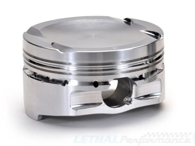

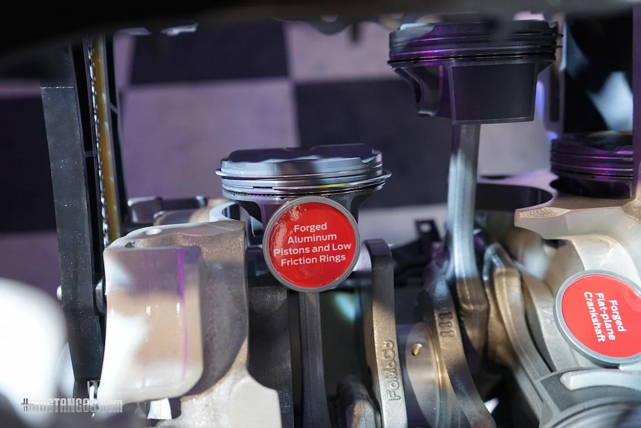

Forced induction was mentioned in another thread and here is my argument against it. This engine is made for high RPM operation and it highly tuned to be N/A, as such the pistons were made very light to accomplish these RPMs. Take one look at the ring landings and then realize the compression ratio will probably be near or in the 12:1 ratio. These pistons are already under a lot of stress as is, they weren't built for boost.
For comparison I have provided pictures of the Diamond Racing Trinity Piston built for boost and the Voodoo Piston.
