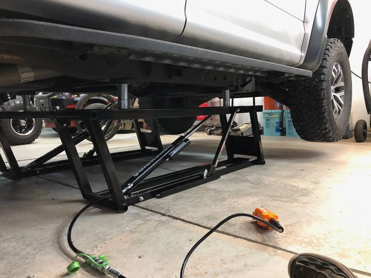

Hey KB. I picked up the BL-7000SLX last fall and highly recommend the QuickJack setup. Of course, I would rather have a fixed two point lift, but not in the cards with my garage.
I have a SuperCab Raptor and the frame rails beneath the cab are short and the EXT would have been too long. The SLX is just long enough to get under the pinch welds on my new GT350.
I can tell you that they work great. A great portable solution to get the wheels off the ground and get some extra room underneath to work on your vehicle. With the SUV/truck extensions, I can get the wheels off the ground of my Raptor for easy tire rotations. They are very sturdy and stable when the vehicle is up in the air, even with the truck extensions. It lifts my Raptor with no strain.
You don’t need the buy the extra pinch weld rubber blocks (the ones with the groove). The jack comes with a few sets of solid rubber blocks (varying thicknesses), which work just fine on the pinch rails.

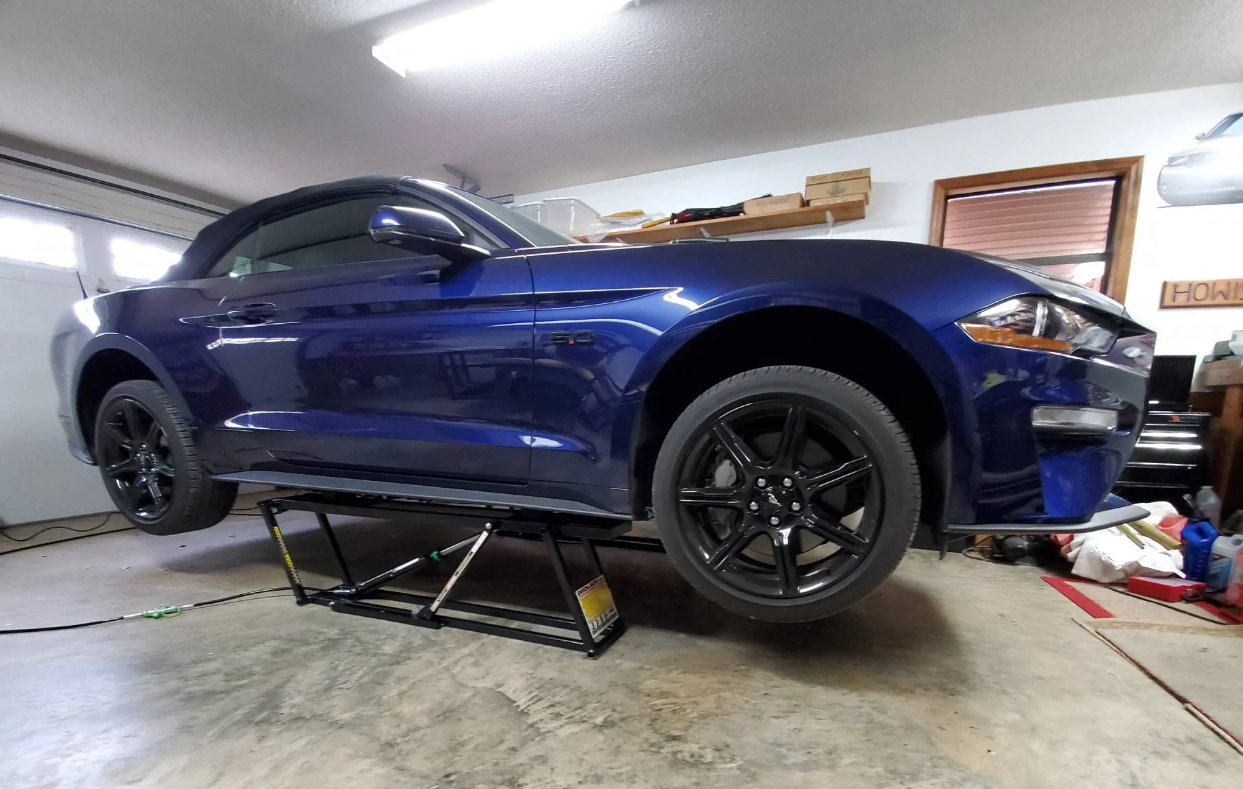

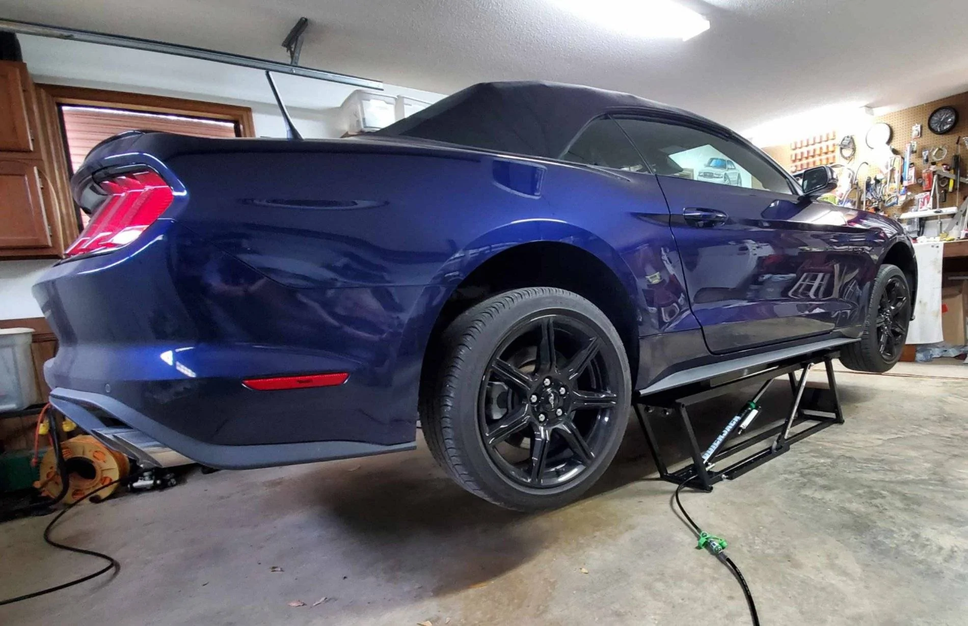

I have the Quick Jack 5000 SLX and it works GREAT.......no need for Jack Stands unless you wish to leave the vehicle on stands instead of the lift frames?? :idea:
I think the lift frames with the locking bars in place are way more stable than Jack Stands!!
Good Luck!!

@bendensez : WOW! Many thanks for that excellent info. I also have an '18 SuperDuty but me thinks using a QuickJack on that dude would be "teasing the animals." <smile> No big deal, it's high enough above the ground for most stuff and a floor jack works for one end or the other.
Not so with the new Shelby or her CT6 so those are the only vehicles I'll use it with and the SLX wasn't long enough for the Caddy.
Again, really appreciate the response and photos.
