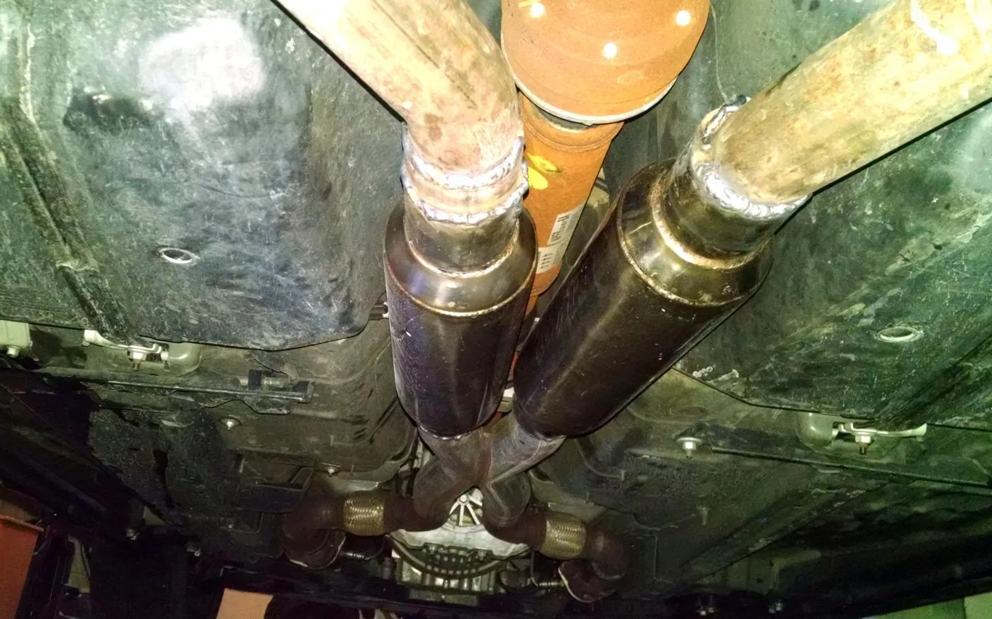

I had rasp issues and retained my x pipe with these resonators right after them.
Just did the same exact thing with magnaflows that the muffler shop had in stock. It removed all the rasp 100% and quieted the exhaust just a tad bit and removed some of the drone. I think it slowed the car down just a tad bit but it could be just in my head?
I doubt it slowed it down ill say its in your head lol but ya I retained it for strength and still get the power that the x pipe provides, but the sound is super clean now.
Glad you took the adv and like it

So your running resonators with the flownasters?
Maybe, Ill do more test runs. Thanks again.
Yeep
