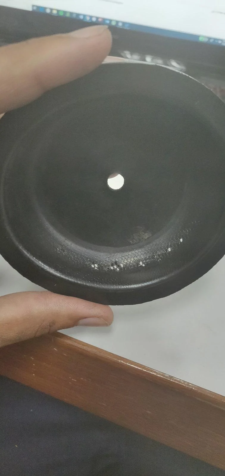

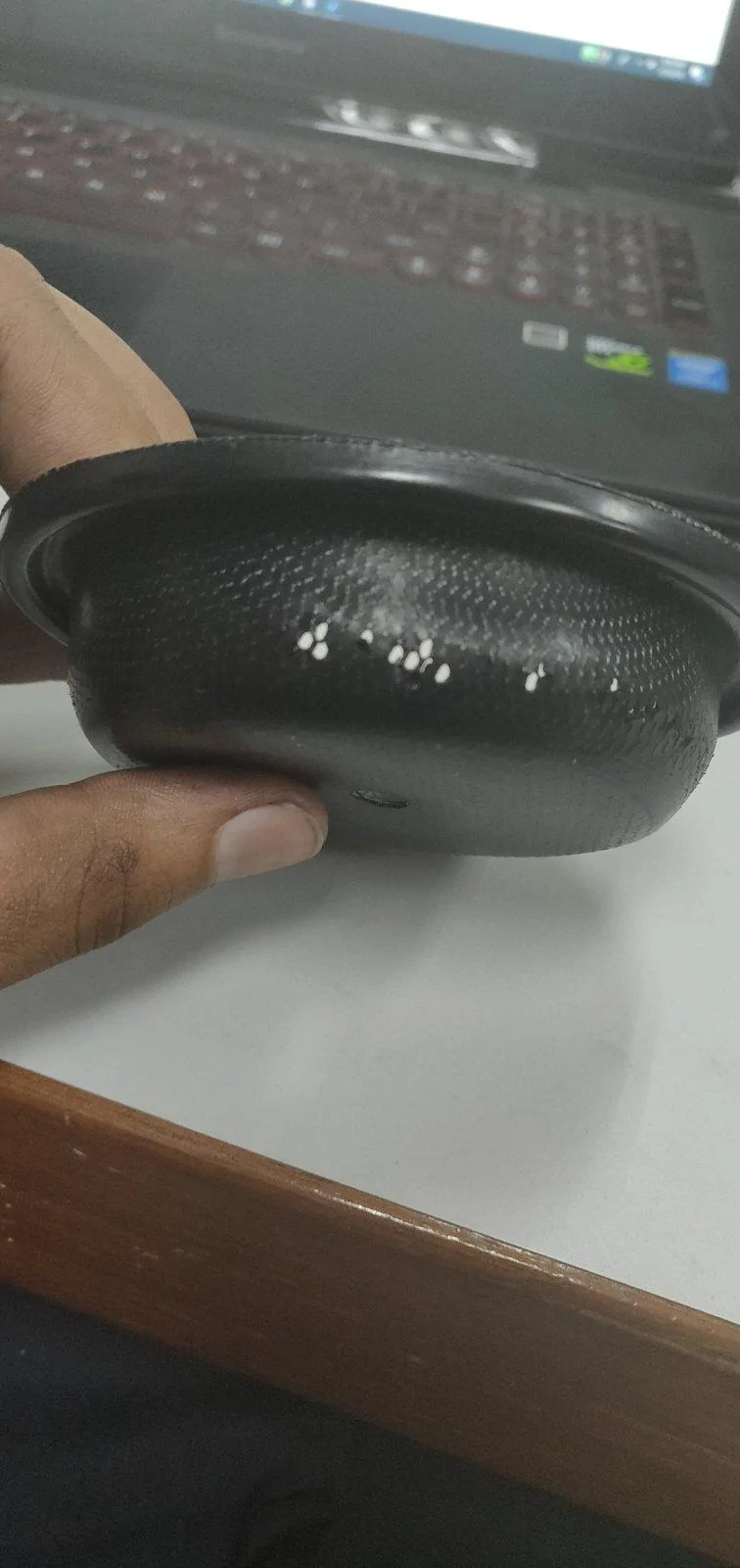

If anyone is curious.. Figured out the problem.
The diaphragm feels skinnier on the side w/ the holes, I think the mold to make the rubber diaphragm might have been worn out and I just got a defective seal.
Vortech has replaced under warranty and all is well !
It will be at my place early next week and once installed I will let ya know if the sound goes away.
