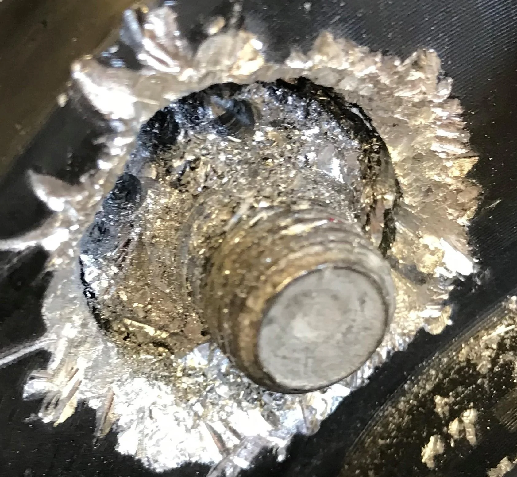

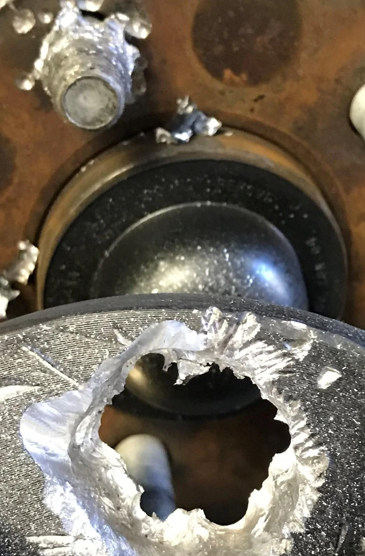

Well I decided to try getting the PETA Eibach wheel spacer off today. Tried keeping all the other nuts tight and an even bigger breaker bar and got no where. Heated it up for about 10 minutes and tried again. Nothing. Decided to hit it with the air chisel and I was able to get some of the nut away from the stud threads, but had to finish with an air drill. I still had to take the other nuts off and pry the thing off after all that. The damn stud STILL had part of the nut wrapped around the threads enough that I couldn't remove it. The cutoff wheel took care of that finally, and I was able to replace the stud and get it all back together.
Now for the other three wheels. First two a bitch, but no problems. Last wheel, last nut. Won't come off. Tried like hell with the breaker bar. I reluctantly decided to try the impact gun. Thing didn't move for a while and then spun. I thought it finally broke loose. Nope. Took the socket off only to find the nut completely rounded off. Put it all back together and said F it. Looks like I get to bust out the chisel and drill again another day. Good times!!! I love my car, I love my car, I love my car.....

Definately sucks all the fun out of wrenching. Any idea why that’s happening?
