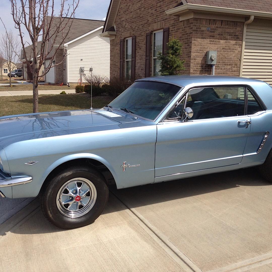

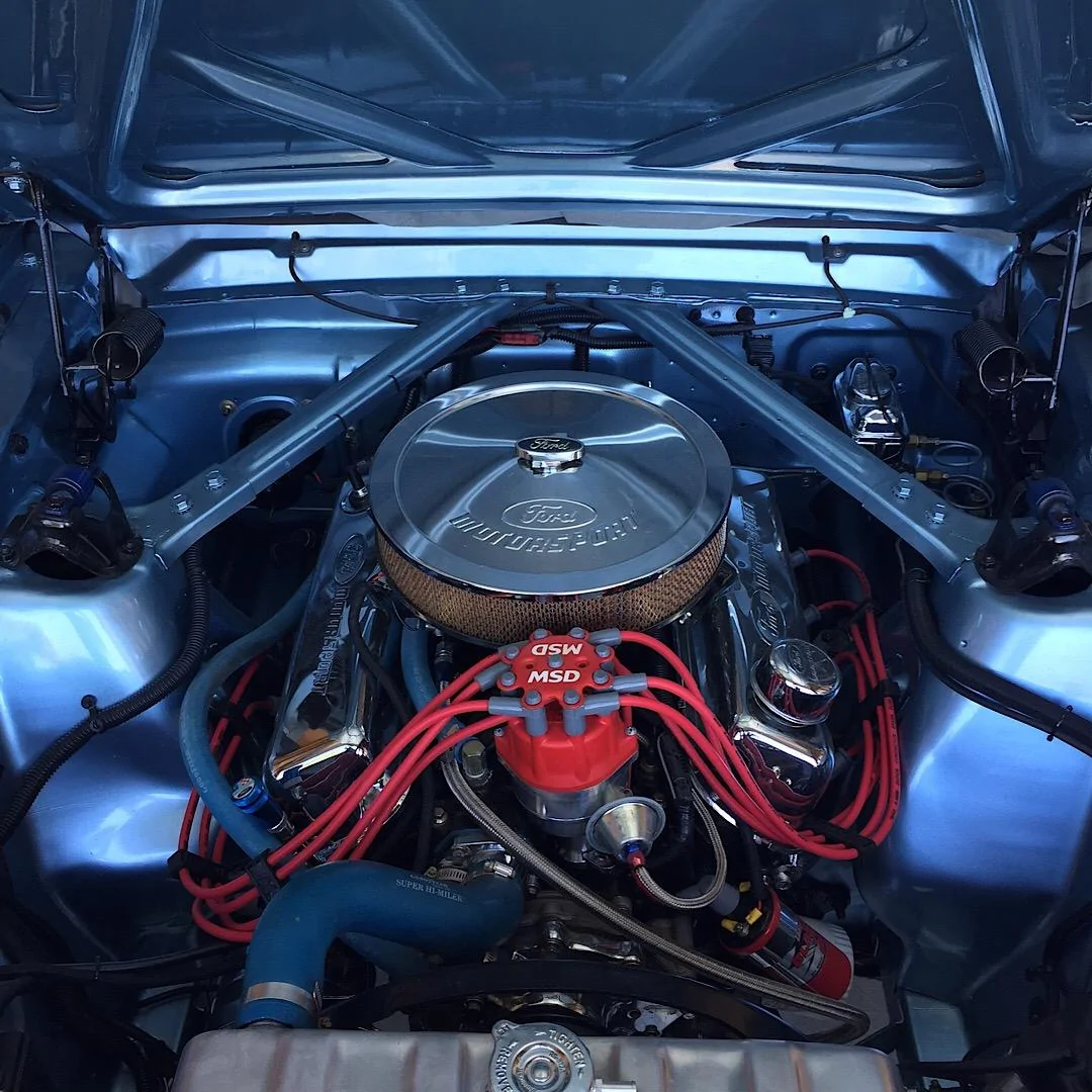

Nothing sweeter than a big block lope, I’m sure that was a very satisfying build, that’s a wonderful experience.

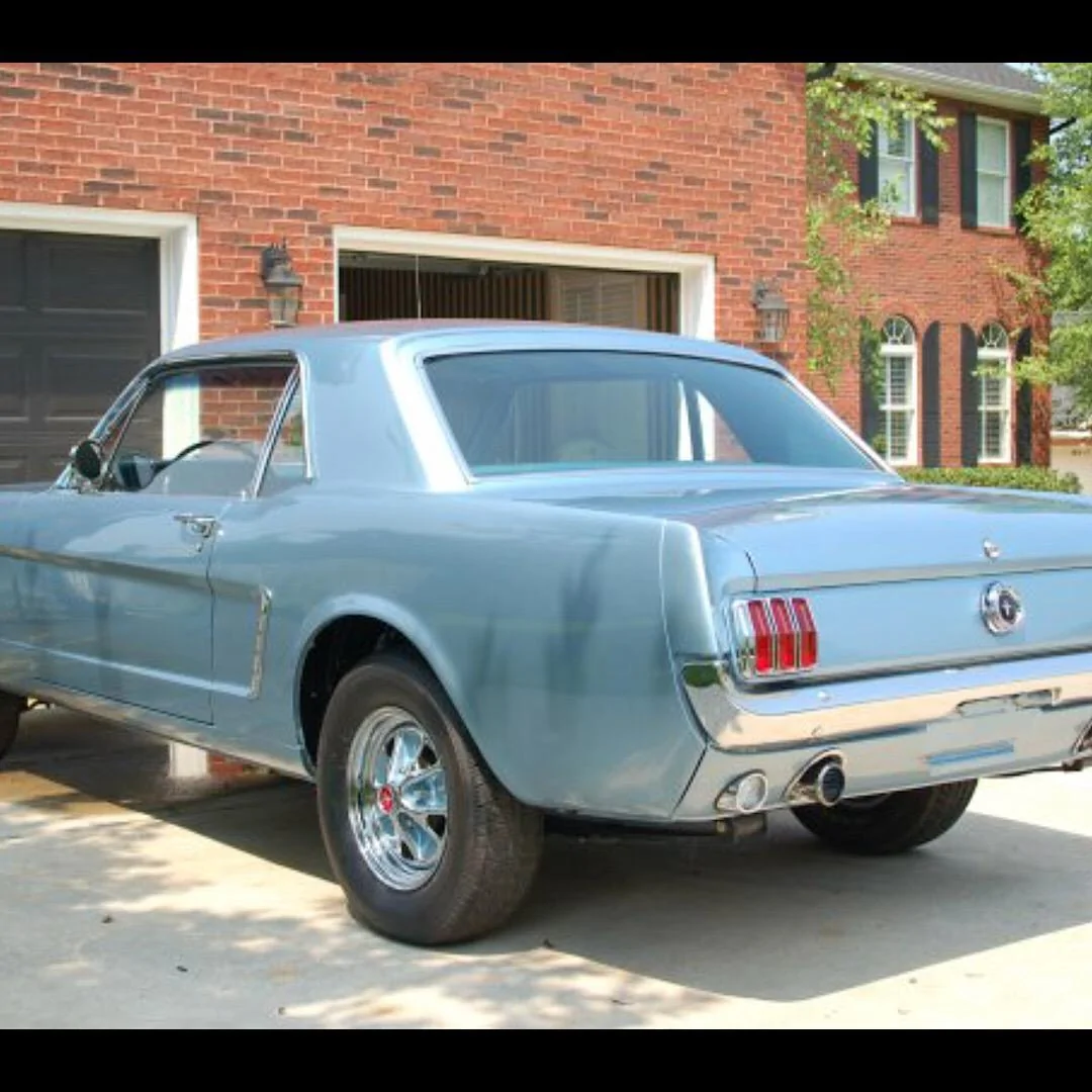

This was the only restoration I did, unfortunately my kids weren’t overly active in sharing my enthusiasm in collecting cars. I tried every way possible to include my kids and even give them this car but they just weren’t interested.

I have one the same color out in my shop, only it has the vinyl roof. If I could con my wife into it I will post a photo. This in reply to the gunmetal grey 65 above.
