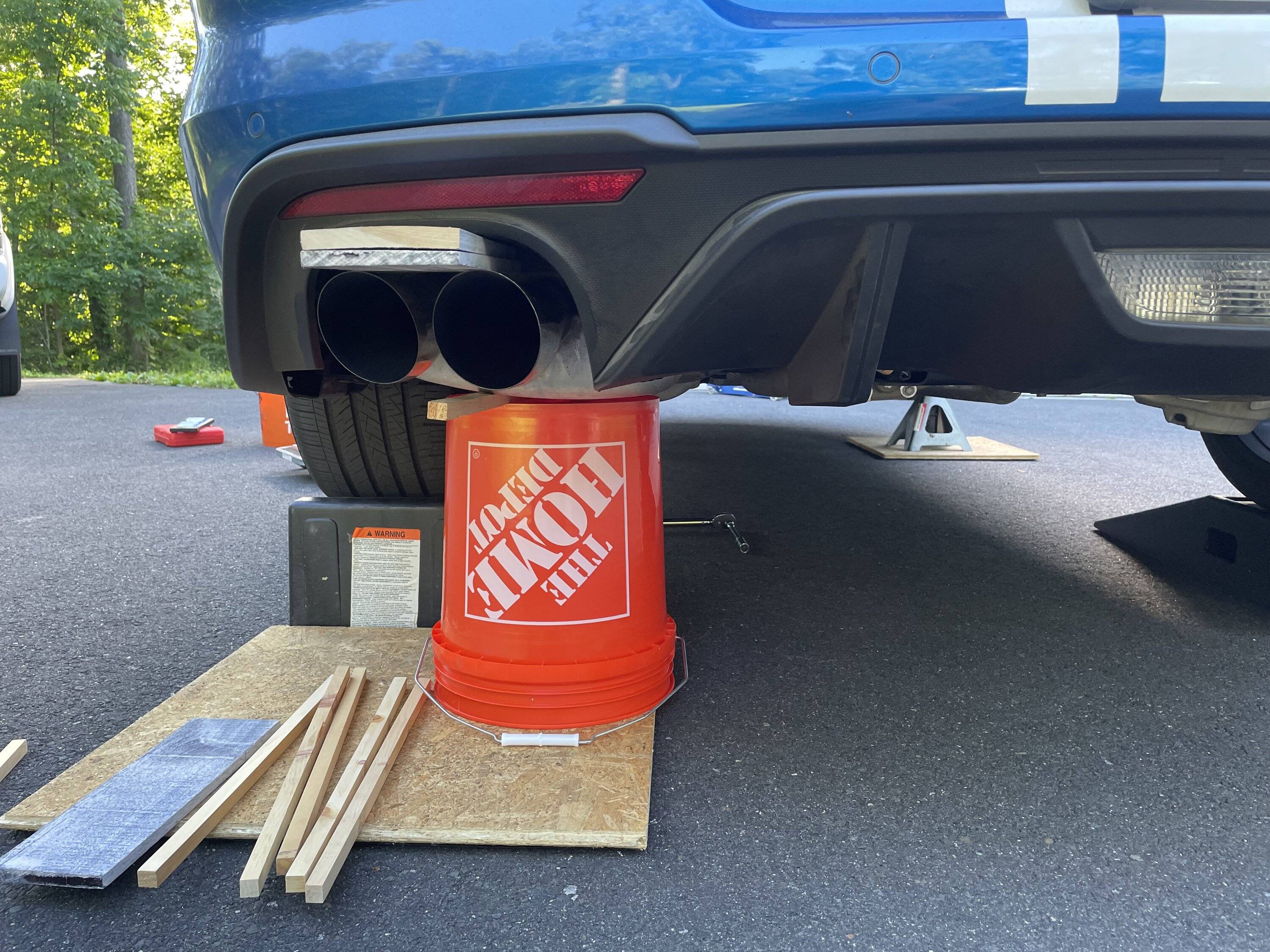

I just installed a Roush H-pipe on mine. Here's how I aligned the tips before tighten the clamps.
A homer bucket works well when backed onto 8" ramps. The muffler dropped ~1/4" once the bucket and shims were removed. Torque spec for the Roush clamp is 30 Nm.
Good luck!
Good luck!

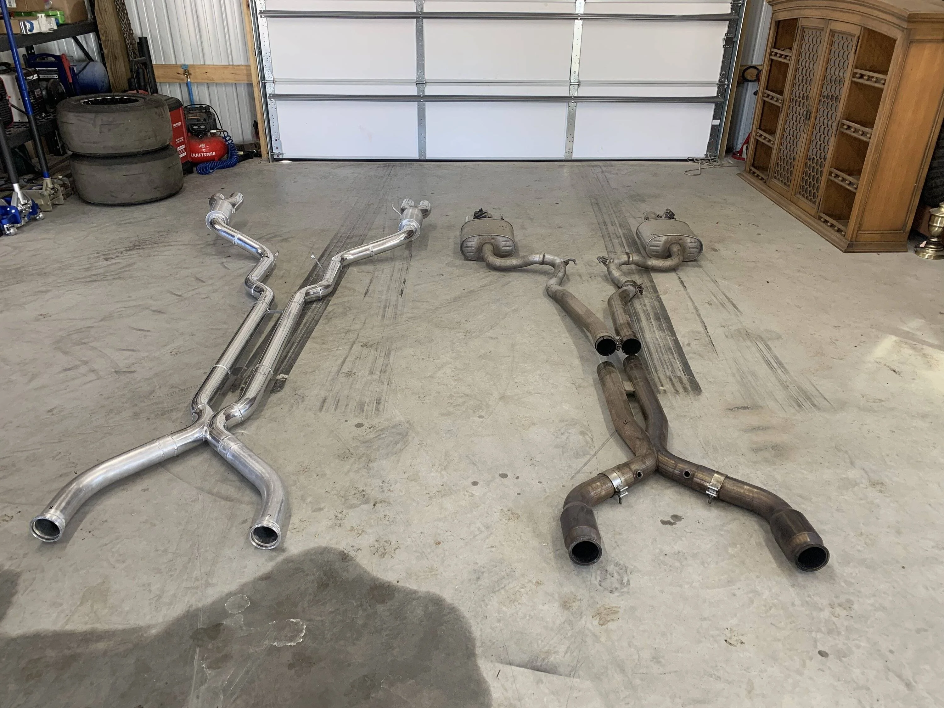

Absolutely my biggest pet peeve with these cars. I ended up getting them into place, then tack welding the joints so they could not move at all.
Although now I run a fully welded exhaust from the header back. of course it only weighs 23lbs and isn't a pain in the ass to remove all at once lol.
