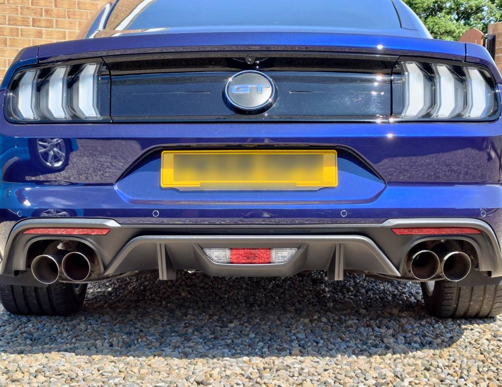

Not sure if this is just me but does the left exhaust look out of whack with the other side? 🧐
Is this a normal thing with the active exhaust; perhaps just poor assembly? Or is this a fault and something I can potentially fix? I haven't had a good poke about yet, just noticed it when I came home today. The car has had an H-pipe fitted but can't see how that would cause it to sag on the one side.
My OCD is not happy about this. 😁
Thanks.

You might need to loosen the clamps at the h pipe and realign your exhaust. I've also seen a few stock mustangs around that have crooked tips so it might have been like that prior to the hpipe. If you can't turn the hpipe to get it aligned you may be able to bend the bracket for the hanger to get it lined up. I had to do that on my borla exhaust. No matter how I turned it I couldn't get them level until I bent the hanger slightly.

Looks to me like both sides are off but the left side (US drivers side) is worse. I agree with Zrussian13 about adjusting from the Hpipe back to rotate those tips up.

One helpful tip that I did when lining up mufflers is I put a towel on the end of my jack and put the muffler in the position I wanted it with the jack before tightening all the clamps. This being stock and not an aftermarket catback limits what you can do there to the H-Pipe clamp. Maybe even try keeping it in place with the jack then tightening the H-Pipe clamp that way one side at a time.

Great tip thank you for that.

Yes it does. Very noticeable

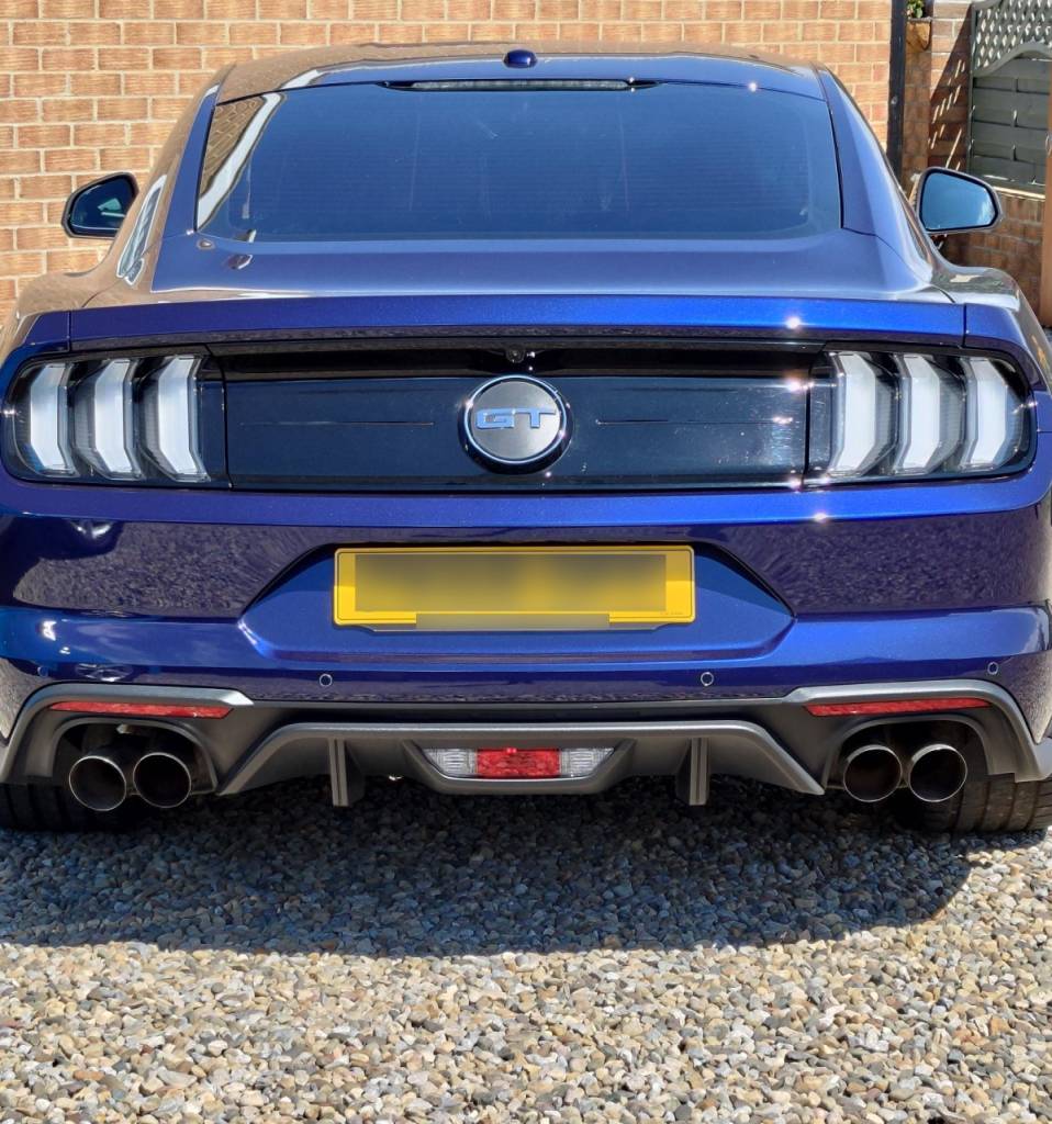

When I put my H pipe on I made sure I lined them up. But now mine looks like the pic you showed because I did a quick test of another style muffler and didn't like it so went back but was rushing and didn't take the extra time to align perfectly. its no biggie as I will be getting a welded in set soon. But this definitely comes from alignment with hpipe and clamps.

Amazing OK thanks. Annoying as I had a garage fit it for me. Hopefully get a look at it this weekend.
