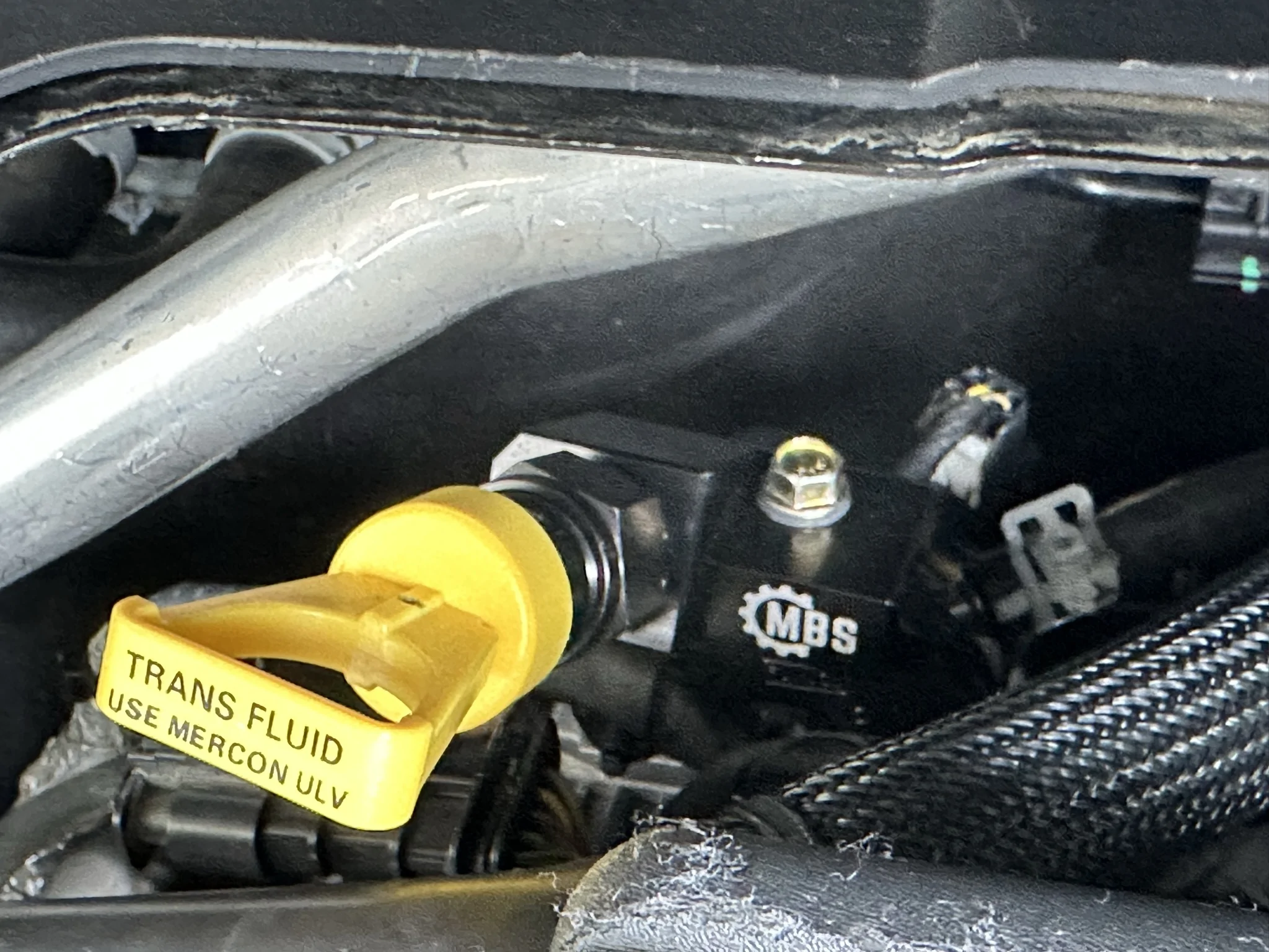

I have a small business making 10R80 automatic transmission extended dipsticks, am doing research on adding another Ford model to my product line (which is only the Ranger currently)
The Mustang I got my hands on today as a test mule to use as mock up to make a dipstick, was a crazy high HP job with the IMRC removed, so before I go developing a dipstick just for no IMRC applications, I want to see what the demand may be.
At this moment there are 400+ members viewing this forum, being the Engine Mods section, I figured this would be a good place to ask about the IMRC.
There are a few things going on here, the Mustang 5.0 with an engine cover, is out, unless the customer wants to punch a big hole or chop off a corner, the cover and the dipstick wont work together.
There may also be a chance the 5.0 with the IMRC installed will be too tight to squeeze my full length dipstick past, plus I have to have a good place on the engine to mount a top bracket.
The right IMRC actuator 3 bolt bosses in the intake are a good option for me to securely mount a top bracket, otherwise I have the threaded stud off the cam cover, maybe a lower manifold bolt (but the bracket would have to be very tall) I'd prefer not to use the sensor or the coil bolts, there is not a lot of options to mount it (please don't suggest the firewall, I want to keep it on the engine)
So that leads me to consider the IMRC delete application as a reasonable choice to develop a dipstick for.
The ones I make for the Ranger are a plug and play, accurate fluid reading right out of the box, the customer does not have to mark it like with my competition, that's a bit of a funny statement, I'm a micro business, I'm so small they don't even know I exist, but I make a high quality -10 PTFE dipstick, I get hit up all the time to make them for other Fords, Mustang, F150, Bronco, etc.
In fact a member here encouraged me to go after the mustang next, so here I am asking questions!
How many of you members yank out all that stuff at the back of the intake?
And of those who have, how many would have interest in a extended transmission dipstick?
If anyone is curious, they can look at the details on the Ranger one I make: https://mikesbuildshop.com/
Here is a pic, it bolts on a unused bracket on the Ranger, the Mustang would be similar design, except a vertical mount.
