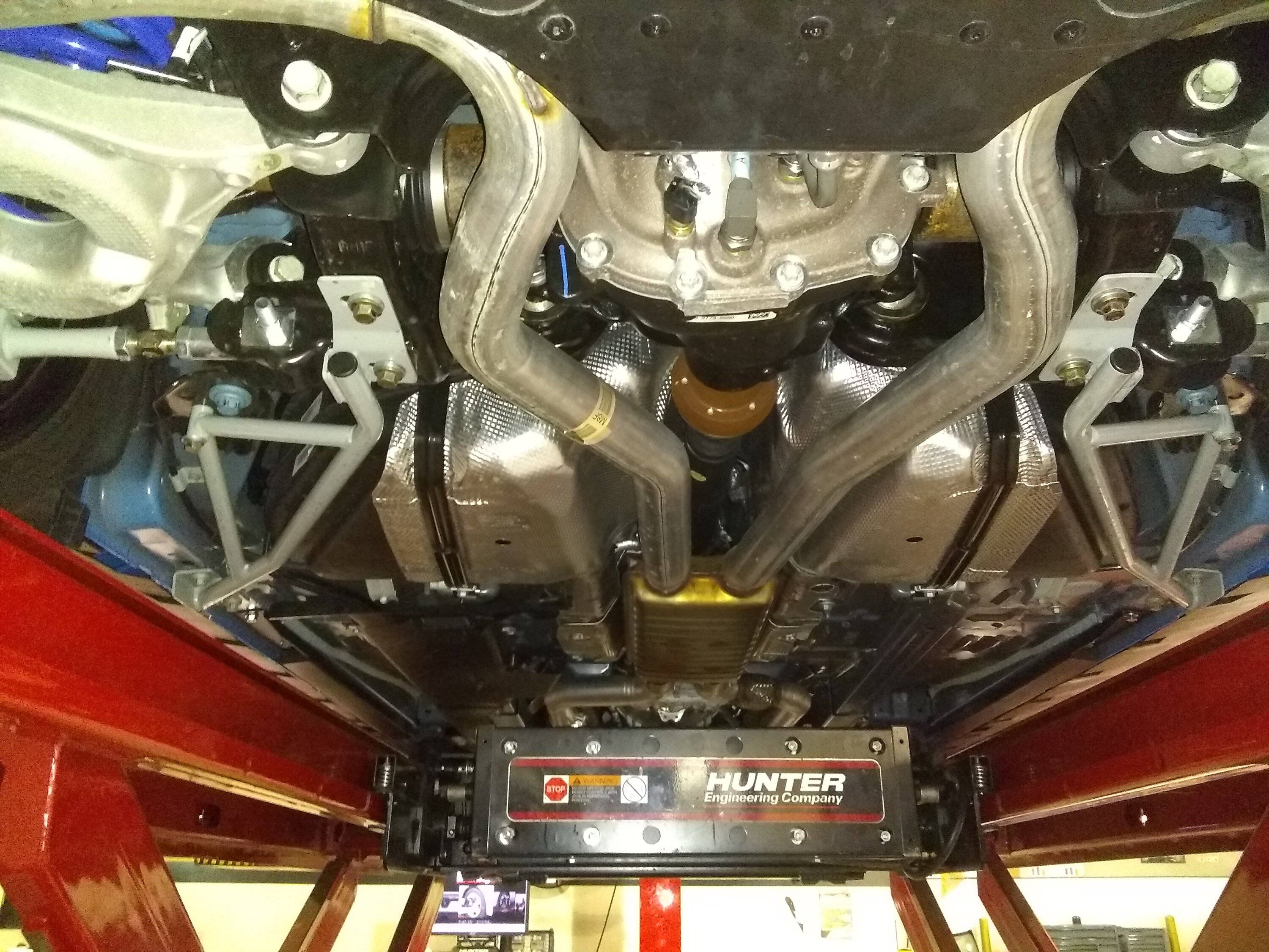

I've been trying to wrap my head around this. If the rear cradle is locked down at the four corners what is the point of the extra bracing? I'm referring to the long arm braces that Steeda sells. It runs from the side rails to the cradle. How is the IRS still moving if the rubber mounting points are no longer moving? Does this brace really make a noticable difference?

Steeda's bracing is gratuitous IMO at that point once proper bushing lockouts (BMR, Whiteline) are in place with also the alignment dowels.
@tosha with just the brace it's rather spindly I would assume flexes quite a bit esp at the bolt-anchor points since the slots are GIGANTIC. Plus the brace only controls fore-aft, and not twist or pulling away from the chassis anchor point. And it also doesn't address the BACK pair of IRS mounts.
