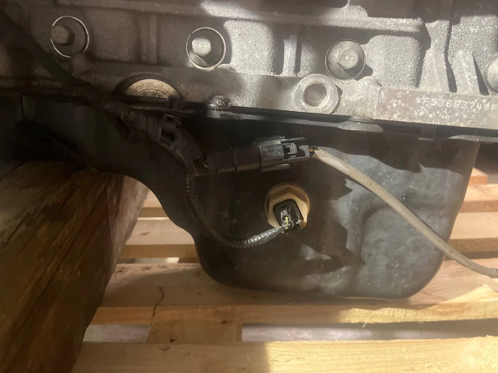

Appreciate the reply, here’s the picture. I figured it was just something between trims.

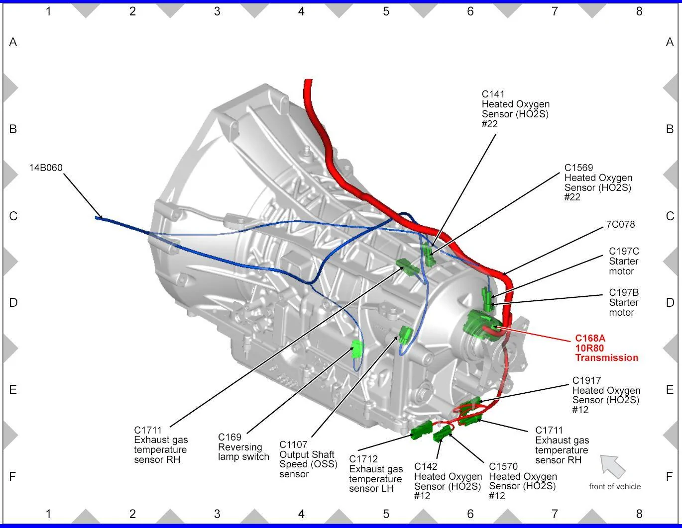

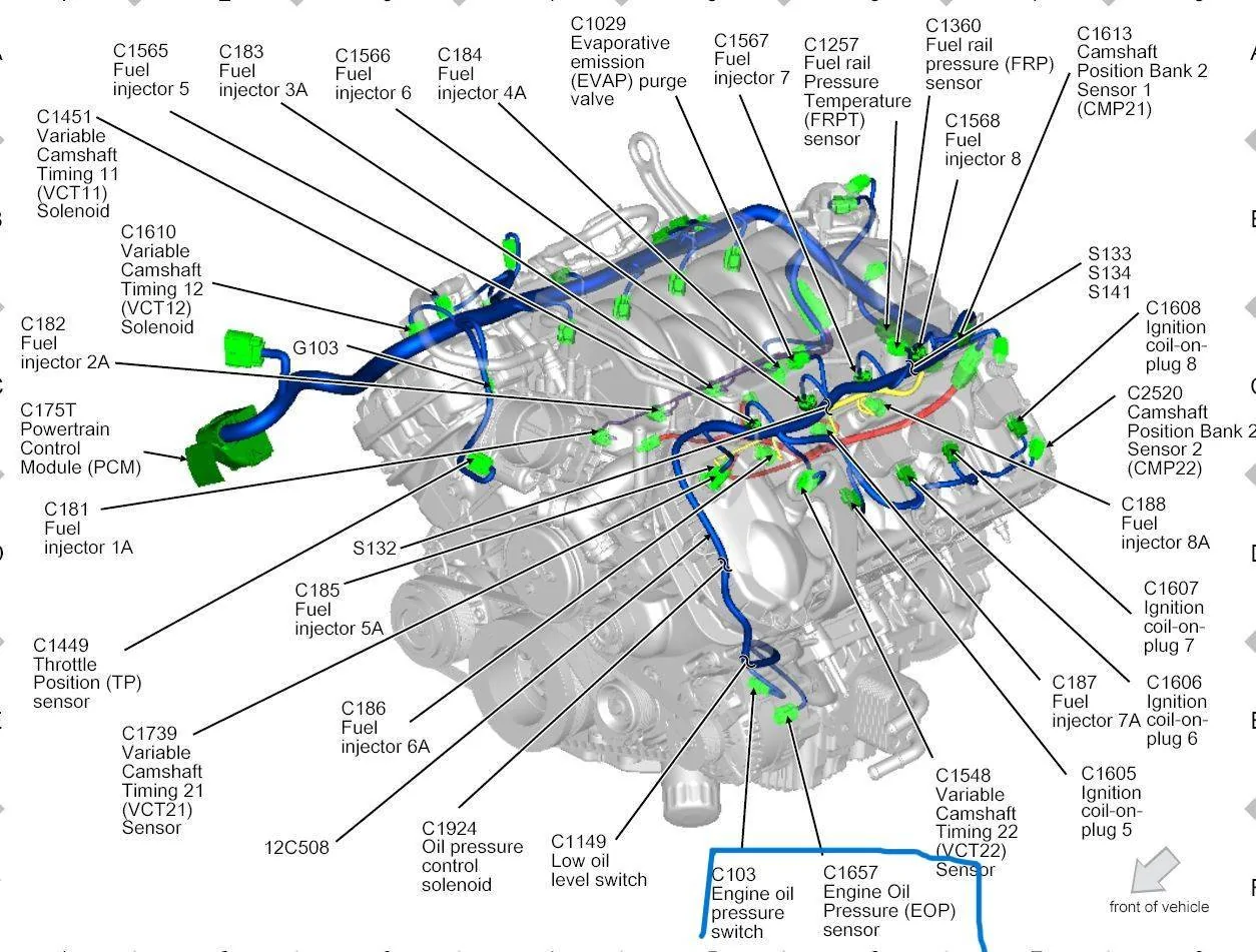

The following relate to a later year of the engine. IDK if they could be of assistance.
