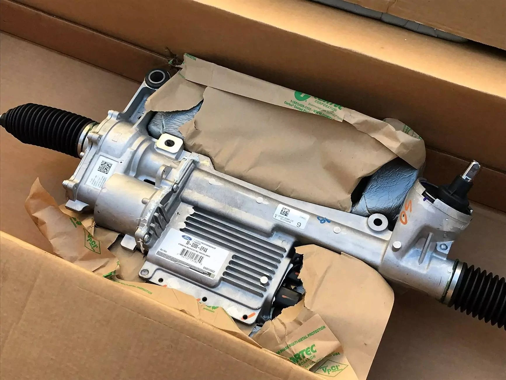

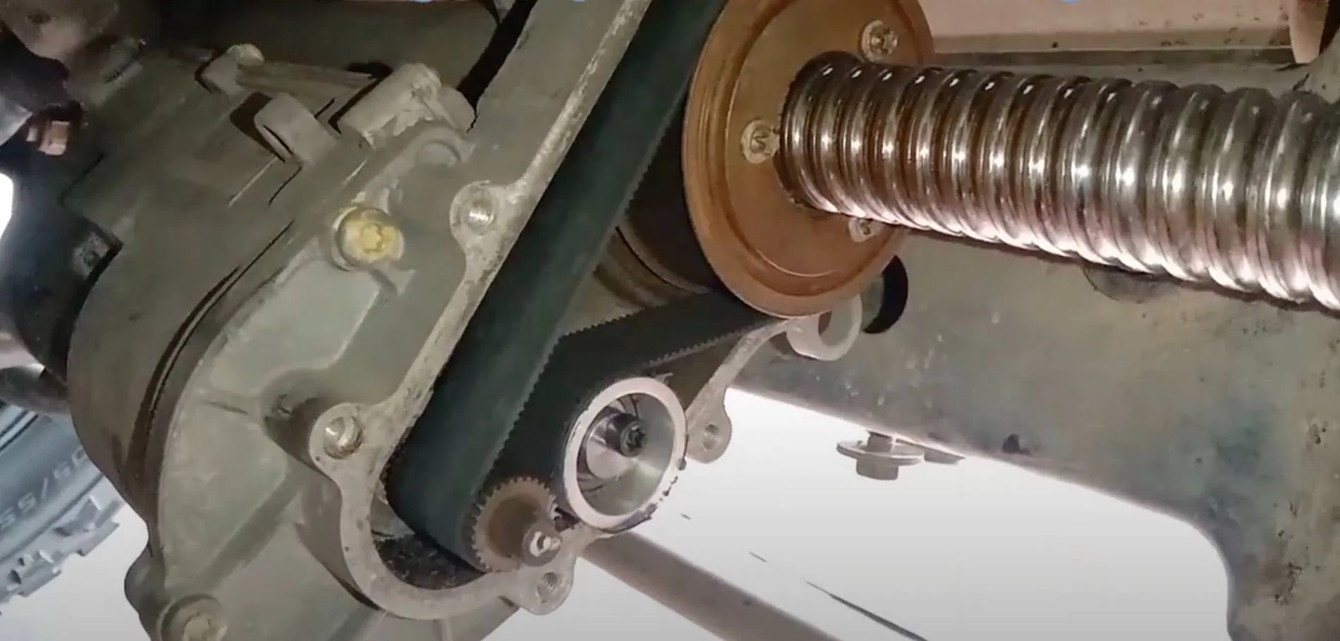

A simple explanation of Electronic Power-Assisted Steering (EPAS).
Edit,
Updating this post with two photos.
The first photo shows what a working belt and rack assembly look like. Notice the linear screw, for more precise steering.
The second photo highlights an entire EPAS assembly. To the far right, where the steering linkage connects. Center, the EPAS motor. Left, the belt attachment.
If the belt or motor fails, there is a fail safe mode, where the rack will continue to work, in manual mode.
