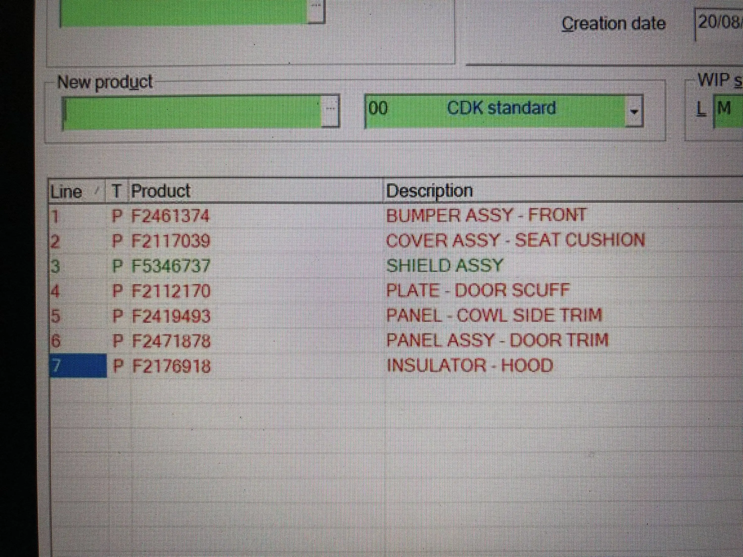

I know we are a little off topic now, but here are example ford U.K. part numbers from my recent warranty claim :
And some of my other warranty claims :
So the number of digits is correct and judging by the above, I think the chance of it being a letter ‘F’ on the front is quite high :like:

luc
Mar 25, 2018
2,244
2,575
CA
2017 GT with PP
WD :like:
Not sure why but obviously the invoice is not listing the full part number
Here is an example of complete ford part numbers
