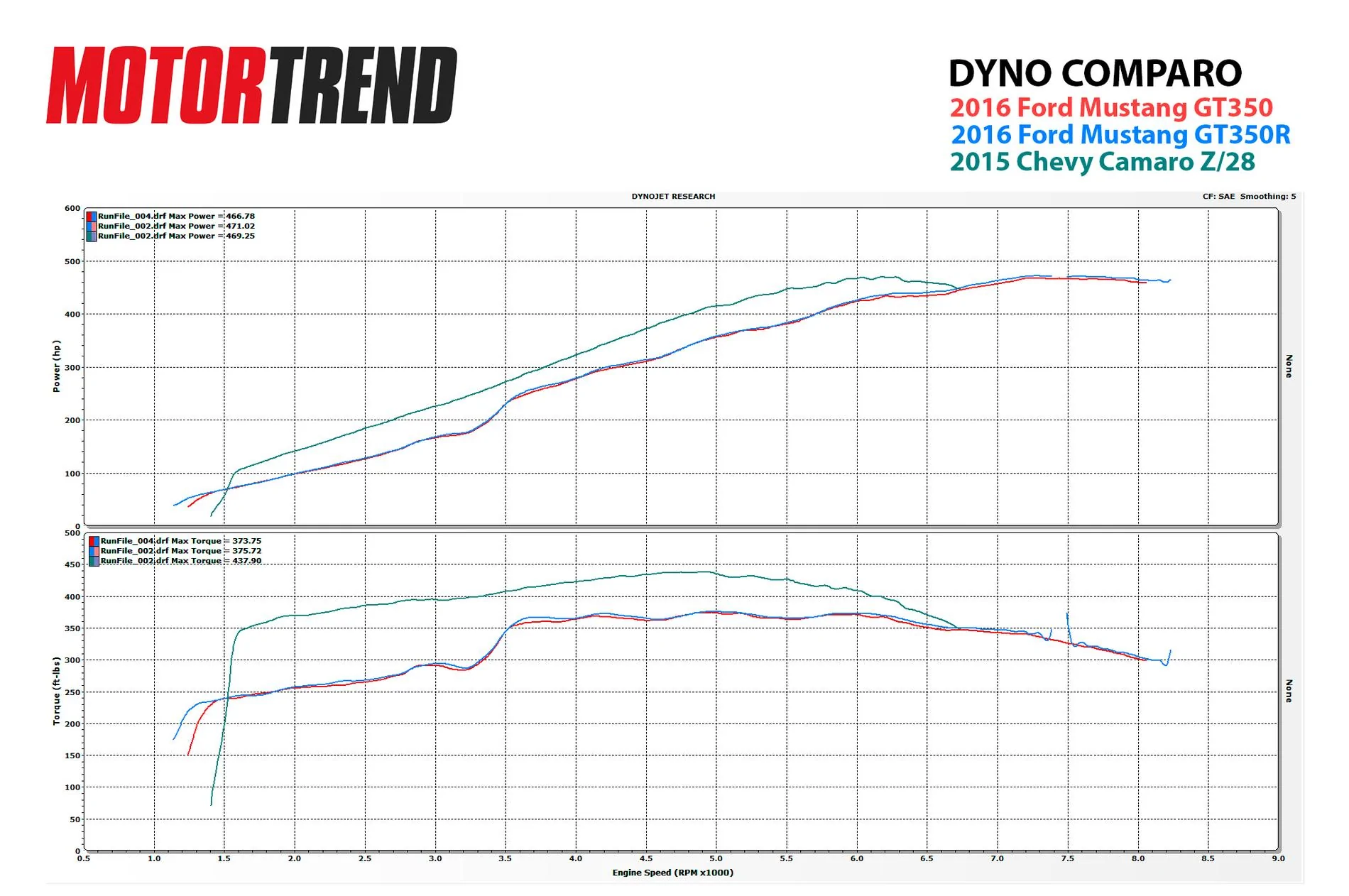

Now here’s the interesting part: 505 hp at 6200 rpm (7000 rpm redline), and 475 ftlb at 4800 rpm. Not exactly a low-end torque monster.
Yep, Voodoo cams plus Voodoo manifold means sacrificing the bottom for the top. It just means you stay ~1500 rpm higher in the GT350 than the Z/28 when you're using it. My Coyote feels significantly stronger than the Voodoo in regular street driving but on track that engine is lovely and very powerful.
LS7 vs Voodoo.. yeah, definitely not a low end torque monster
Oh I know, I was just replying to the low torque comments. I tried for a while to find an 18+ stock coyote dyno graph but just couldn't dig one up.Yep, Voodoo cams plus Voodoo manifold means sacrificing the bottom for the top. It just means you stay ~1500 rpm higher in the GT350 than the Z/28 when you're using it. My Coyote feels significantly stronger than the Voodoo in regular street driving but on track that engine is lovely and very powerful.
