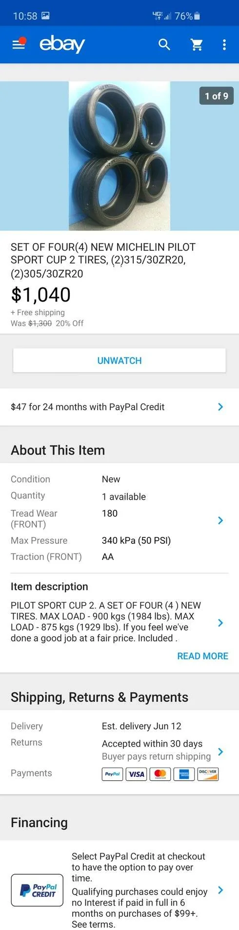

Today I purchased a brand new set of cup 2s for the street wheels I plan to buy. The set normally goes for $2100 at tire rack, but I got them off ebay for $1,000. They are late '18 model year tires. They still have the sticker marks on them (never used).

Most of all though is the PRICE you paid for a SET! HS squared! I'll have to remember that little tidbit.

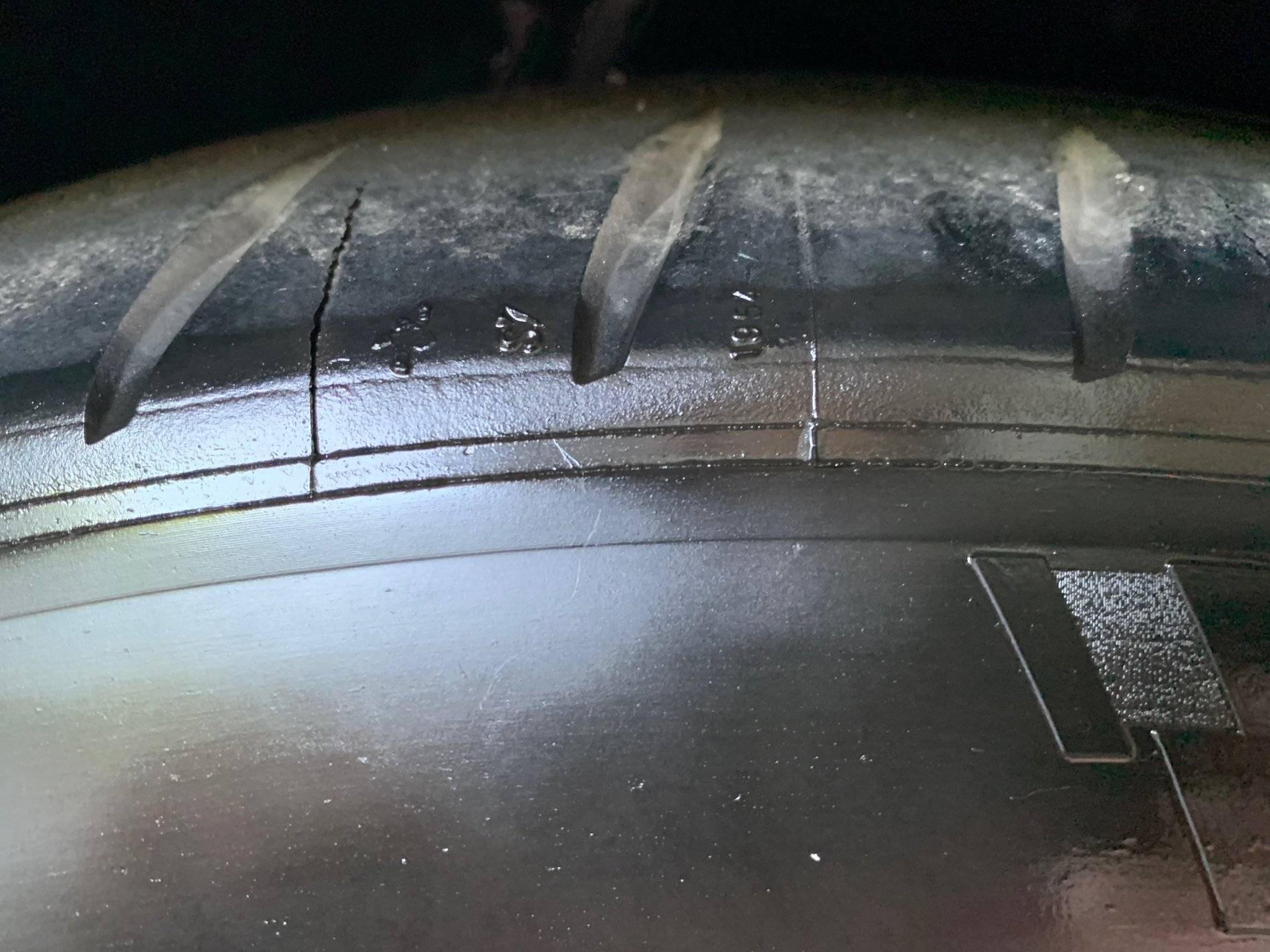

Don't be scared when the outer 'features' wear away. With them gone, there is still plenty of tread left. Michelin installed little rectangular wear holes in the outer shoulder (~3mm x 6mm) that you should use to determine how much tread you actually have left and when you need to replace them.

This is really good info. Does someone have a picture of what these wear holes look like? Trying to find them and I'm not sure I know what to look for. I see some markings here but can't make them out. Thanks!
