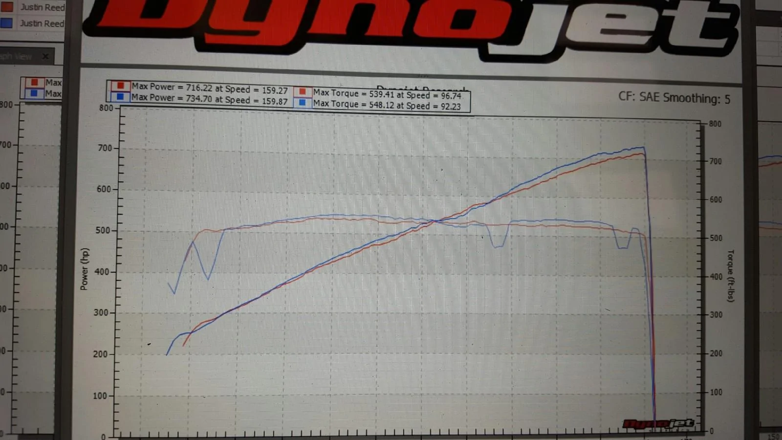

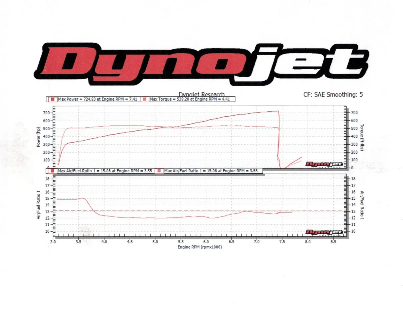

I hope to start working on and finish my new tune next week. After I finish my new tune, I will schedule time on a dyno. I'm looking to do 9 pulls. 3 on the old tune, 3 on the new tune and 3 with new tune + meth/water. I still won't be tuned for meth.
