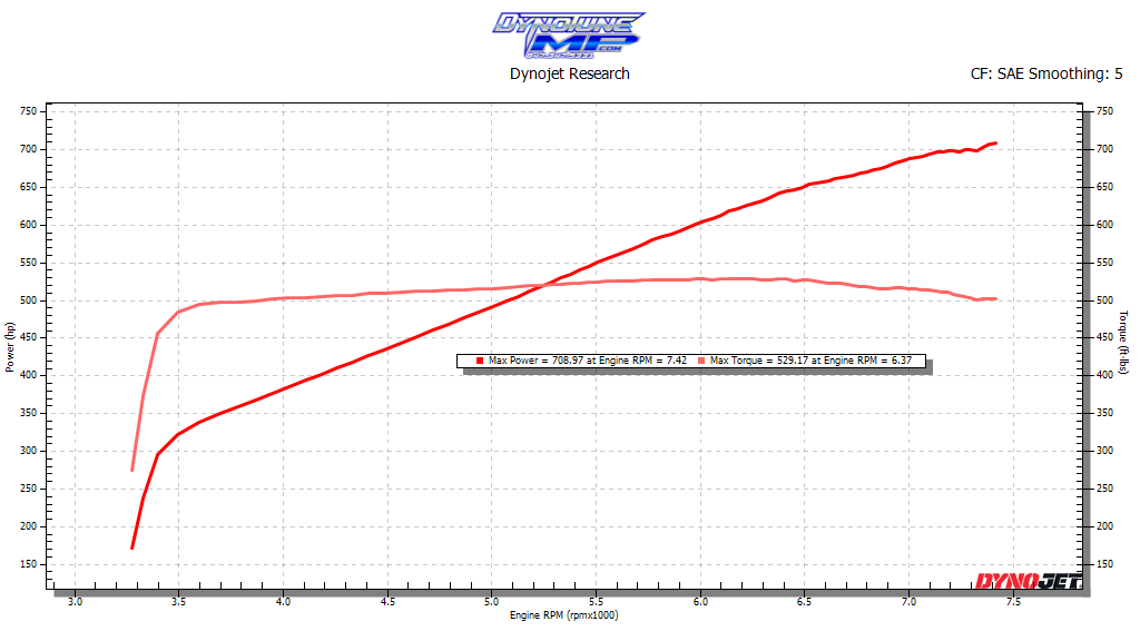

I had Gen5 Whipple stage 2 kit put on my car a month ago and finished my clutch break-in last week. Went back to the shop this afternoon to put it on the rollers. It completely exceeded my expectations!! This Whipple is insane! The pull was done in 5th gear and stopped just shy of 7500rpms to avoid hitting the speed limiter. Tried to first dyno it in 4th gear, but it just spun the tires too much.
Crazy the power never peaks and just keeps going up! Whipple tune on 93 octane and the 3.875 pulley the kit comes with. I did put a splash of Boostane in the tank as I’m not sure if we’re still on winter fuel around here or not.
Big shoutout to Mike Post at DynoTuneMP for all the great work installing the kit. Anyone in the Chicagoland area that needs anything, Mike is your guy!
Mod list for my car besides the Whipple: OPG’s/CS, QA1 carbon fiber driveshaft, LPX clutch, Borla Touring cat-back, GForce Renegade axles, Steeda stop the hop kit and vertical links.
Here is the dyno graph: 708.97 / 529.17
ALL YOU GUYS IN ‘THE WHIPPLE WAIT’ THREAD, THE WAIT IS WORTH IT!!! :rockon:

Very impressive! I have the same setup as you except stock exhaust. Mine made 650 at 7500 but in 4th. I also dynoed in 5th and it tracks yours almost identically but I stopped at 5500.
Anyway, congrats!

You have to wind it out! I’ll bet a 650 hp (rw?) supercharged big displacement LS will make a ton more torque/power in the low and midrange, but if you raced you’d be up where you’re making more power and gapping him big time. Look at J17GTs torque curve, super flat, which can be deceptive even if it’s up there. My own experience in these cars is linear power rather than massive low/midrange thrust, but they get scary fast very quickly.
