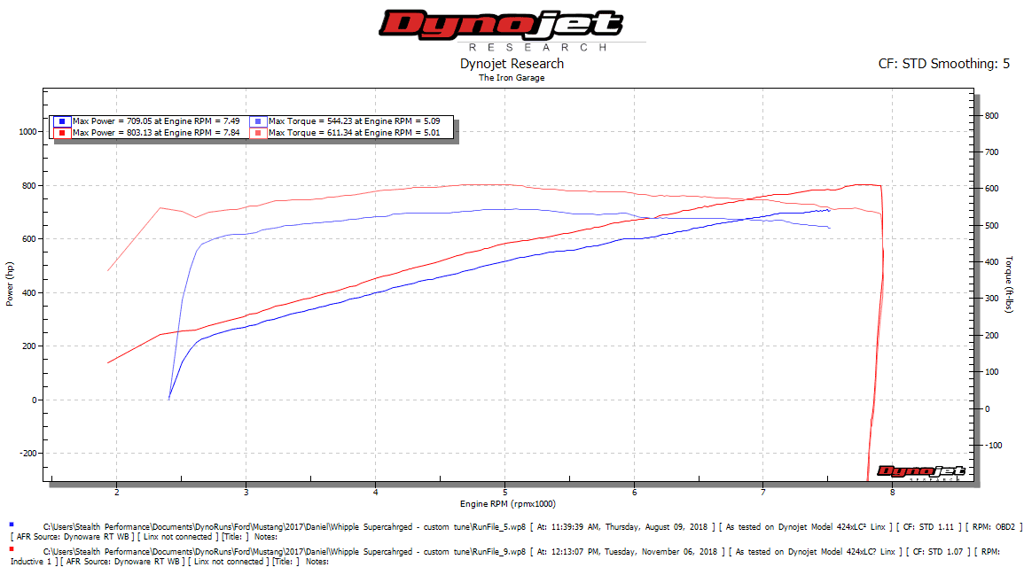

Platinum_5.0
Jan 8, 2018
425
197
Edmonton, Canada
Daniel
2021 10R Whipple
Here is a comparison of my car. The graph shows when I had the stage 2 Whipple, 94 pump and 3.75 pulley. Stock headers and cats. Second line is after LTH and 3.6 pulley. I know the pulley is added to the equation but maybe it can give you an idea of what longtubes did for me. Both dynos were on the same dyno, dynojet and 94 pump. NO changes were made to the tune.

Great example,the pulley drop would equate to about 25 to 30 rwhp.With the tune being the same tbe only otber thing that would affect this comparison is the outside temps.If they were close to the same it would be a fair comparison.

Is this with or without cats after LTH install?
Wow!
So if pulley change picked up 30 whp,the remaining 66 whp gain would be from LTH and weather ?
Got me thinking now about at least deleting my cats/LTH . If it will pick up another 30-40 whp I may be at about 900 whp on race gas/3.5 pulley
