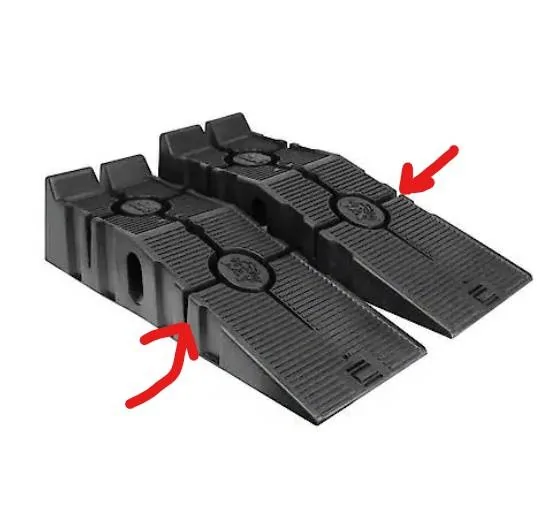

I have a set of Rhino Ramps. I tried to put my EcoBoost on them. A piece of plastic hangs down from the wheel well liner, in front of the tire, like a splash or rock guard, but in front of the wheel. On each side, this catches on the Rhino Ramp in those crevices and pushes the ramps forward at that point. I bought those posted above from Harbor Freight and will try them tomorrow. Unfortunately, I don't have the room to use my big floor jack in the garage I rent from my apartment complex, and they don't allow vehicle maintenance outside the garage. So, ramps it is. I don't have the patience for a regular scissor jack.

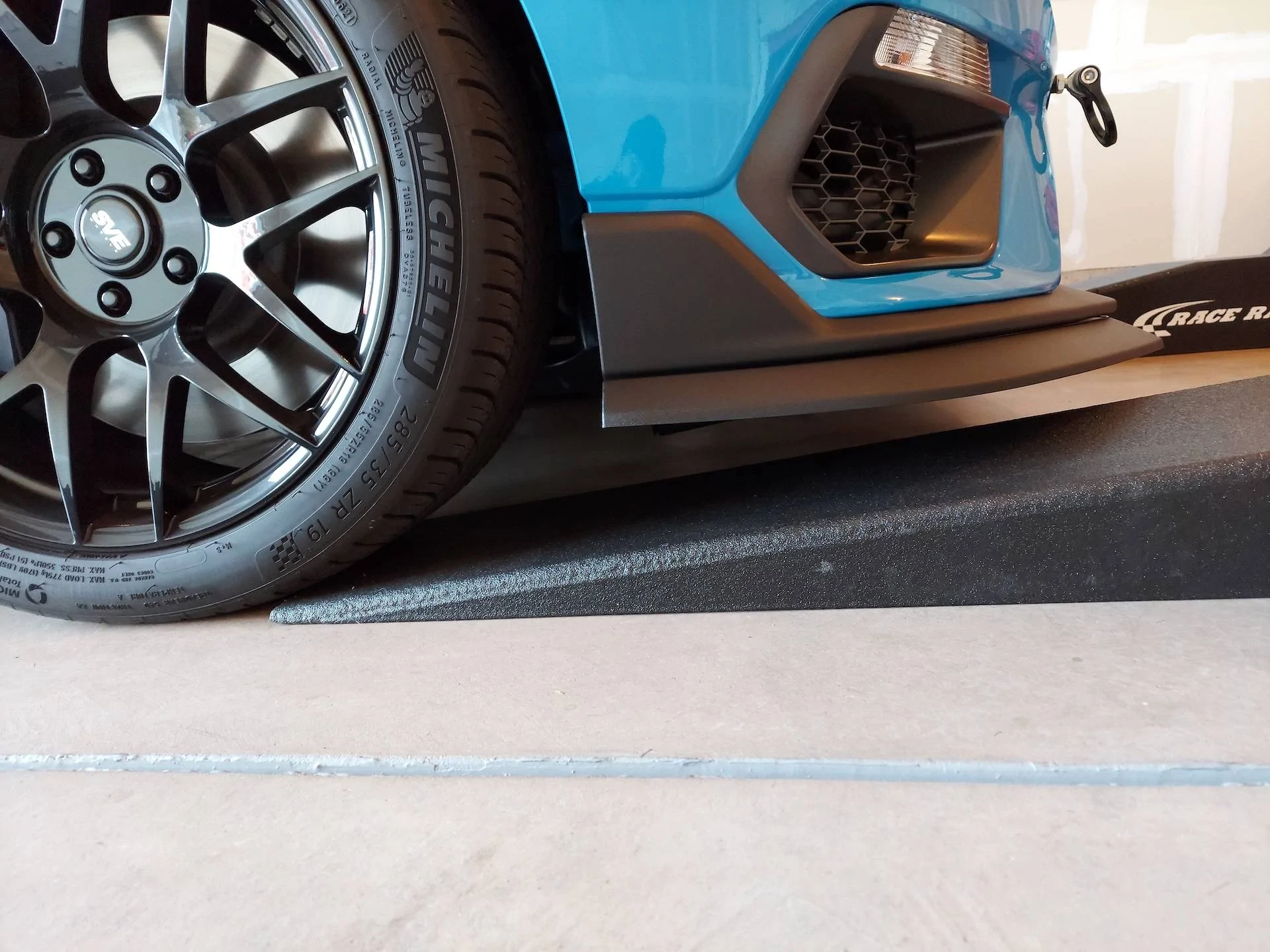

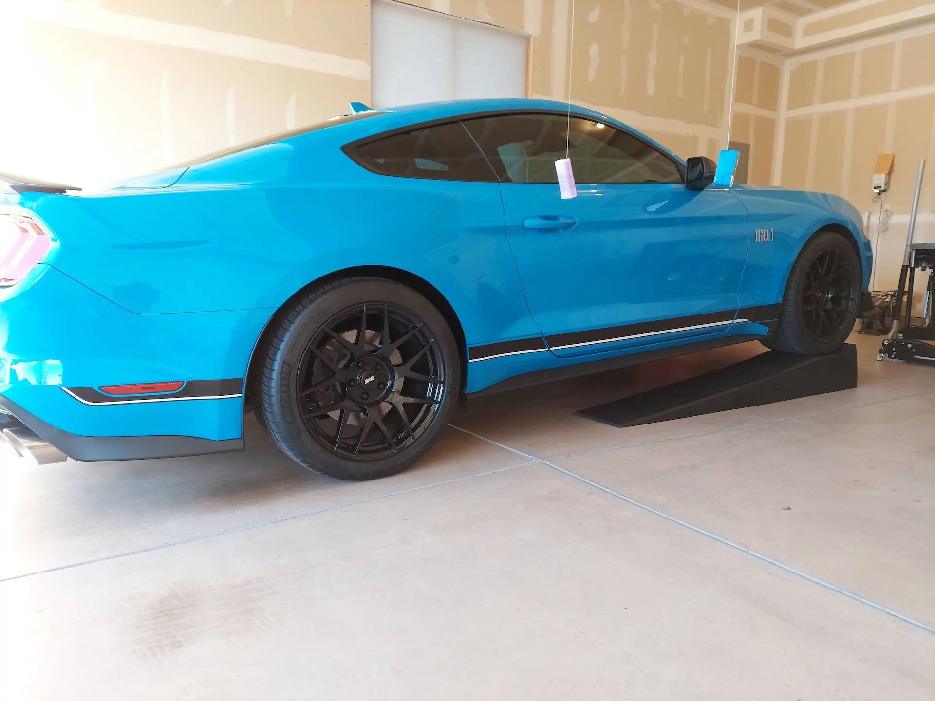

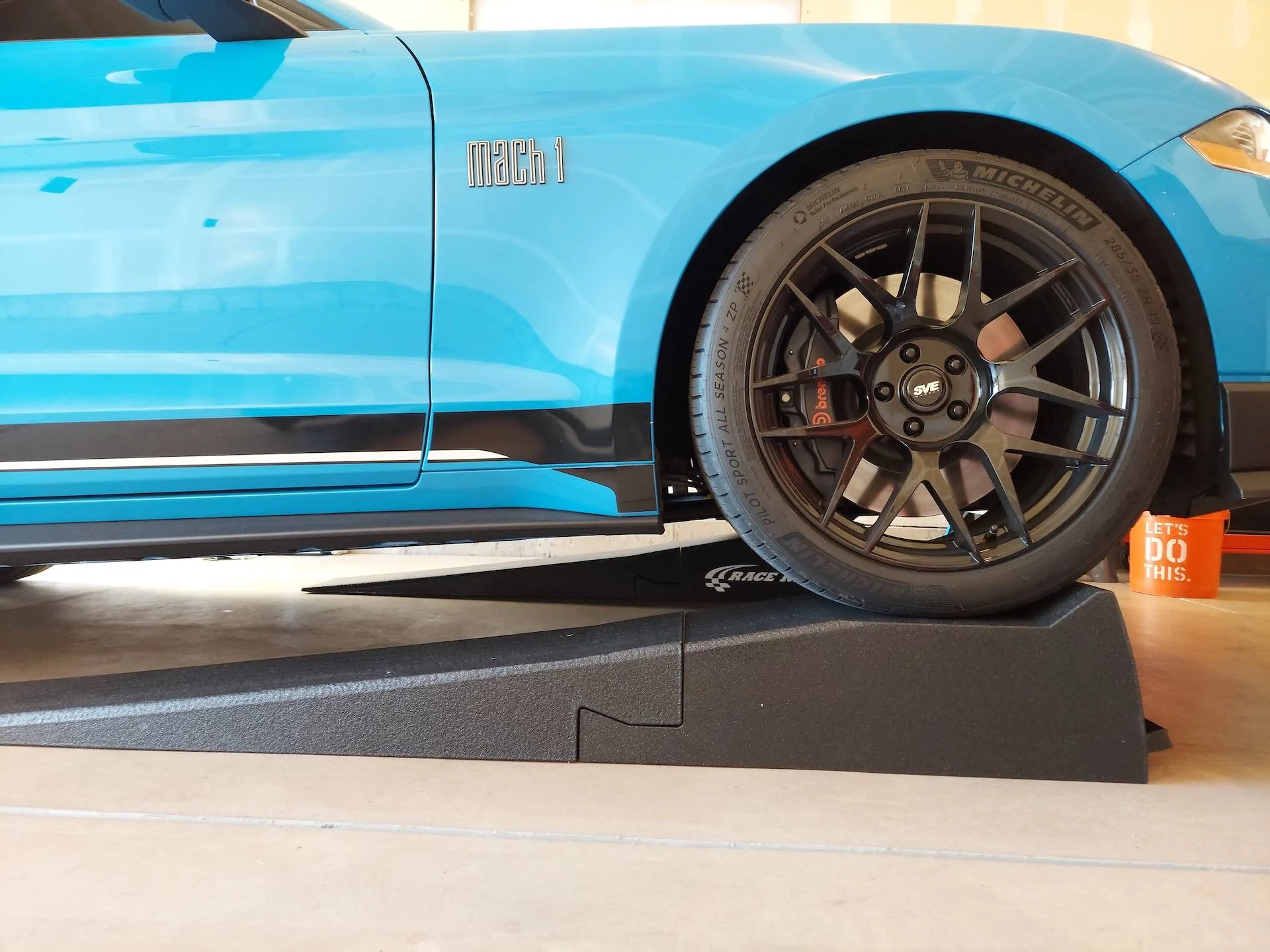

From comments and quotes within another thread, this morning I performed some training, product review and demo for Race Ramps.
The car: 2022 Mach 1, HP.
The tires: 285/35/19.
The product: https://www.raceramps.com/garage-service/ramps/race/p/rr-72-2/
Like most, I have a jack and stands. As I was getting ready for Skye, Race Ramps seemed like a good idea, that they might give me certain advantages over a jack for some things.
The Ford Mach 1 Supplement references towing and refraining from grades greater than 7% for an HP. The referenced product meets that requirement.
I purchased the ramps and stowed them. Until this morning, I'd never tried using them.
I noticed some were interested in how well they would work, so I tried them out today.

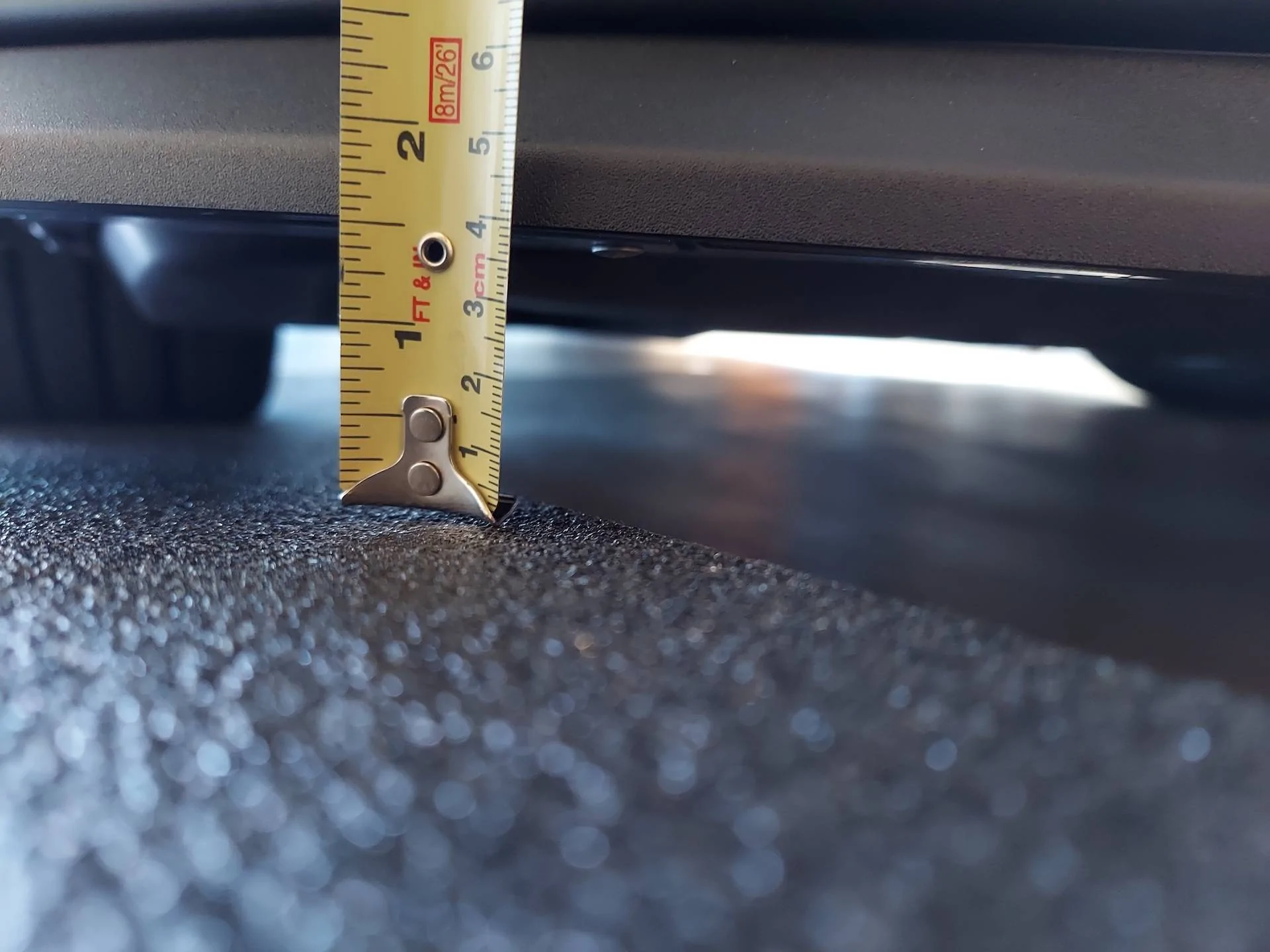

Yes, they work just fine. No issues. But do take note of the tire used above. The ramps are listed as having a width of 12" / 305mm. I most often use a 285 tire, which gives me room to spare. I also have a bit taller of a tire. While I had 1.5" / 38mm of clearance on initial entry, you might have something closer to 1" / 25 mm.
1. Put the car in a place where you want it, compensating for driving up onto the ramps. Ensure the ramps will be completely flat, on a flat surface.
2. Take one end and butt it against a tire. Using a measure, find a square point of reference and make sure the ramp is true, that it's not pointing left or right.
3. Do the same with the other ramp, using the measure to square it with the other, trued ramp.
I realize there will be some instances where you just eyeball it. You can do that. I realized while I was thinking, I could be off. Before using the steps above, while things looked "right", I checked the ramps; they were splayed outward by 1.5" / 38mm; this could have been fatal to the car.
4. Drive up. You'll notice the lip so you don't drive over. I simply drove onto them like entering a driveway. I actually used the gas a bit to "press" against the lip. Things went well. The surface is textured for traffic. No slipping.

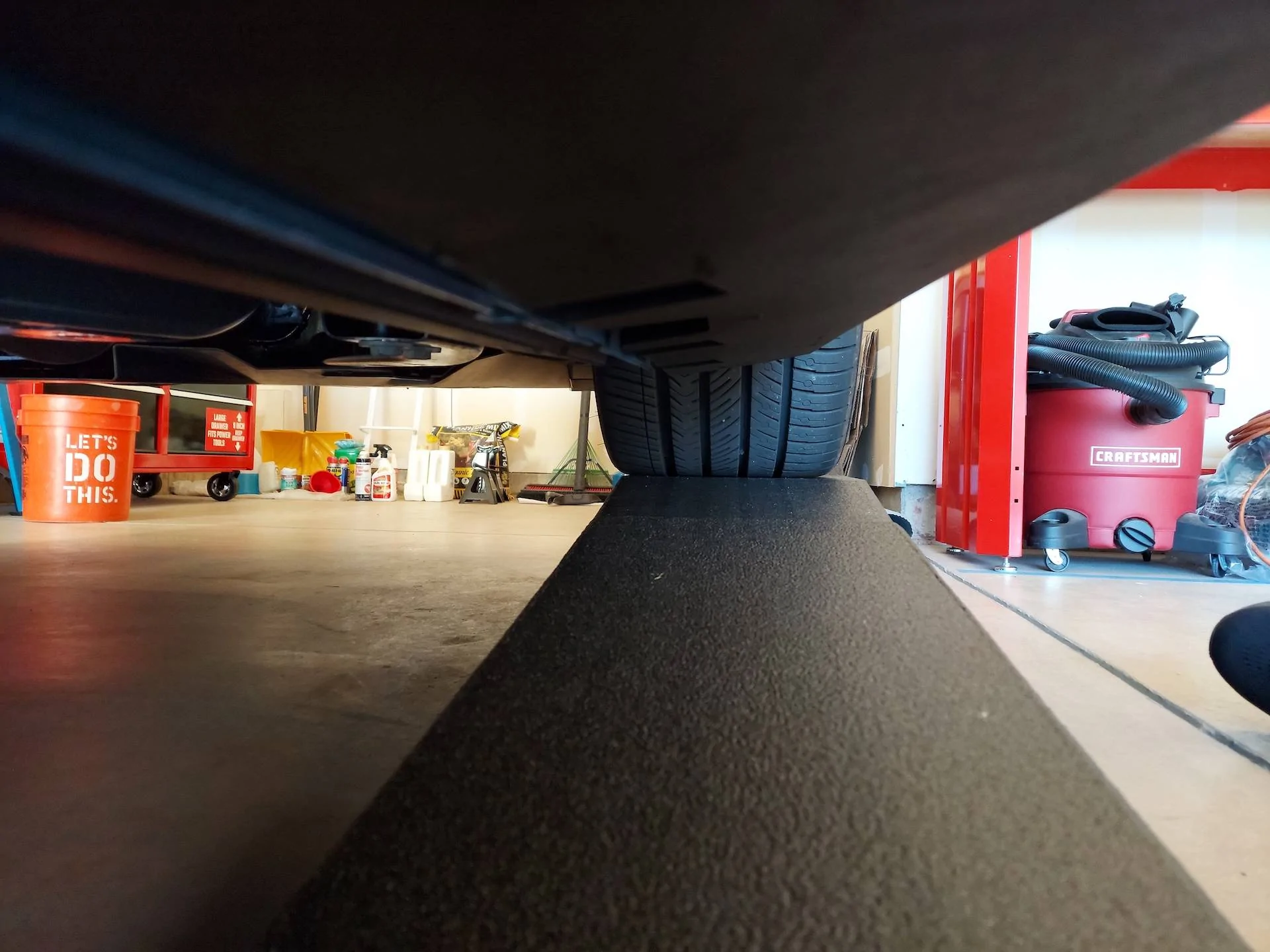

I was left with about 18" / 457mm of clearance. No obstructions. And I can remove part of the ramp for even more space.
