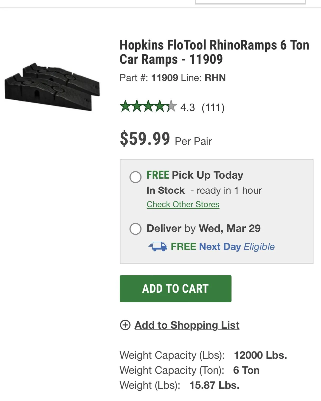

You don't want plastic, but you're ok with 4,000lbs on $500 foam ramps? Lol. I'm sure they're fine, but at $500 vs. $50 - $60 I'd take the rhino ramps all day. I have them and use them on my V8 4runner with zero issues. I also have a 4 post lift and find myself using the rhino ramps 99.9% of the time just based on how quick and simple it is verses jockeying things around to get the cars on the lift.
Just a mental thing with me LOL. I hear plastic (and I’m aware it’s more composite than plastic) and it scares me off. I have first hand experience with my neighbors race ramps so the foam is ok in my mind (and yeah my mind sometimes makes zero sense LOL)

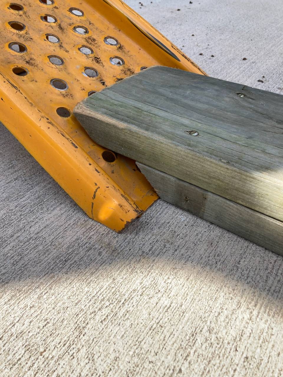

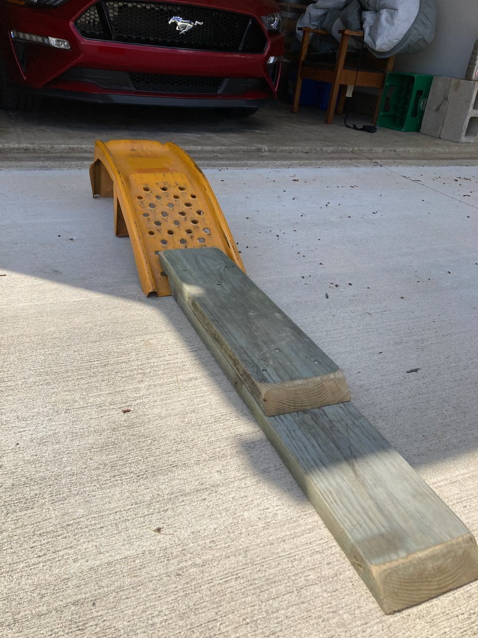

I already had a set of heavy duty steel ramps for working on my F150 trucks. Was surprised that, even at stock height, the ramp angle was too much for my mustang.
I had some treated 2x6 lumber handy so I built a quick workaround. Made sure to sand the edges so no worries about cutting into a tire.
Works well, easy storage and can’t beat the price (free!)
These truck ramps give me good height and an abundance of weight capacity
They may have had an abundance of weight capacity when new, but that buckling on the vertical gusset on the front, along with what appears to be a bend in that vertical support (see the daylight under the curved part) would worry me. I know they have worked and it sounds like for a variety of vehicles over a long time (those look well aged), but I would toss those and get a new set before a catastrophic failure occurs. Admittedly, I like the plastic ones more on personal preference than anything else, but that one in the picture is compromised and I would replace it if I were you.
