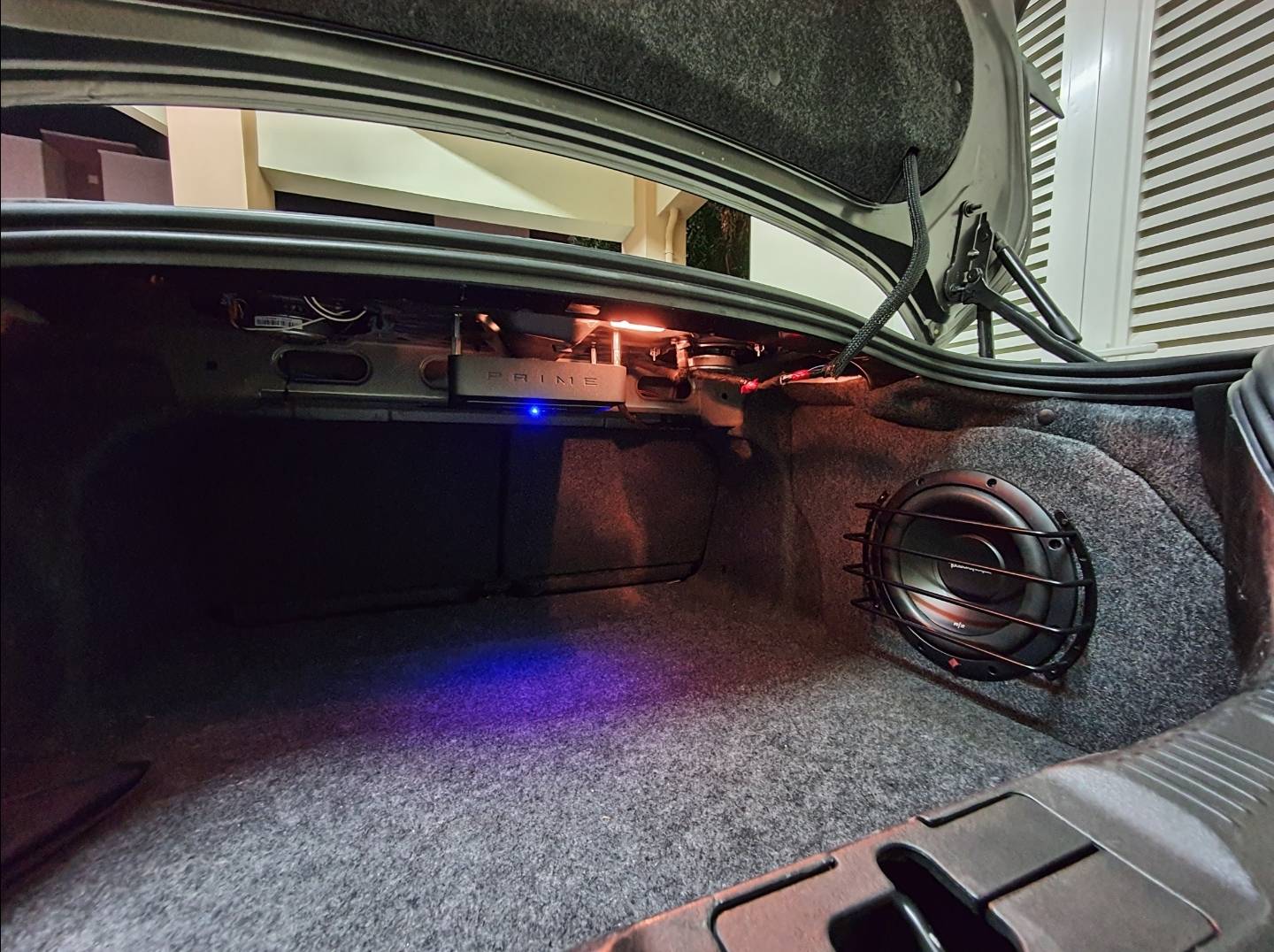

That is clean and out of the way

I would 100% recommend placing the sub in that cubby hole on the fender well. Either custom or prefab, it allows for full use of the trunk, which I have needed several times since installation. You won't get windshield cracking bass though.

I do not need that much bass

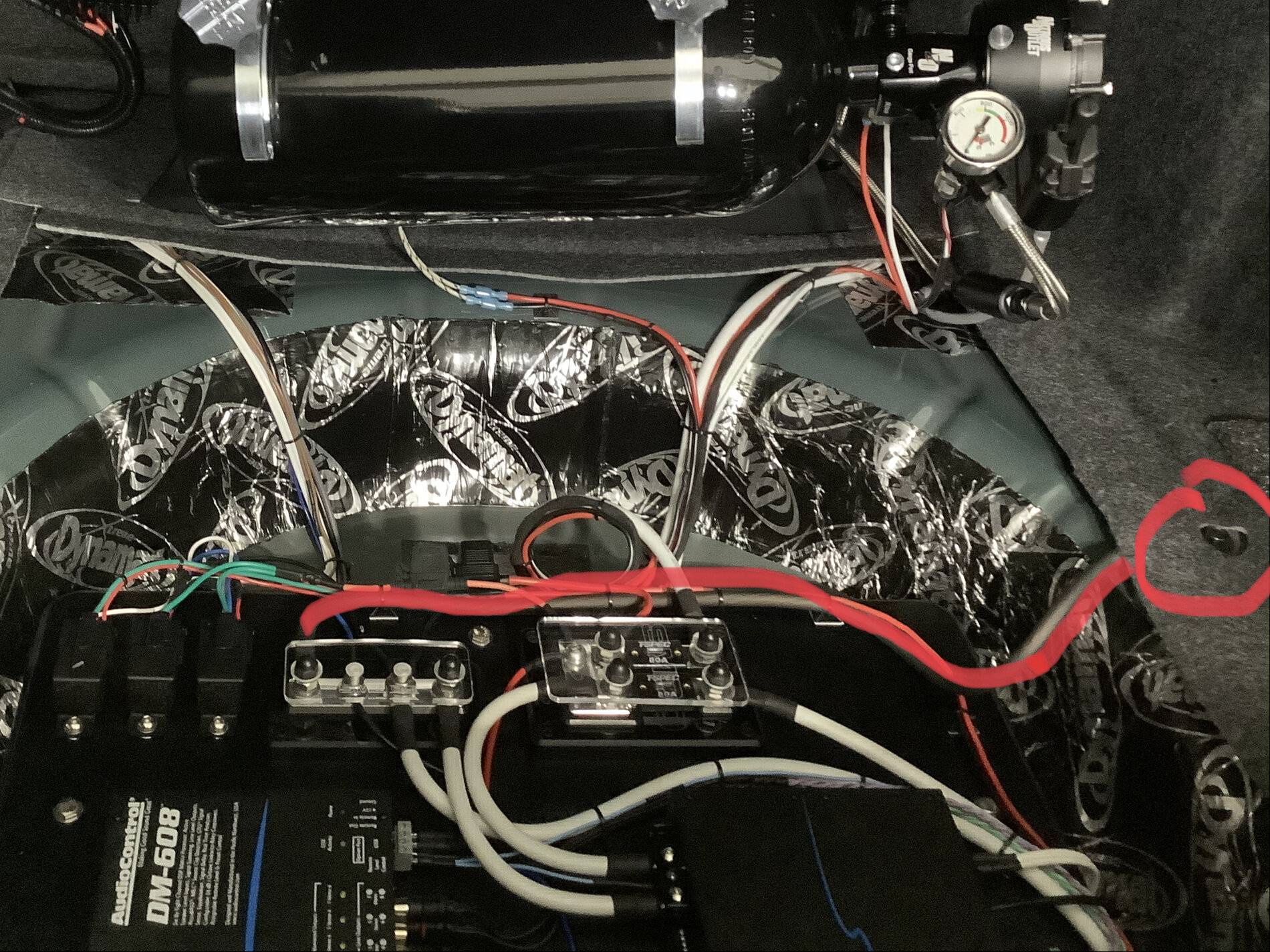

Where are u guys grounding your amps. I put my ground at the center seat bolt. I was having protection problems with my amp, it keep shutting down,, so I emailed mtx and the guy basically called me stupid for grounding it there. Says that it's the most common mistake he sees. But most of the threads I've seen say use that or the spare tire mount. The first email response he says u can't ground where is a fuel cell underneath and fuel wiring. And then the next emails say they use different metal there and it not as conductive. Has anybody else heard this, I find it hard to believe they are using different sheet metal under the rear seat. BTW, I grinded more paint away and it's working fine now.

A lot of people ground there. Hmm is the fuel tank plastic or metal lol. The important thing is to strip the paint off that bolt.

Here’s where I connected my main ground wire. I then branched off of the distribution block to hit the amps.

Good one. :rockon::rockon:
