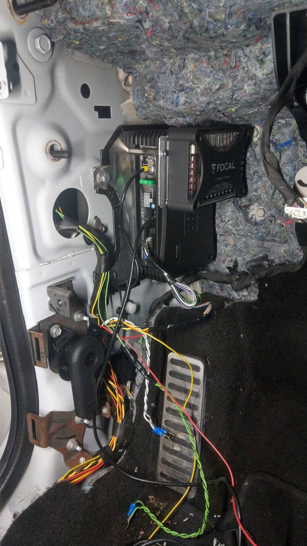

This is how my setup looks with the dash removed:
I built a custom plate, mounted it in the default location and added the amp and the crossover. The space is tight but it is all possible without removing the dash.

It is definitely possible and that's exactly what I did. I run all 8 speakers from that single amp (no center and additional amp for the sub).
You don't have to replace the stock amp, but doing so, gives you more space for the new amp.
Removing the stock amp will eliminate noise cancellation and the fake engine noise (I guess).

You can change the outputs from speaker level to line level even on the base ACM. Or you can run an amp which accepts speaker level as input.
My amp accepts both depending on the configuration.

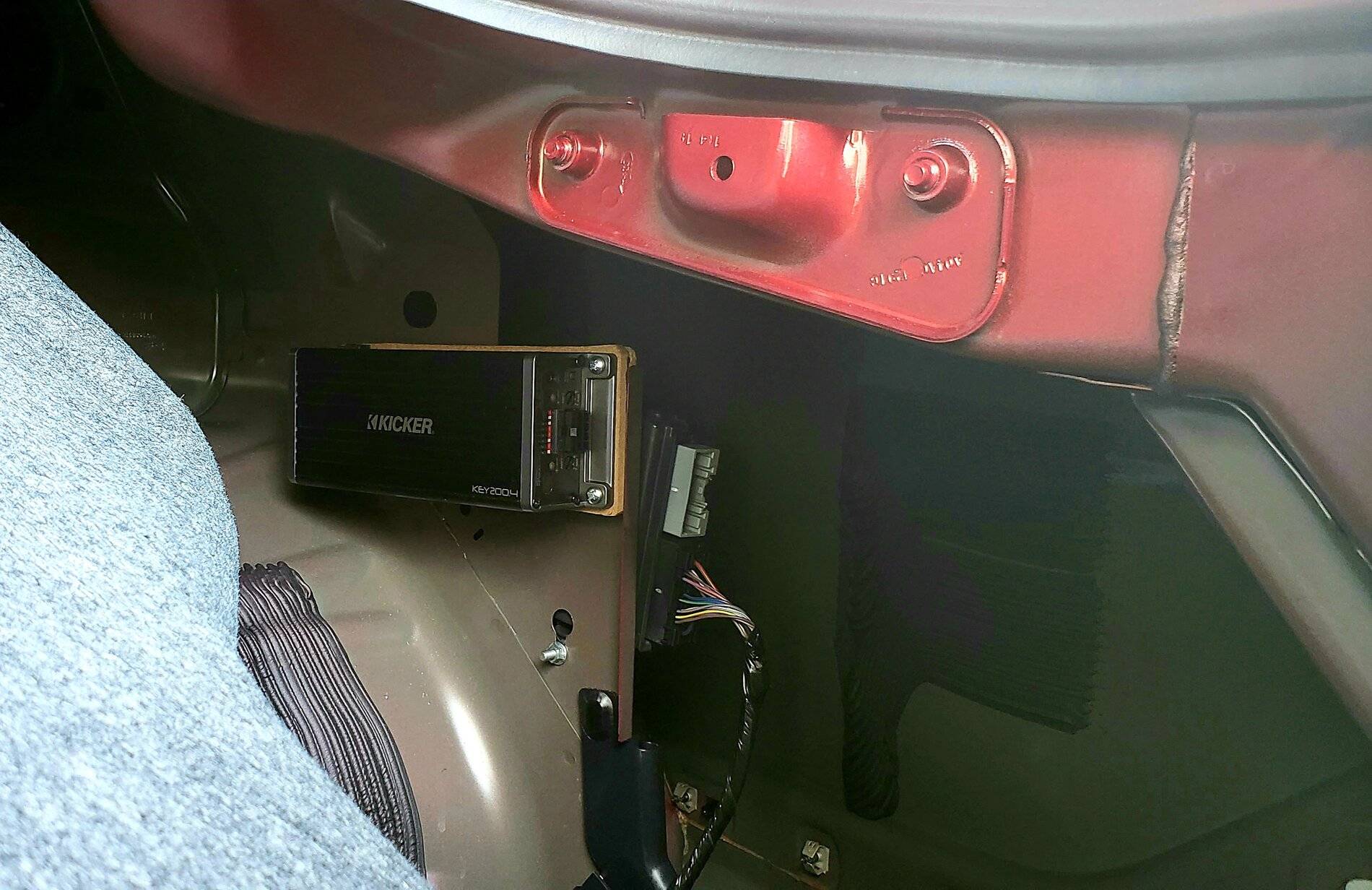

Where I hid mine.. Back in the trunk by the bcm behind the carpet. Easy to adjust if I need to. Ran 2 runs of 9 cuductor to a T harness behind the acm
