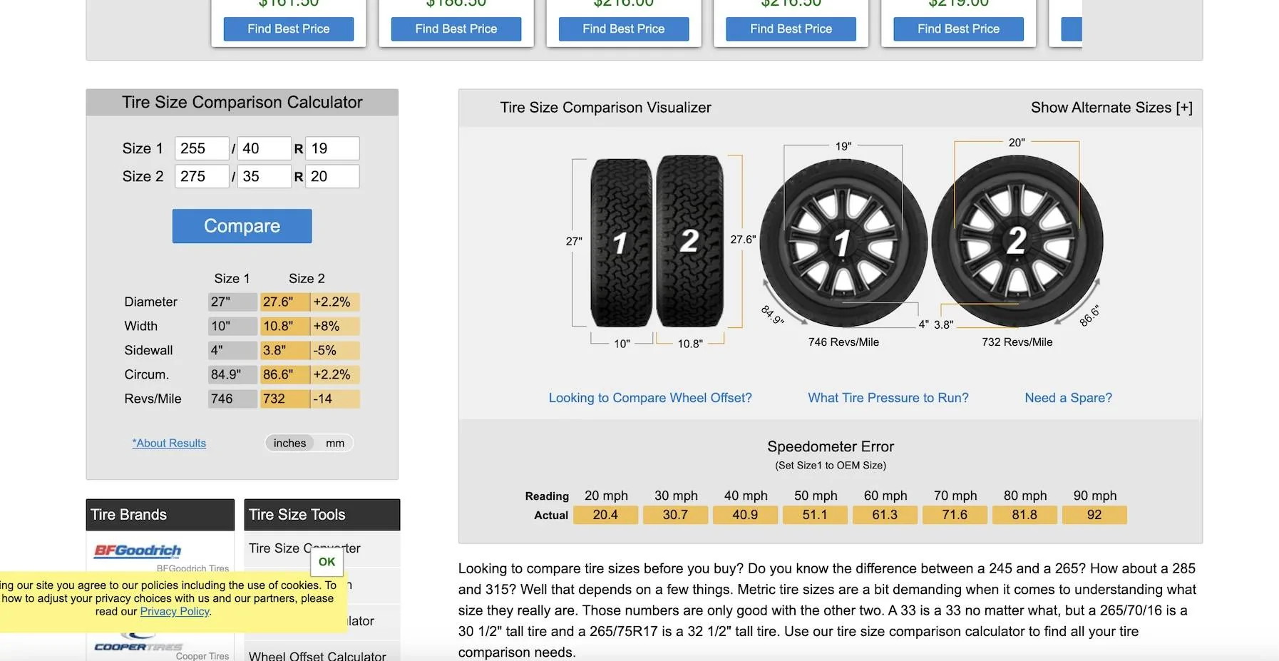

I'm going to review some things, to double-check.
Front, current tire: 255/40/19.
Front, new tire: 275/35/20.
Front, new rim: 20x9, +35.
Rim size appears OK, for the car/tire. Tire size appears OK for the rim. And the new tire is +2..2% larger in circumference than original.
Michelin sells a 275/35/20 in their All-Season 4 tire.
Continental sells a 275/35/20 in their All-Season DSW06+ tire.
You might have your own tire vendor in mind.

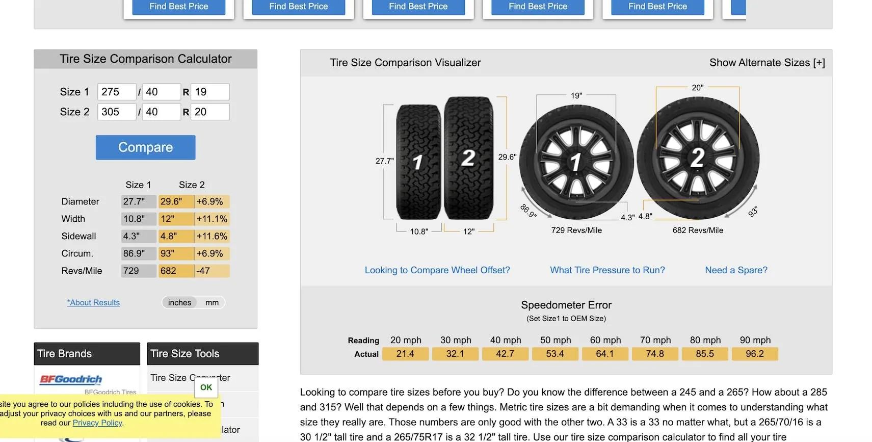

Rear, current tire: 275/40/19.
Rear, new tire: 305/40/20.
Rear, new rim: 20x10.5, +40.

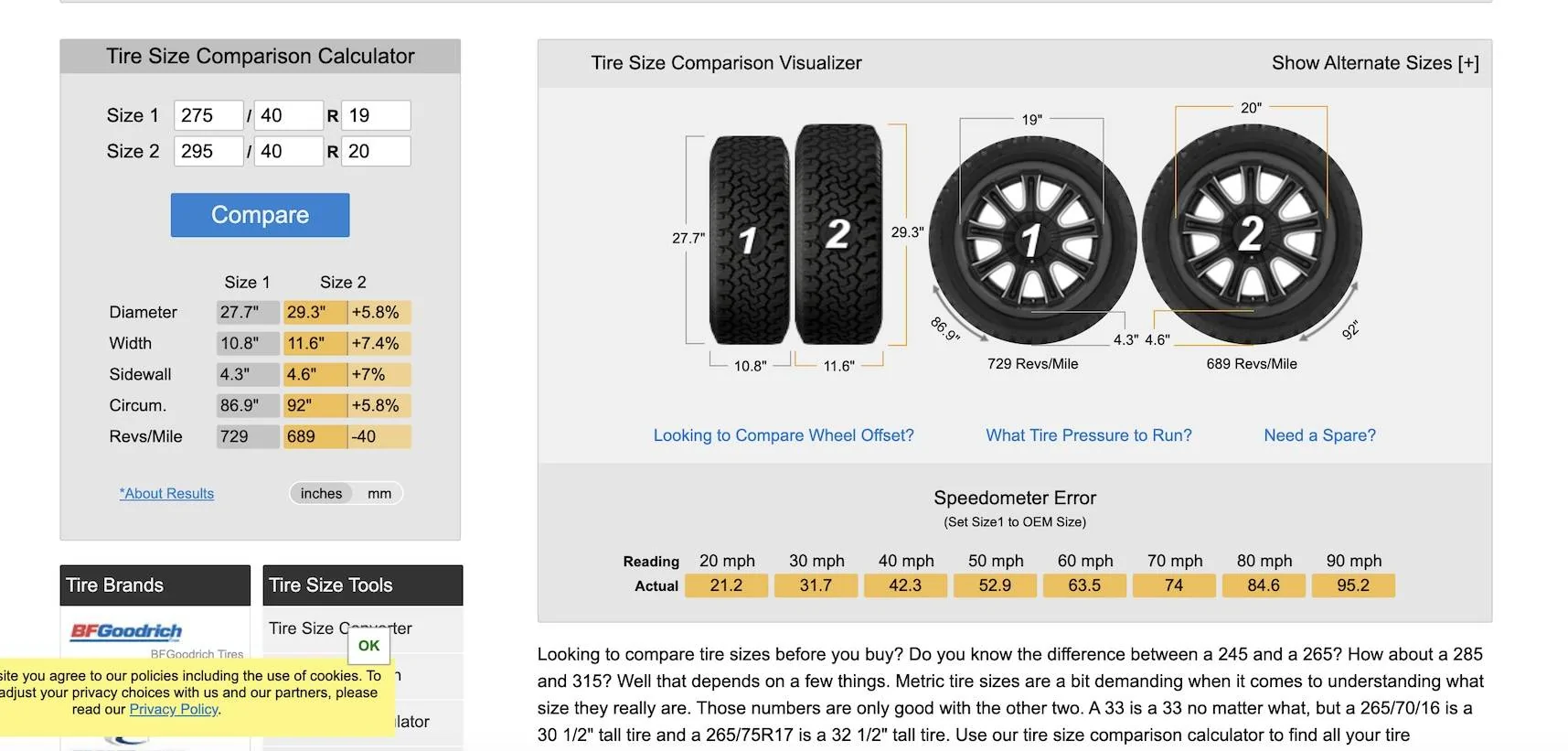

I consider the 305/40 a fail. The 305 tire is 6.9% taller than the original.
A 295/40 is also a fail, at 5.8% taller than the original.
The chart I'm using, a 295 wide tire is considered the slimmest tire to place on a 10.5" wide rim.
I checked Michelin and Continental for a 295/40/20 or 305/40/20. Neither make an A/S in these sizes.
In summary, proposed front looks OK, but the proposed rear does not.

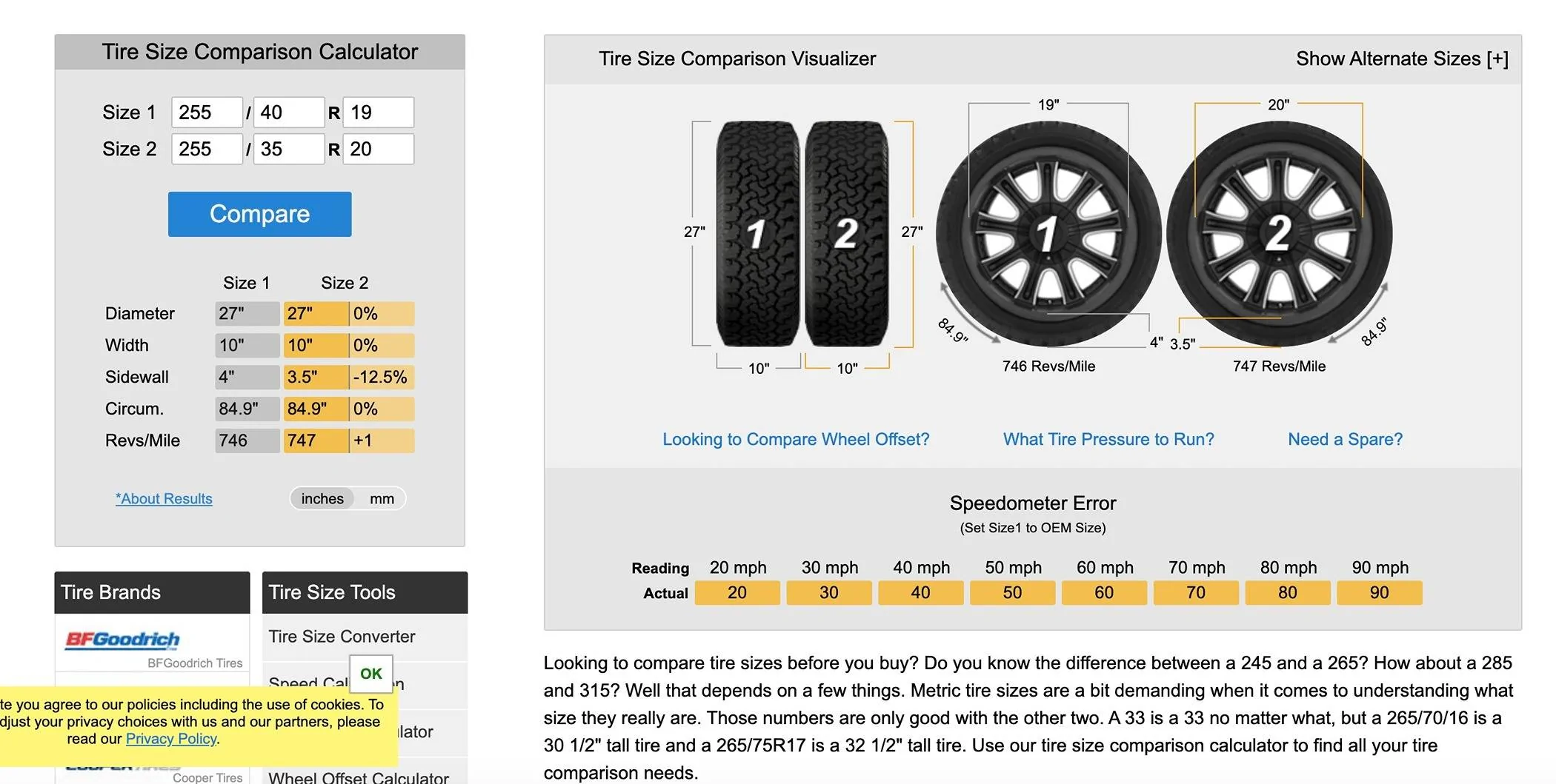

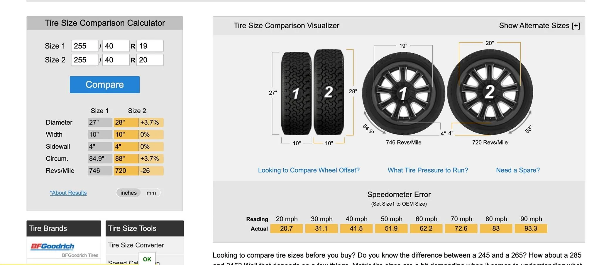

@gridzor I did two different additional calculations, both for the front.
In the first, I did a comparison of a 255/40/19 and 255/35/20. The difference in circumference is 0%.
In the second, I did a comparison of a 255/40/19 and a 255/40/20. The difference in circumference is 3.7%.
