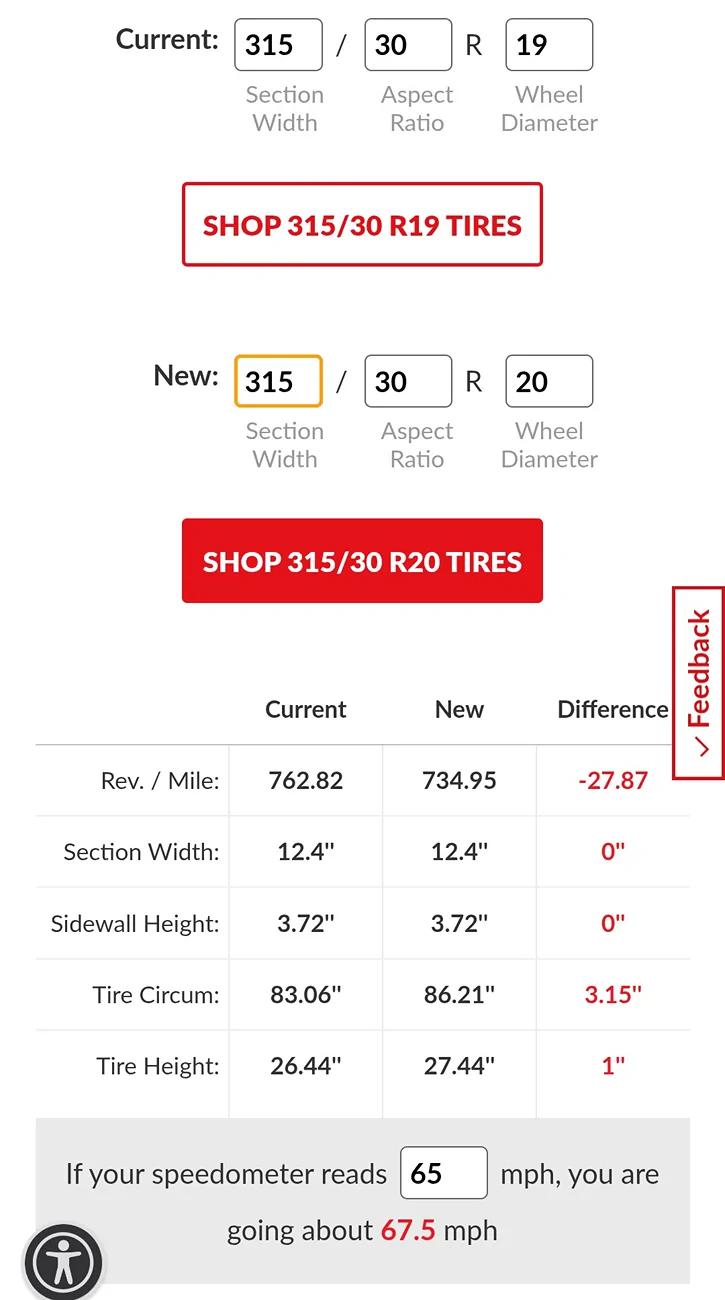

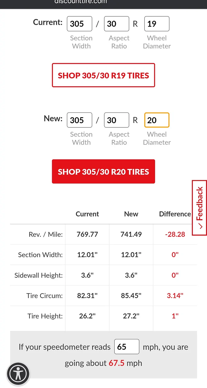

Hi Something to consider, My Mach had 20s when I purchased , Original Owner put them on (sold the stock wheels) and then didn't like the look , he told me . You will have a 1" difference in height (Diameter) will effect speedo and gear ratio, MO I wouldn't go 20s for that and also looked like a Donk ( not that there is anything wrong with that look just not my style ) your car is not geared for 20s . The GT500 can make up the difference with 280 more HP and different Trans and Rear ratio. Happy Hunting for a Wheel / Tire Combo

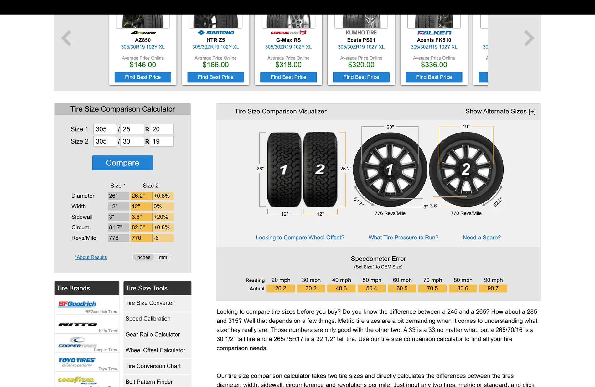

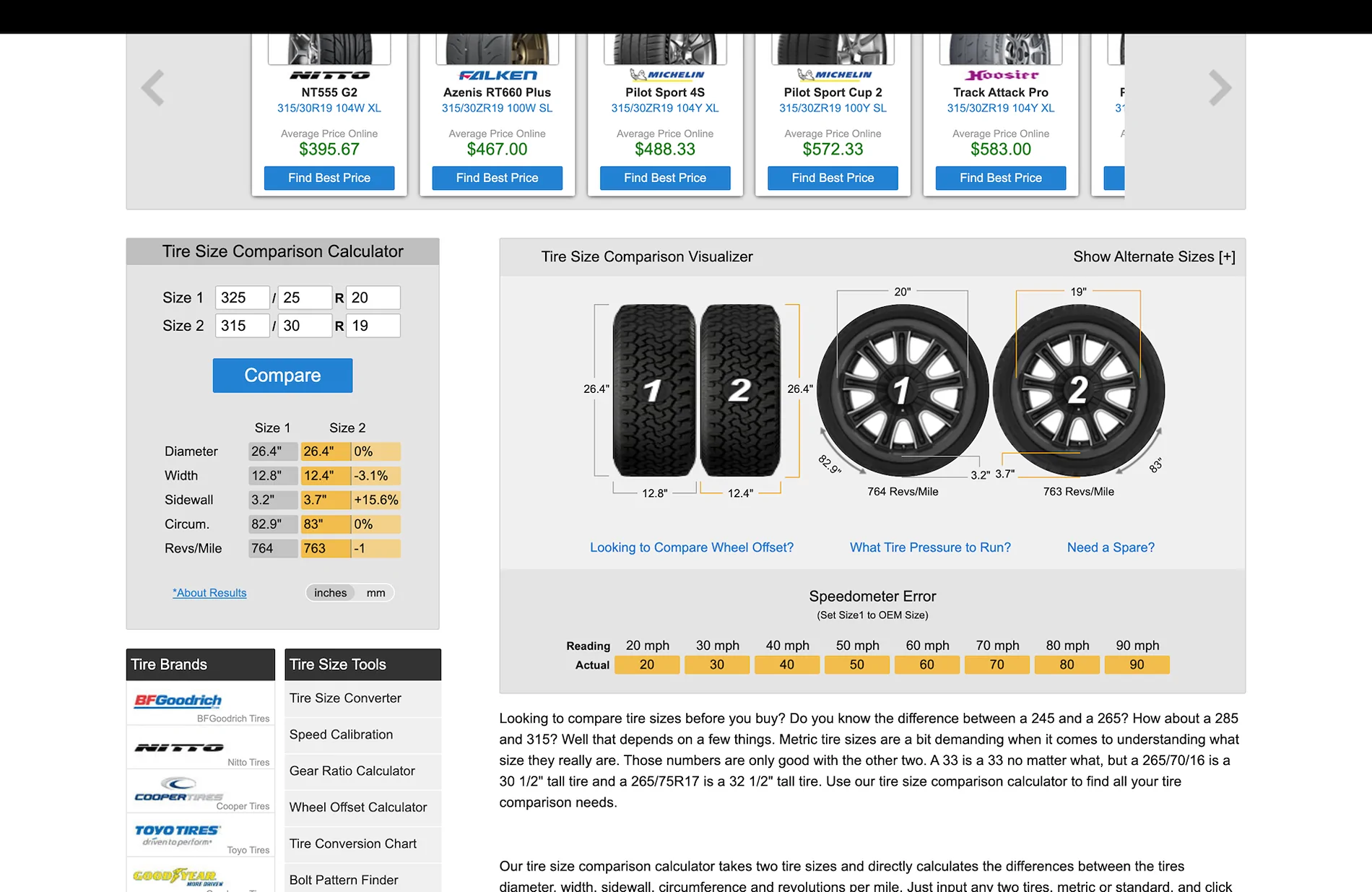

The second will give you tire circumference differences in percentages. I try to stay within +/- 3% of the original tire. Straying further can affect shift points, ABS systems or produce noticeable differences in RPM at a given speed.
https://tiresize.com/
https://tiresize.com/comparison/
Nothing wrong with a 27.x" tall tire
26.x" (especially the closer you get to 26.0") are too small IMO
305/25R20 is not the right size, you would want a 305/30R20
All's good , but I said or suggested nothing about a 305/25-20 and I didn't mention anything was wrong with a 27 , OP has a Mach1 HP which came with the 26.2 and 26.44 Dia . Tires stock and as long as he doesn't care about his gearing and ratio the taller 20 s will effect his car, all is good. 20s will take him 1 dia taller than what his car was designed to have . His speedo can be adjusted.
