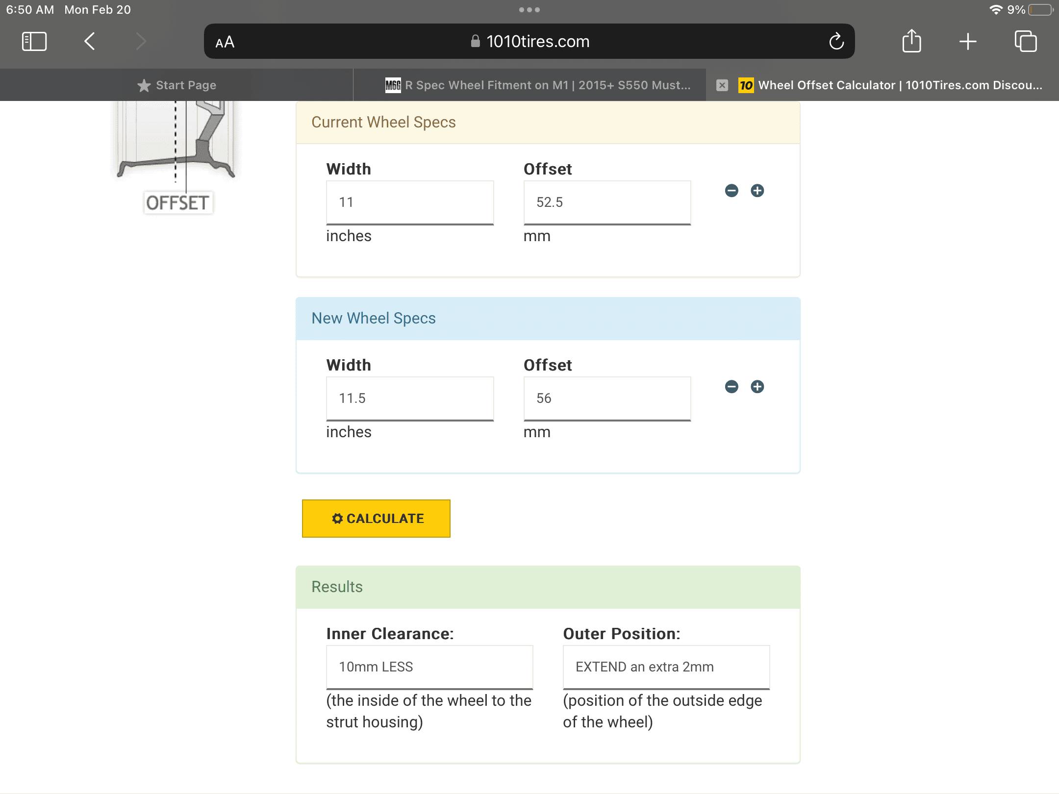

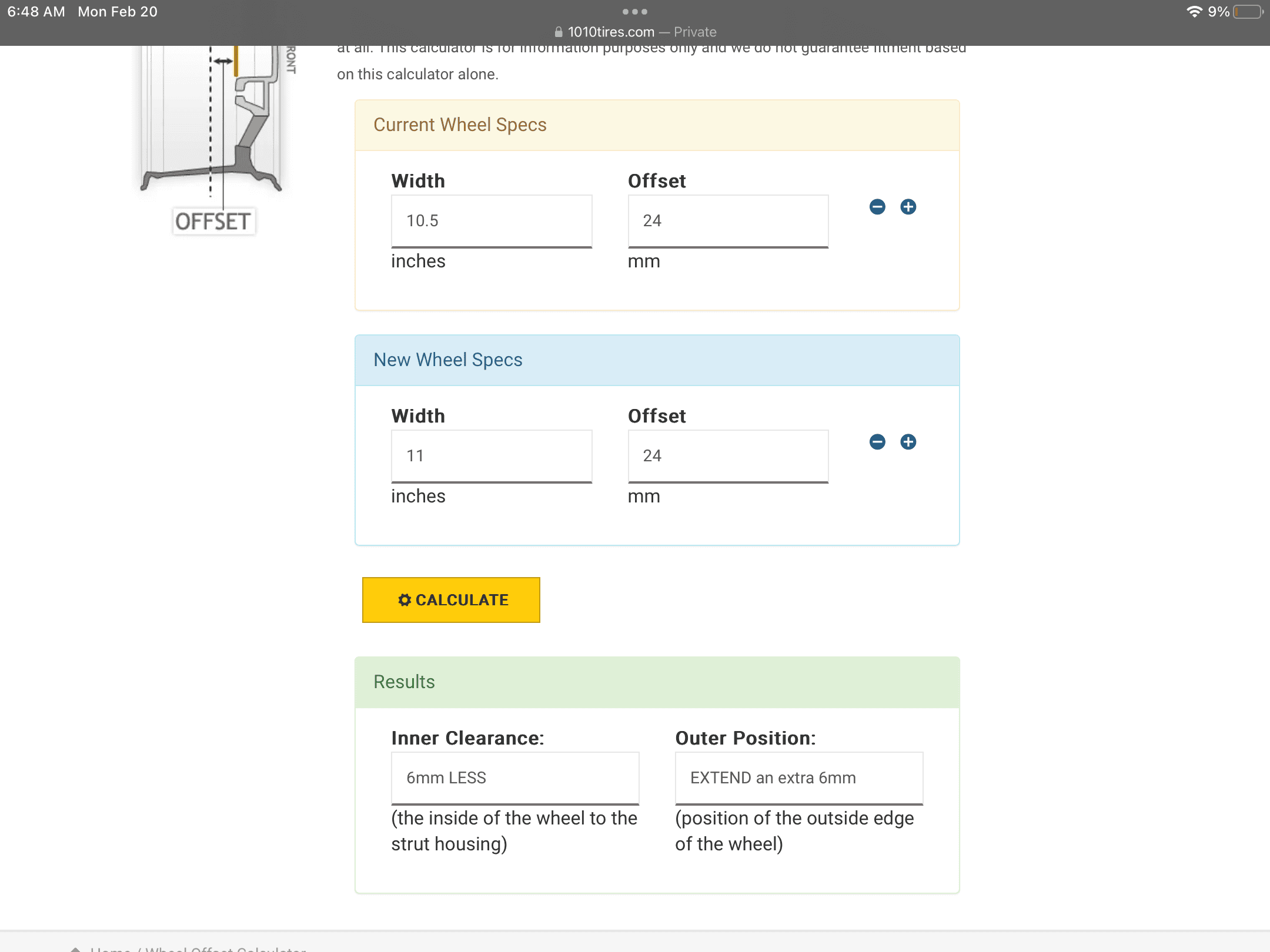

Actually, that information is incorrect. Stock Mach1 HP rear wheel offset is 52.5mm rear. Plus they won’t “poke” as mentioned. Here’s some screenshots from the wheel calculator website.
You are correct. I was wrong. I didn't realize that, while the overall width had increased, I should have split that amount in half when considering the inside and outside. And confirmed the offsets at the same time.
No problem, just wanted to have good info posted so others go down the right info highway.
