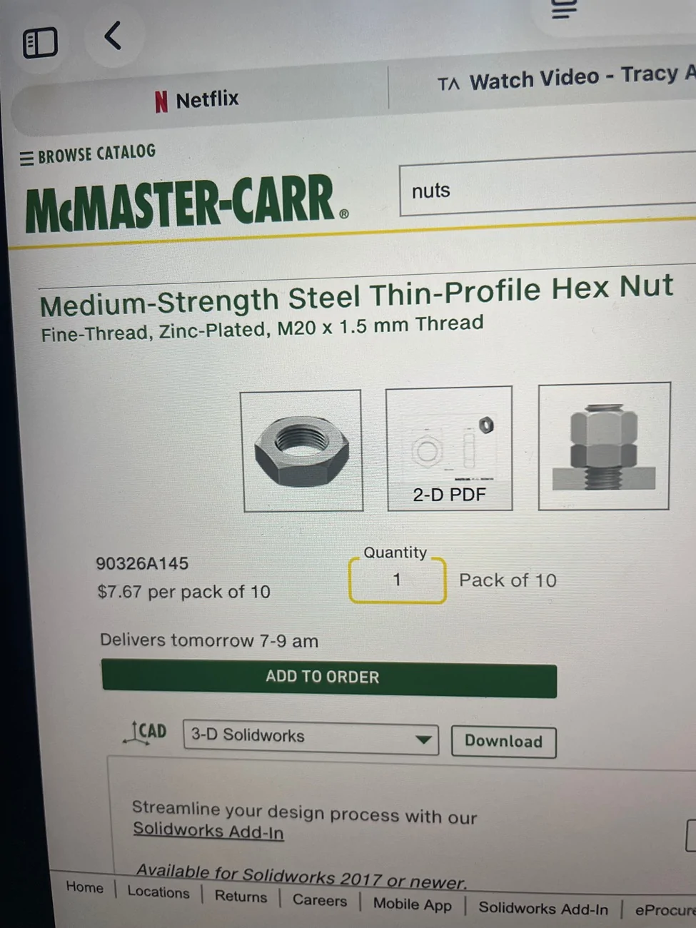

Hey Walt
They are metric
20x1.5
Thickness: 10mm
If you can’t find them in Europe, I have some extra that I could mail you
Thanks luc that is very kind of you. Customs might still charge me 30$ to do the paperwork even if it's a "gift" so I'll have to look into it.
I read somewhere else that it's M22x1.5 but maybe that is for the front? I'm gonna check the hardware store first if they have these of quality steel. I found some earlier but they were meant for indoor use.
