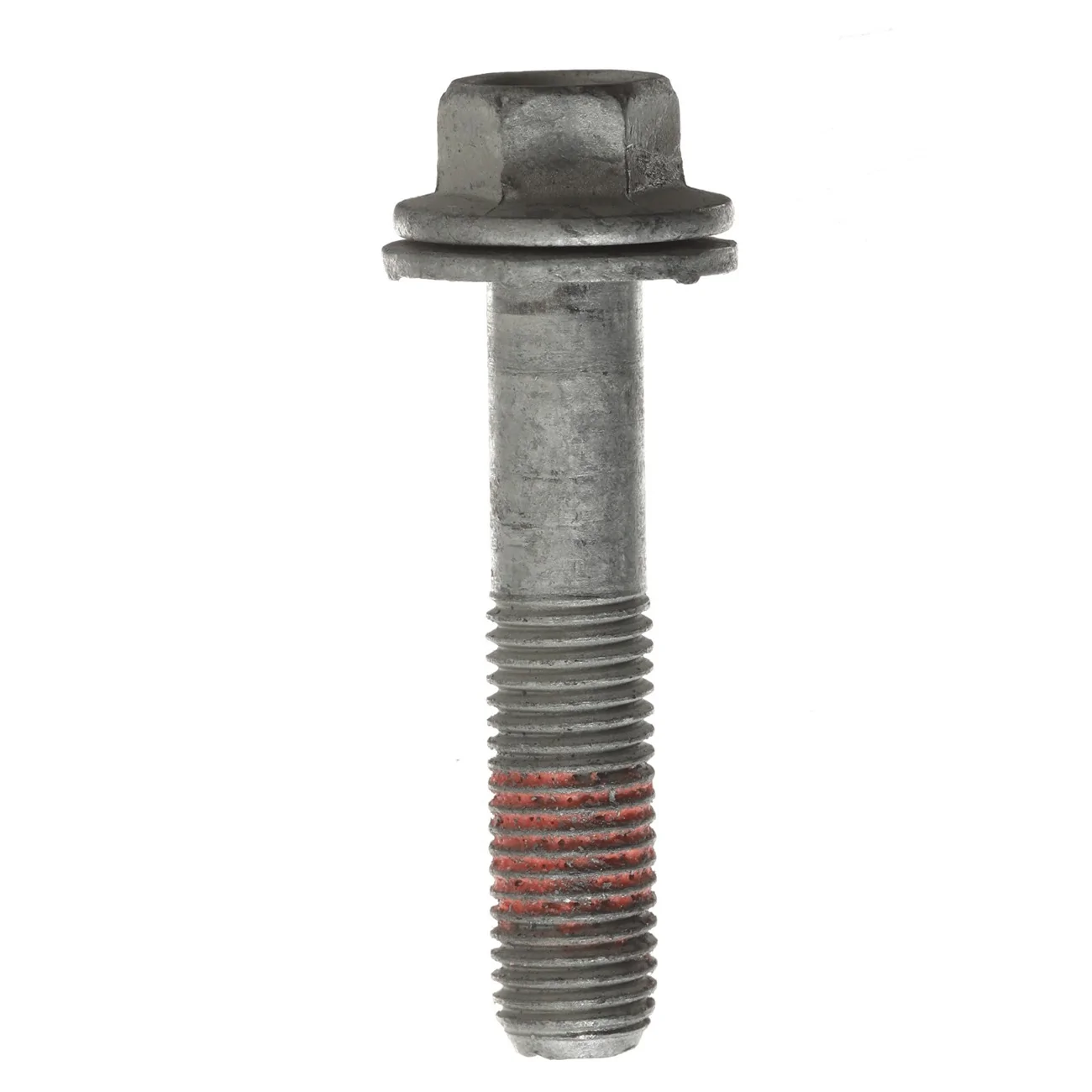

I'm replacing a rear wheel hub and the stock bolts that come out don't have any kind of threadlocker applied.
The replacement bolts from Ford do have red threadlocker applied on those same bolts. I'm wondering if I should use those, won't it make it super hard to remove next time?
Since the wheel bearings are prone to fail especially when tracking, I know I'm due to replacing them again anyway.
Part number W718188S439

1, buy timkin ones they aren't nearly as prone to failure as OEM which fail due to a design defect from my research
2, red locktite really isn't what people make it out to be. It's pretty damn easy to remove without heat. Adding heat makes it come out like a normal bolt.

You mean it will just loosen using a regular breaker bar? I thought that you will strip/snap bolts without applying heat to red locktite

Unless someone was into your car previously, those bolts would have had thread compound on them. For replacement hubs, buy anything but Timken hubs. Ford or BCA/NTN or NSK. The hubs are not defective, they due not get pre-loaded properly or the preload falls off due to fastener torque and they 'fail'

Ford reddish thread locker is not the same than the regular red that you can buy
It’s more akin to the blue
As long that the axle nut stay torqued, you will have no issue with the hub
