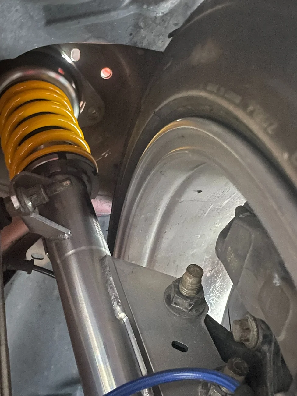

Little update on this thread. I ended up going with Ohlins R/T with 28mm spacer and safe to say I've got loads of room. Will probably try some camber adjustment from the spindle.
