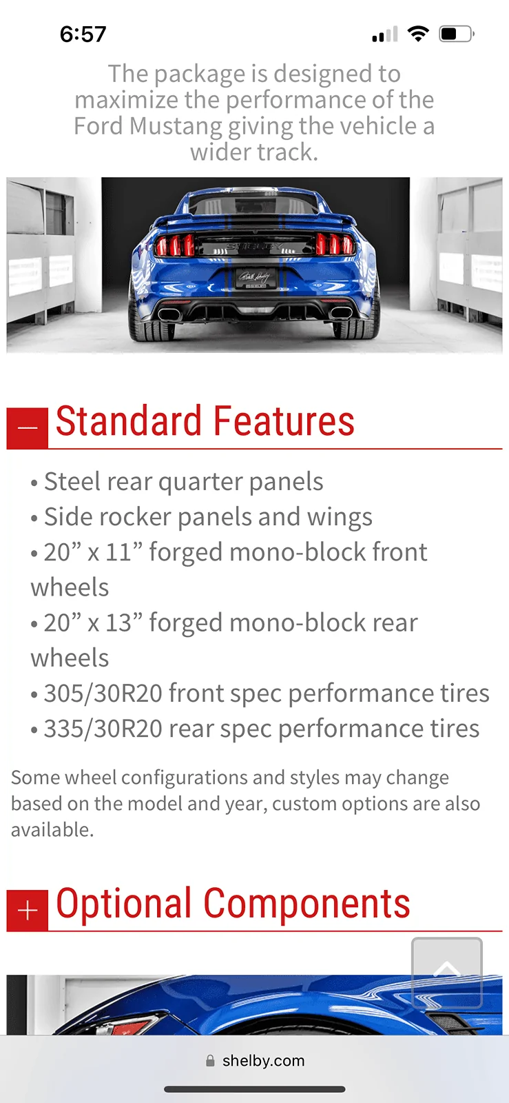

Here’s what Shelby uses for their widebody conversions. I don’t know the offsets, there’s a few guys in the Shelby threads that have had it done. Maybe @Jmeo can share the offsets on his SE Widebody?
Unfortunately I cannot help. My wide body is 2" more than stock (per side). That, and it's more than just offset, there is wheel width and back spacing that need to be factored. Also, my wheels do not have a lip, which makes my offset even further away than what the OP is looking for.
This plan is just to Frankenstein to compare to anyone else, me thinks. The wide body will have to be installed, and then backspacing and offset measurements will need to be measured in order for the fitment to work.
Thanks Jaime. Yeah it’s an apples and oranges comparison for sure but figured it might give OP a place to start. But I agree, he’d be best served to mock up the widebody kit first and get measurements.
