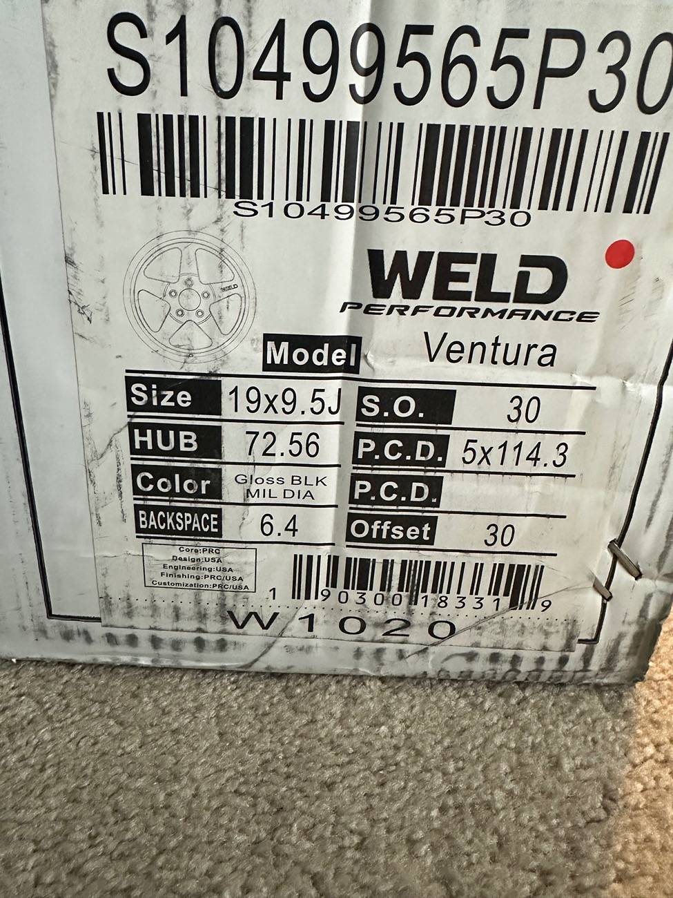

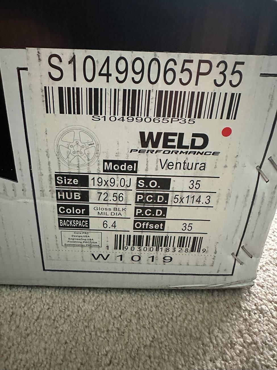

Hi guys I just bought a set of Weld Wheels I don’t know much about the fitment side of things so I gave all the information of the car to the sales person helping me at weld. I’m trying to make sure these will fit before I mount them
2019 Mustang gt on Eibach Sportline lowering springs
the wheels specs came as
Fronts - 19x9 35 Offset 6.4 backspace
on a 255/40/19 tire
Rear - 19x9.5 30 offset 6.4 backspace
On a 275/40/19 tire

The offsets are fine. Normally the offsets in the rear are actually higher but it'll be fine. The only issue is you will need hub centric rings. You need rings that reduce from 72.56 to 70.3 so that your wheels are properly centered.

Hi thanks for helping! Would these be the right ones? I’m have trouble finding that size atm https://www.summitracing.com/parts/gor-sr7270f

Those are the ones.
Hi thanks again for the help! I found an Aluminum set of them, But are you sure it’s 70.3? Google says it’s 70.5 while LMR is saying 70.3 just want to make sure I’m buying the right thing since I’m not really knowledgeable about this.

I think that may be a mistake on AI's part. I'm pretty sure it's 70.3.
