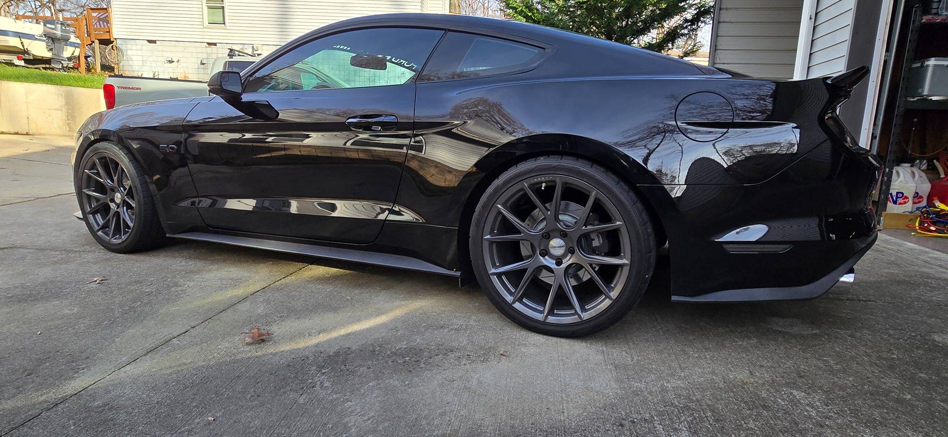

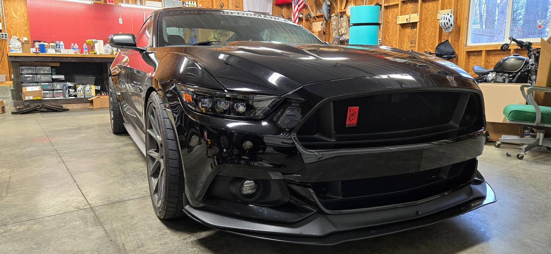

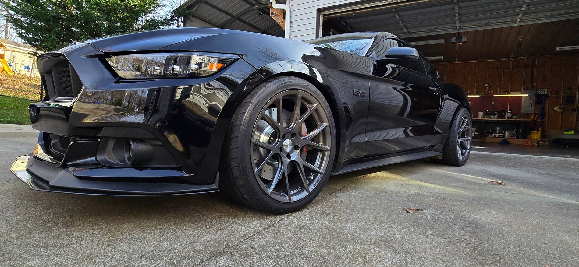

I have a 2015 GT that's lowered on Eibach Pro Kit with Vossen VFS-6 wheels.
20x9.5 +25 on the front with 275 tire.
20x10.5 +45 on the rear with 305 tire.
Stance is perfect imo. No rubbing. No spacers. Hope that helps.
