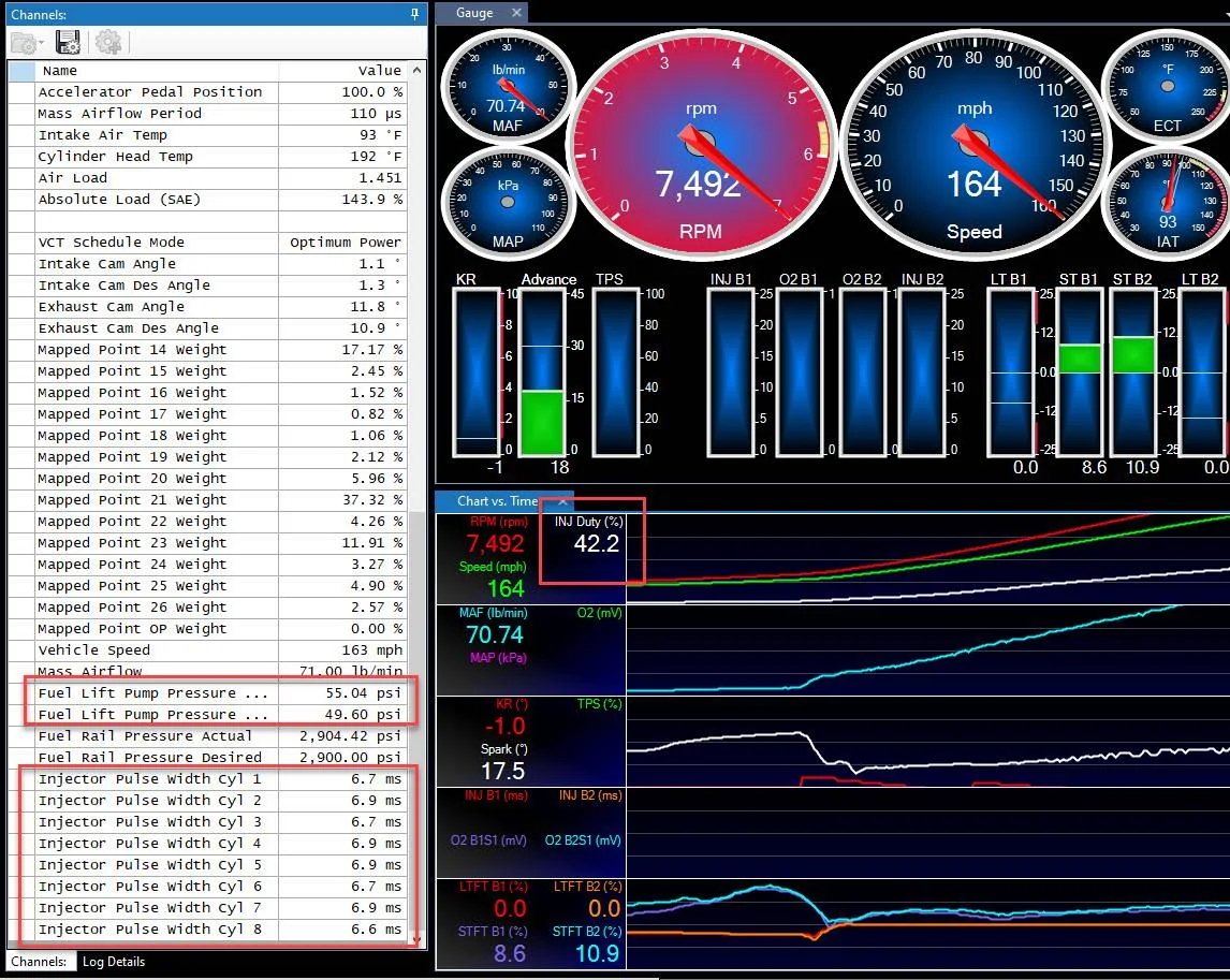

Also curious what WHP my setup will support. Gen 3 coyote, Whipple, FIC1000 injectors, Fore return system with dual 267 pumps on E85. Made 761hp on a 3.85inch pulley
Believe this is the data needed? First lift pump pressure listed is actual, desired below it. Injectorspulse width and duty percentage is on here as well

For reasons we don’t understand, the gen3 won’t allow more than about 11.8 ms port pulsewidth at 7500 rpm even though 100% duty cycle should be 16 ms. That said, 7 ms is only using about 60% of what’s available. Assuming gdi is carrying half your fuel load, you have about 20% more fuel available overall. That said, I doubt your gdi system is being fully utilized so that could also give you some more capacity.

Thanks for the reply. Any recommendations on which size smaller pulley to try and keep it relatively safe? Lol
Would like to capture another data log on a smaller pulley. The 3.85inch I have currently is giving me about 10-11psi on my mechanical boost gauge.

@Btfresse if the 20% overhead is accurate it means you could drop all the way to the 3.25, but I would sneak up on it and make sure the fuel pressure holds up.
That said, I’m running the 3.25 pulley with only a single dw400 pump and 55# injectors….

267s have a blow off at 80 psi, factoring in higher boost levels and the pressure drop in the system it's fairly easy to get to 80 psi at the pump. They really shouldn't be used in these cars with moderate boost levels so keep that in mind. The 274 has a much higher blow off psi.

The PCM won't allow more than about 11.8 at 7500, so you're getting close but there's still a little room.
