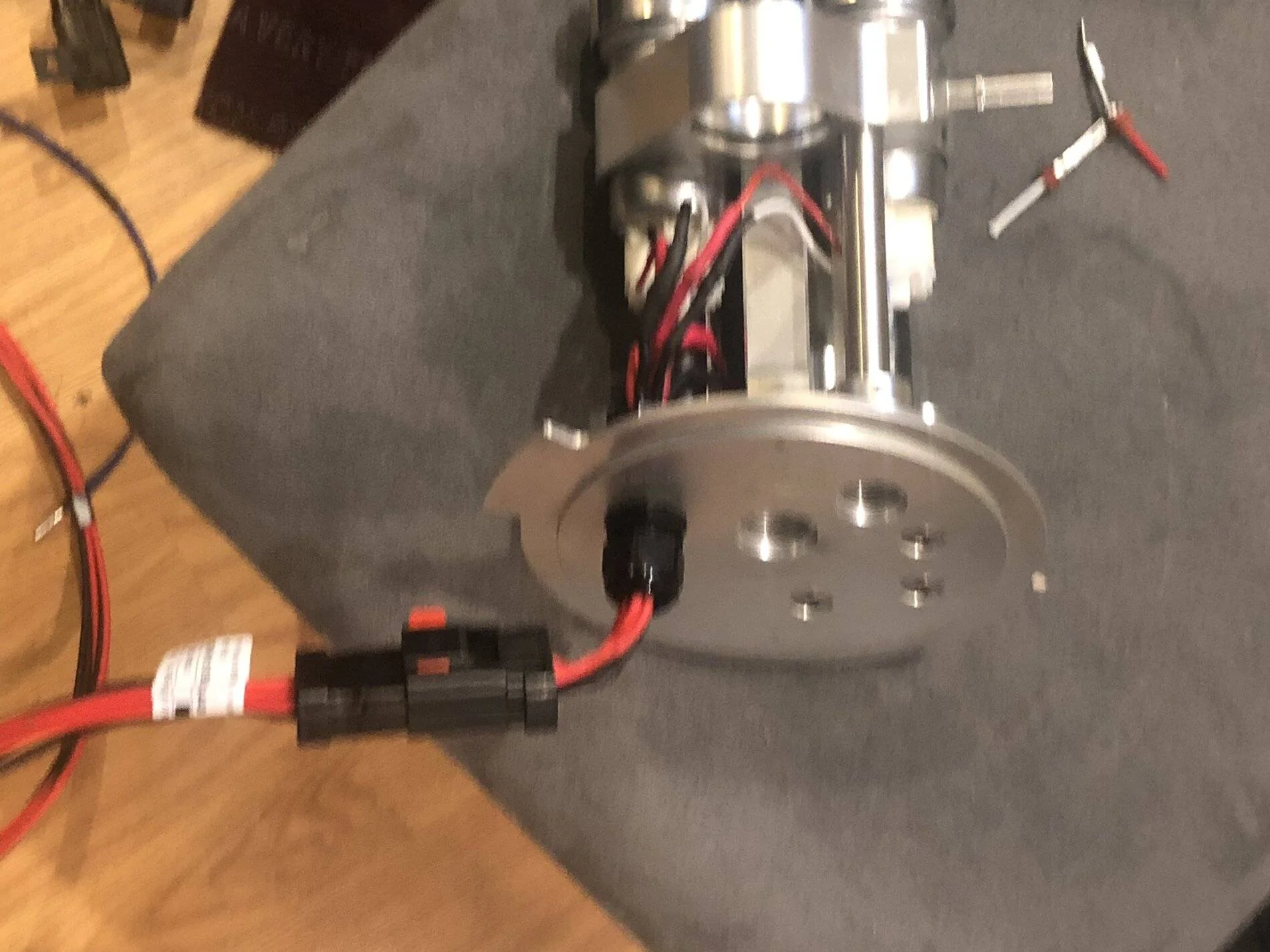

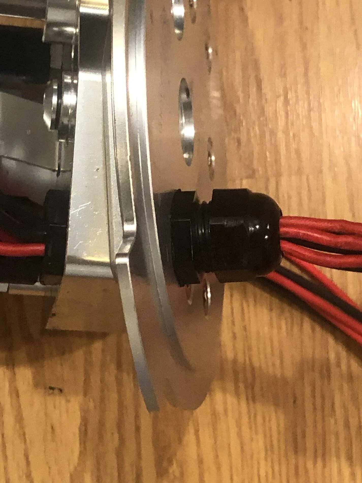

I used the on3 hat. Holds 3 pumps and only has one line out and one return

I have a Lethal Performance triple hat. It is unused it's bit of overkill for me so I didn't use it.
I would use the walbro 274 pumps ( they are cheap, and and just a bit lower lph than the 285 pumps but run much cooler) with three running you wouldn't even need a bap.
If you want I could sell it to you. PM me if interested it has all the pump pigtails installed as well.
