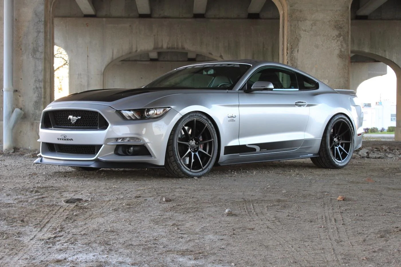

Here is our SC Q750 with our progressive springs - Wildcat & others have some great feedback with them:
Let me know if I can help with your decision - you will be happy over stock, any route you go!
