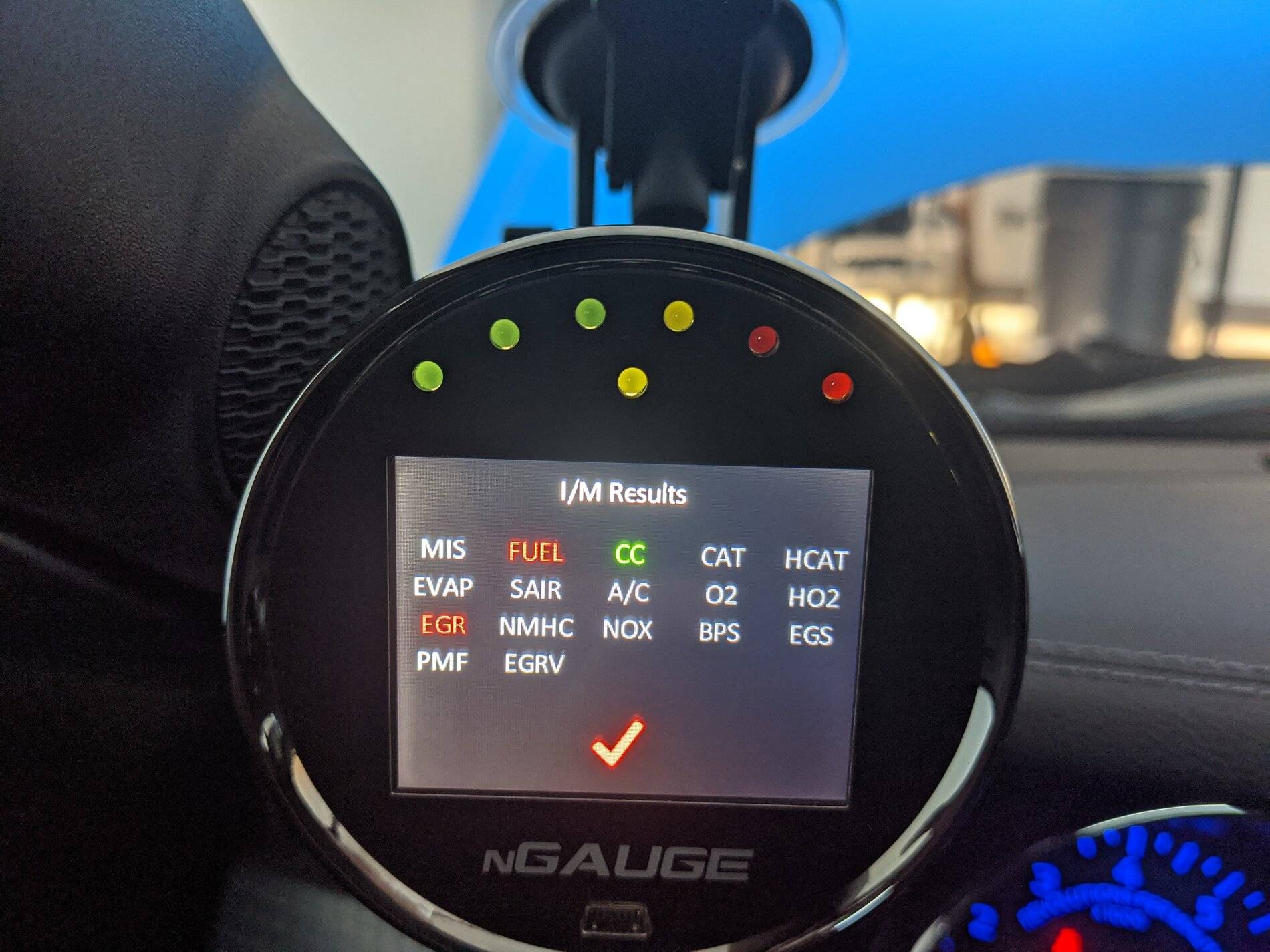

You pass like this. This is right after a reflash. EGR goes green pretty fast. I am installing an On3 single kit soon.
Do you pass emissions like that because in California you would have failed for a modified ecu

Yep, once EGR is green and Fuel stays red, I can pass here in Texas. Fuel takes a while depending on what fuel level you're at.

The only issue right after a flash is that typically it will take a number of drive cycles and miles for the computer to report an emissions ready state. Otherwise the car will throw a P1000 (system not ready) code when the emissions folks go to scan it and you fail.
But generally speaking, leave all the emissions monitors on, no check engine light, cats working well and you'll pass.
Even with my monitors all turned on and long tube headers, my HO2 and O2 never go ready. Catted, catless, spacers, no spacers. I never throw any codes ever. They just never go ready so I can't pass that way.
