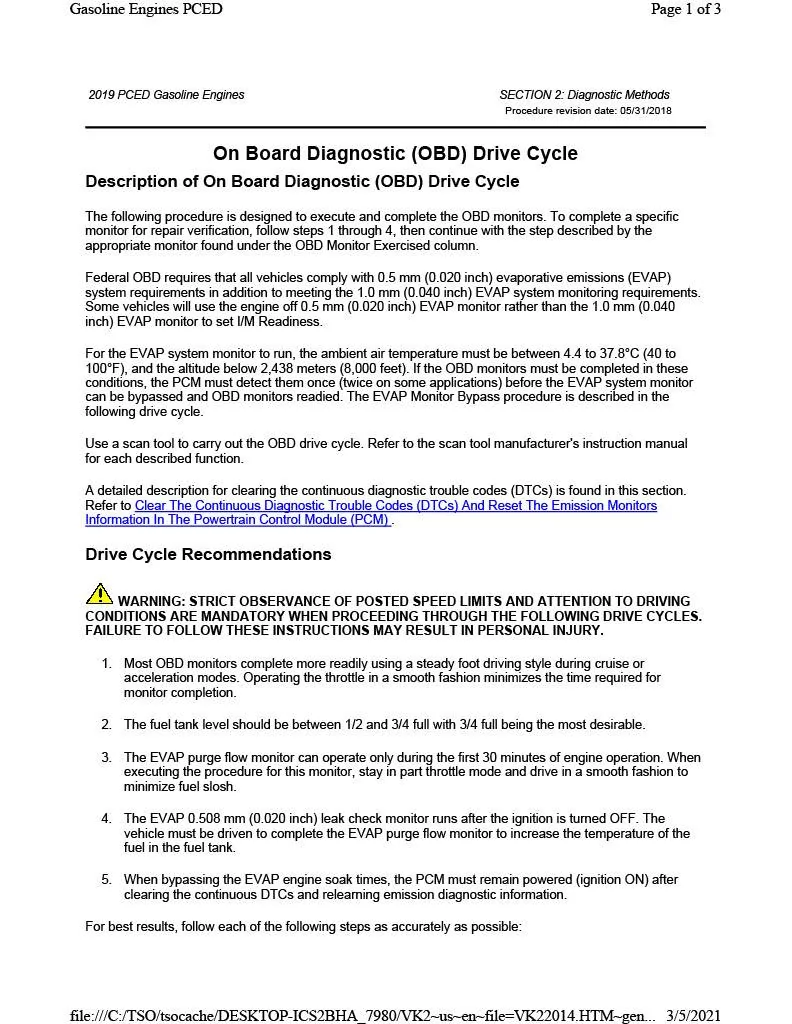

Just ran into this in Austin, TX today. I have a Stage 1 Whipple with the Whipple tune (no other performance mods), but had 3 sensors "not ready", so it failed. I have not driven the car enough according to the shop, so I'm heading to Temple to watch my son's baseball game, then doing a test-n-tune at Little River Dragway afterward :). Hopefully, that will be enough for the sensors to "wake up" and be ready for a re-test (~150 miles all told).

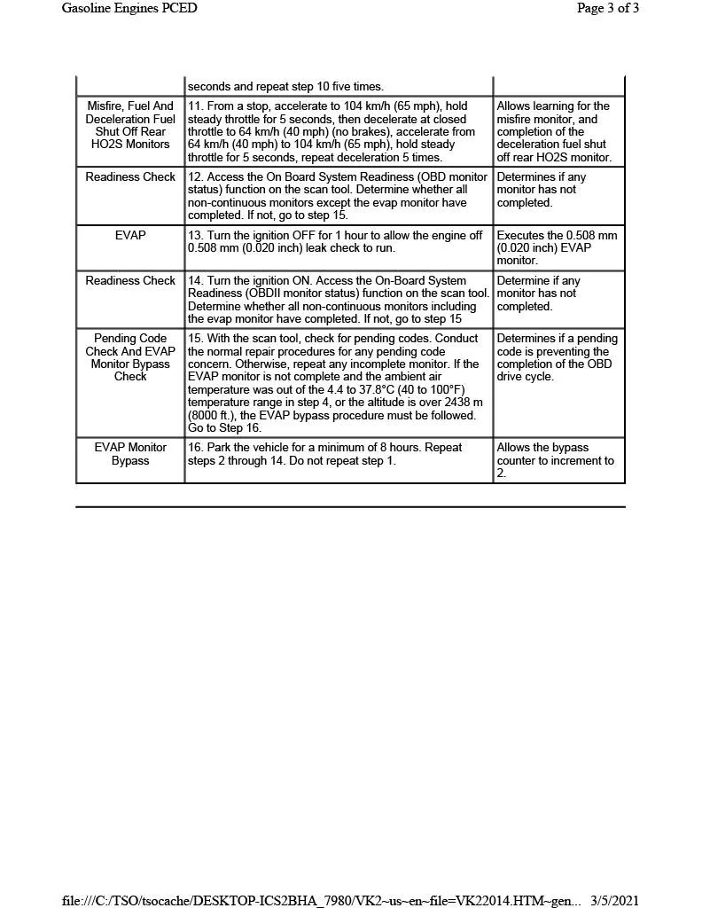

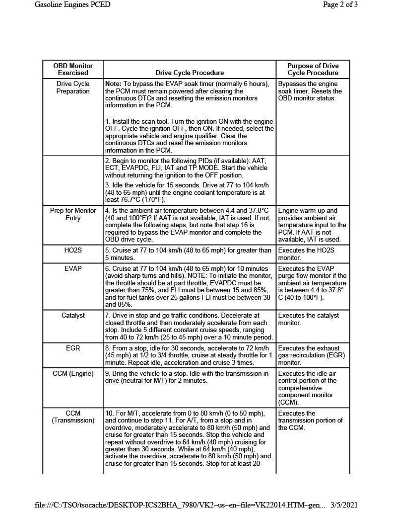

Sometimes it takes more than a couple of hundred miles to get the monitors ready. It took almost 400 miles to get my wifes car ready for a smog check.
This is the drive cycle from the factory service manual.

Got it, I had forgotten that was out there. Thanks for posting!
