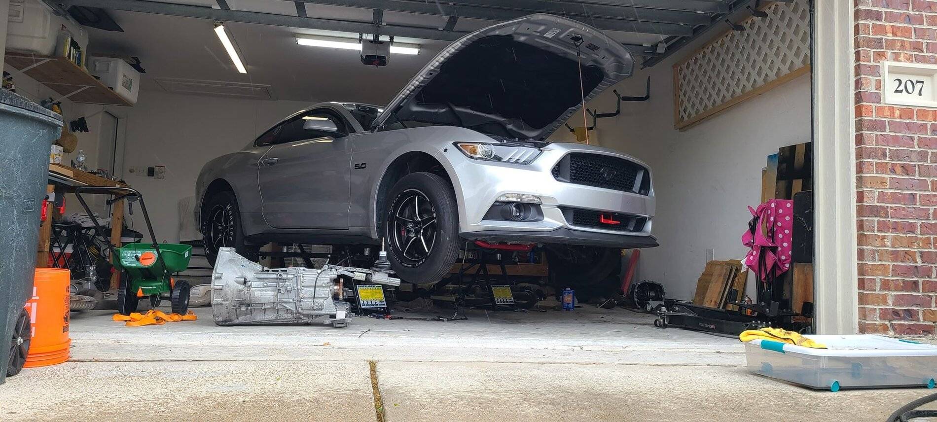

:crazy: I do that everytime I go to the track.....and it always ends up with the car coming apart 😅
current situation from my visit 2 weeks ago...

How high is your car off the ground? I am curious as to how much height is required to pull the tranny? It looks like it will be pretty tight. Trying to plan ahead for when I have to visit this type of maintenance.

aprox 20" in this picture, I couldn't get the car supported to add the extra 4" spacers for the full 24". Trans if 17ish inches I believe....had to take if off the trans jack and pull it out to easily clear.

I see. Is this a one man job or did you enlist help to do the r&r?

Yeah ones you’ve done it 3 or 4 times you can get it out in like 2-3 hours by yourself (ask me how I know)😎
