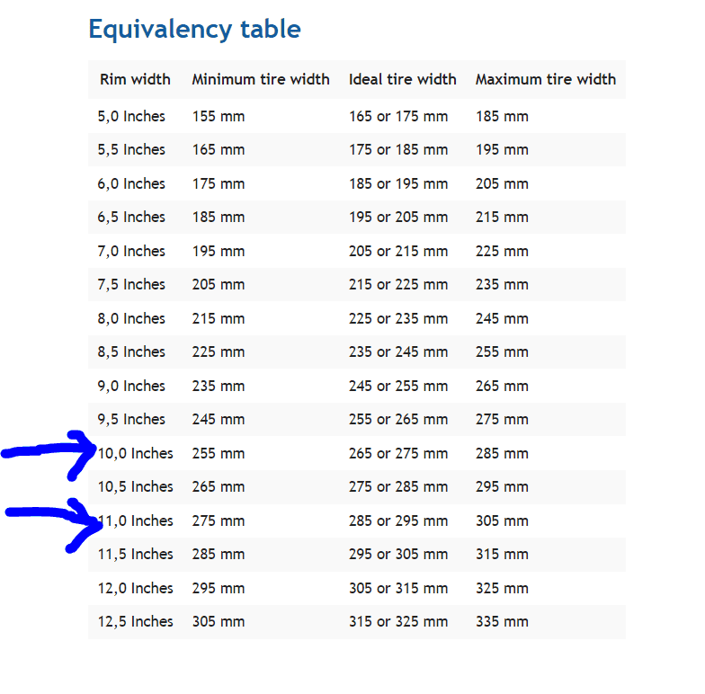

Should be fine but might bulge a tad.
The M1 comes with 19X11 rear wheel and 315/30/19. Its a perfect fit and ride imo.
Here is a table for tire widths. It is recommended to go 305 max on a 11'' but Ford goes with a 315.
👀 Looks like that extra inch does matter. 🤣
Wheels on my Mach 1 are 19Ă—10.5 F and 19Ă—11 R running 305s and 315s respectively.
