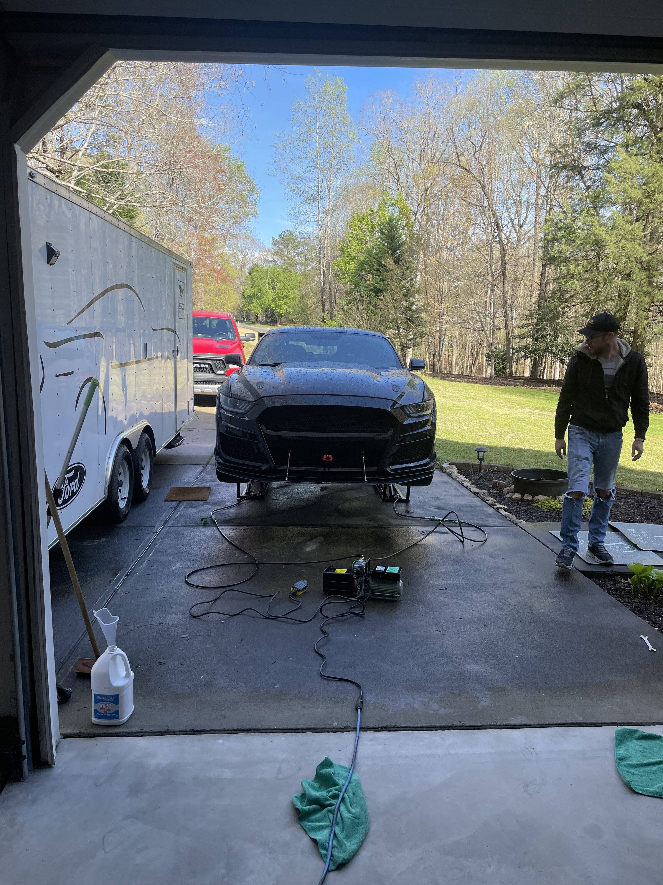

I’m glad you liked my idea and it worked for you. I feel so much safer under my car when it’s up on my wheel cribs.I found this thread and got the idea from there:
https://www.mustang6g.com/forums/threads/diy-wheel-cribbing.173104/
I cut the 2x4's into 16" lengths and built the boxes 3 layers high (so they're 4.5" tall). I built 12 boxes total to give me options for height. I added a couple of extra 2x4's to 4 of the boxes to serve as the tops to give the tires a little extra surface area to rest on. All in all, pretty easy project. And I feel MUCH safer with these instead of jack stands with ramps under the wheels.
Absolutely! Feel much safer with the cribbing vs jack stands. Thank you for sharing the information and giving us the idea!I’m glad you liked my idea and it worked for you. I feel so much safer under my car when it’s up on my wheel cribs.
